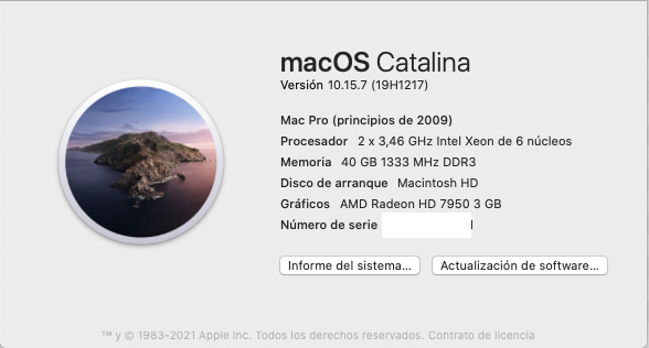

I am a bit out of the loop. So I installed on my MP 5,1 Catalina 10.15.5 some time ago using @dosdude1 patcher (thanks). What is the easiest way now to bump it to the latest Catalina version 10.15.7 ? Is it via dosdude1 patcher again or via OTA by installing CatalinaOTAswufix.app (if that is even possible this way) ?
Reactions: K two
