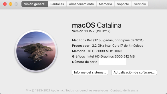

I have updated to 19H1217 without problems.
Reactions: K two

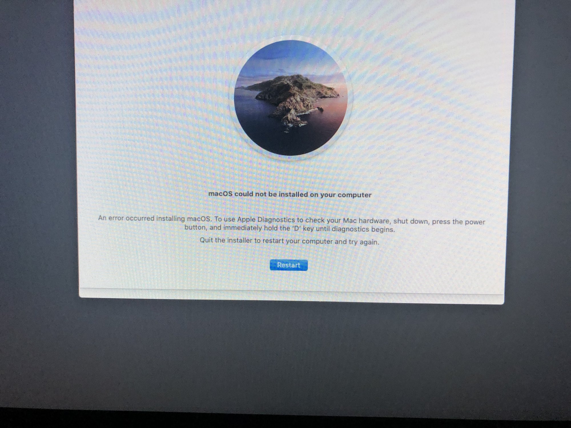

Help, could someone point me in the right direction? I’m trying to install macOS Catalina on a iMac, 10,1 that was running High Sierra before. I get this message during install after 23 minutes remaining. When I boot it goes into the install loop. The drive is APFS but after three attempts I get the same message. I used the patch from @dosdude1
