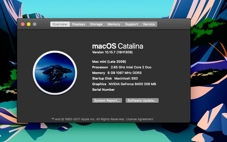

After installing Catalina on my Mac Mini Server mid-2011 (MacMini5,3) and running the post-install patching (with rebuilding of caches) I'm only getting Safari 14.1.1 in the list of available updates. None of the supplemental updates, or the security updates, show up. Consequently the installation is stuck on vanilla 10.15.7 (19H2). Any advice?
Run CatalinaOTAswufix and the Sec. updates show up.
I just updated my MBP4,1 to 19H1309 (Sec. Upd. -004)
