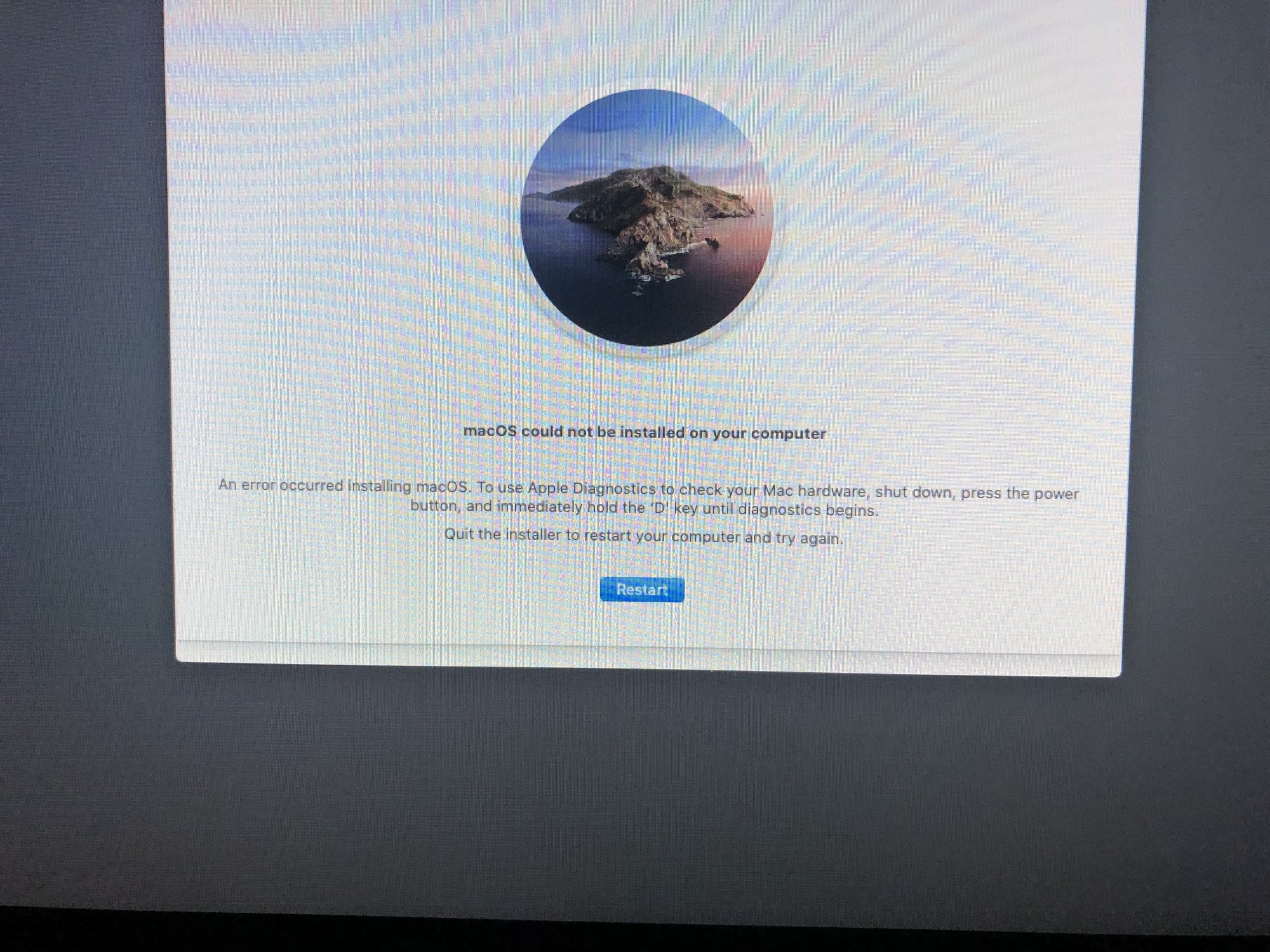

Help, could someone point me in the right direction? I’m trying to install macOS Catalina on a iMac, 10,1 that was running High Sierra before. I get this message during install after 23 minutes remaining. When I boot it goes into the install loop. The drive is APFS but after three attempts I get the same message. I used the patch from @dosdude1
Try disabling SIP and then try the install again.

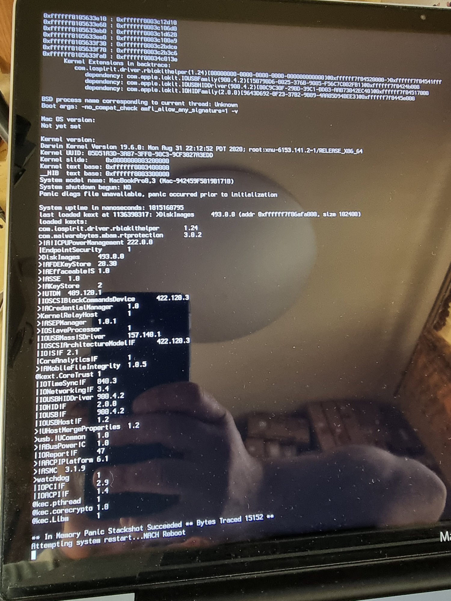

MacBook Pro 17" 2011 GPU disabled with Tiresias GPUkiller, installed high sierra latest
forgot to save a backup
installed catalina with patcher from @dosdude
  • Current Version: 1.4.4
all seems to be good. after installing i got a window with an offer for 3 updates (postinstall)
I did it and after installing i am in a boot loop now. in Verbose mode got this:
For testing I made a clone with carbon copy cloner
the cloned SSD I pluged in to a 2015 MacBook, same problem
now installed big sur on the patched catalina disk
after that it starts normaly all ok, backed it up with time machine
now i have a new ssd, installed high sierra latest and again on the 17" 2011 installed the @dosdude patcher
again after installation i got the offe with the 3 updates, this time it worked. have a running catalina now on the 17" 2011 macbook pro
I installed high sierra fresh and tried to migrate from the big sur installion, running on the 2015 macbook, but no chance, got message, the source is using a newr installation ...
the problem is it is i want to have the data back into the catalina installation
i have
- new SSD with patched catalina from @dosdude working good on this 17" macbook pro 2011
- the "old" ssd with working high sierra and all data, patched with @dosdude pcatalina patcher, now in bootloop,
picture above
- other ssd with big sur installion and full working with all data, of course not working on the 17" machine
- from the working big sur installation saved time machine backup
Please help me.

Did you run the patcher again after installing the updates? You must run the Post-Install patches after every system update. Even if you ran them, run them again (even multiple times), and try checking the Force Cache Rebuild option as well.
yes, thats good idea. i created a bootable stick and installed all "over" the existing data and tata all is ok.
but coing again the update window, after installing this and restart it hangs again.
so i installed again all over the "old" without installing the "libary validation disable..." i have no problems.
the intresting is on a fresh deletet ssd fresh installed all is ok including all the updates.
so the problem is when installing the update "libary validation disable..." on the "old data and then restart

that dont work.
so i will install all on the "old" data without the libary validation patch.
no other idea, this can be a problem isnt it?

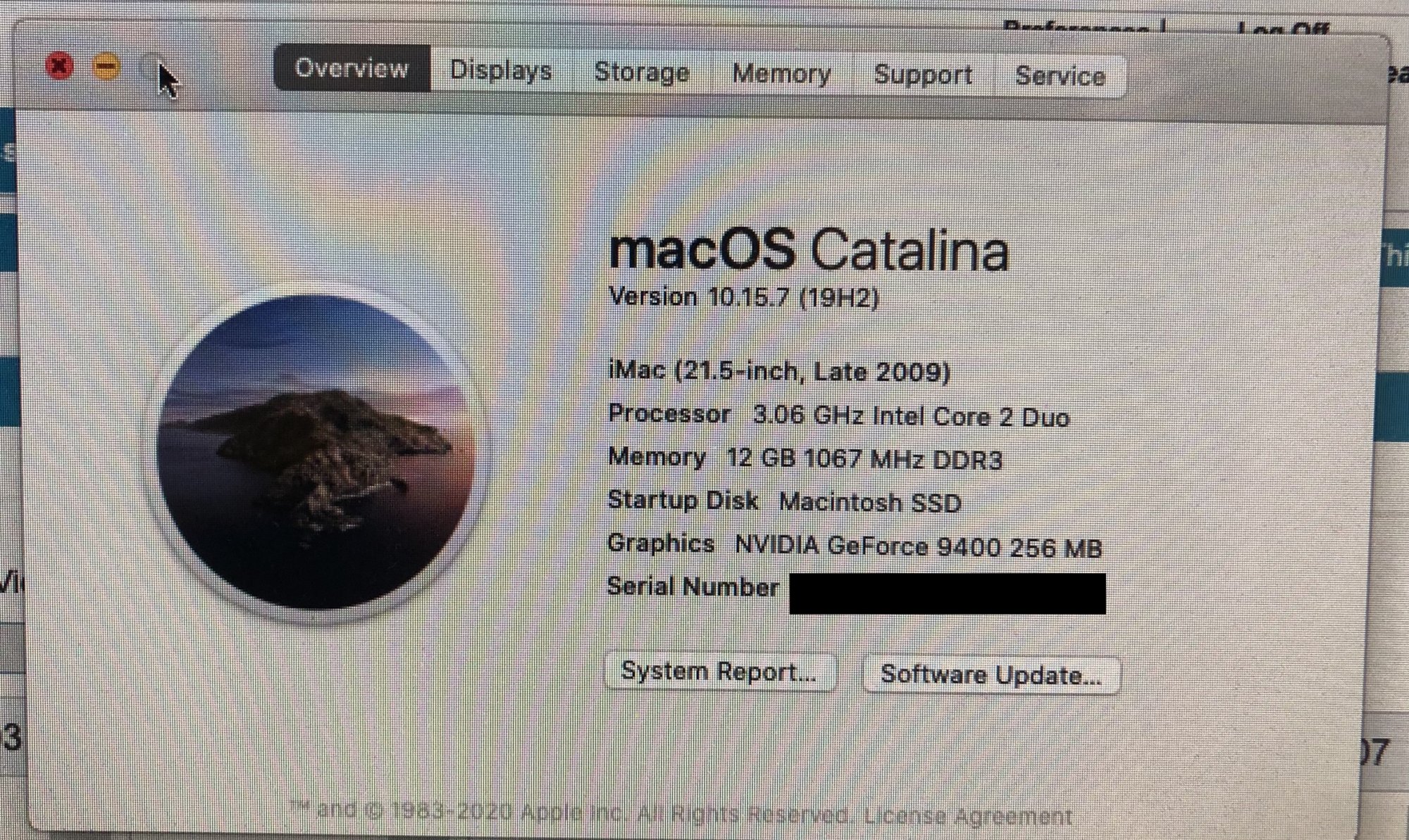

Thanks for getting back to me. It’s build 19H2. Let me know if you need anything more.
Attached is a photo as well.
From the Patch Updater in the Utilities ƒ, update the Patches. Each individual or all of the patches can be updated from there. Always Force Cache Rebuild if offered. Also, Build 19H15 is the latest full release with Security Updates 19H1217. FWIW

From the sound of it, I think the problem is you are installing Catalina when we are asking you to install the Post-Install Patches. Once you “install” Catalina from the usb drive, and then “install” the updates that are presented in the software update preference pane, you need to boot to your USB patcher drive, but do NOT choose install macOS Catalina, choose the post-install patches at the bottom of the window and click apply. Is that what you have been doing?
Thanks, I ran the Patch Updater and it said up to date. I was able to enable OTA software updates via CatalinaOTAswufix app in order to bring the machine up to date to the current build of 19H1217. Also got zoom video working via tccplus but still internet sharing doesn't seem to be working but it's not the end of the world if there is no fix for it. @K two are you running Catalina and able to use internet sharing to share wifi to other devices?
Yes via Ethernet, Pan and Firewire also avail. Currently on Build 19H1304, a Beta for SU 2021-004. There is now a new one - 19H1309, recently seeded. I had various Sharing issues w/2021-003, btw. SMB between Macs and Screen Sharing were both broken. Fixed, now. ?
