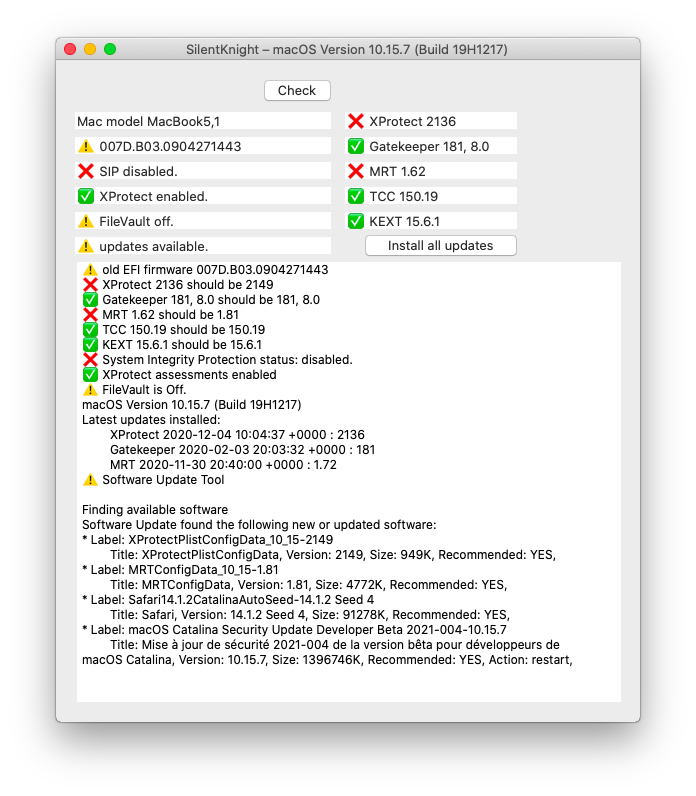

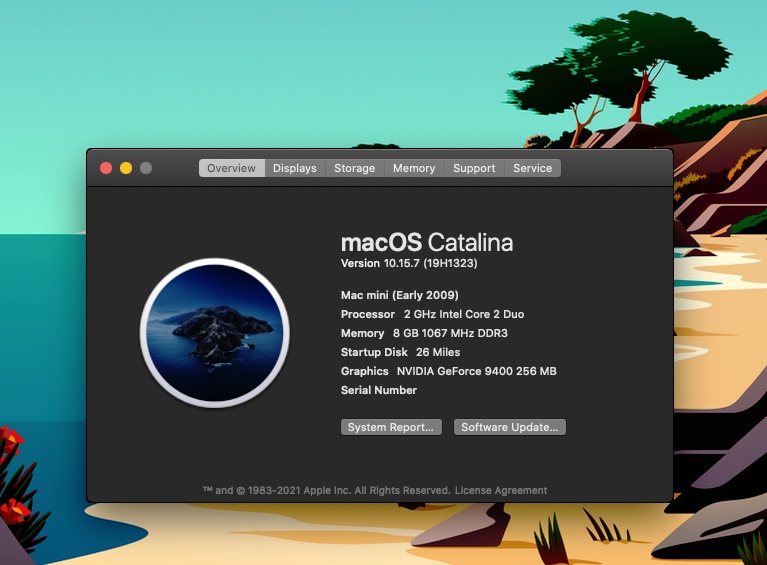

Smooth update to 19H1323 w/CatalinaOTAswufix.app, OC and Catalina Patcher v.1.4.4. Also, needed MRT updated and the Validation Patch update. Runs cool and snappy on this "primitive" old Mini. ?
K two
macrumors 68020
Dec 6, 2018
2,314
3,187
North America
Thanks. I had never used that so far.
Do you recommend to install all updates? I'm actually happy with 19H1217 so far.
Happy w/19H1217 DO NOT install ALL of the updates. Software Update CP will offer some choices, if you don't want them opt-out of Betas, the small blue text below the CP gear is the option. After opting-out, re-run SilentKnight it will offer MRT and X-Protect, only. You can update both. MRT may require two attempts. How does the cMB5,1 perform on Catalina? We have one on Mojave, see the signature, last entry. ?
