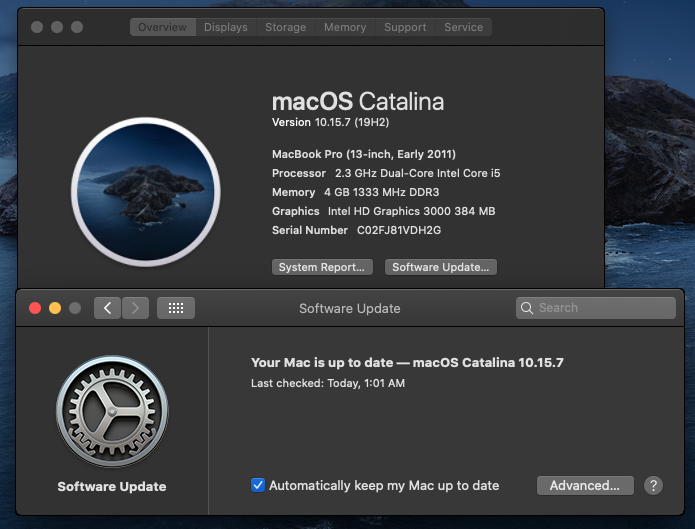

13-  Install 2 patches updates that were availiable for the MBP model

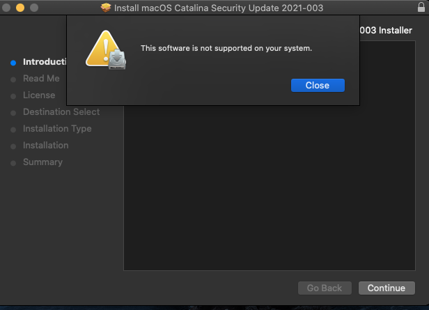

A) I can not update my MBP
B) I try to install the Security Update 2021-003 (Catalina) using a USB stick
but I does not work.
What am I doing wrong?

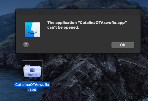

Ok . It seems you got carried away with just the first line of the post. It is not a question of offense.. There is no need to advocate. It would have been much clearer if the actual poster would have mentioned " security updates" on the subject line. You have pointed to the guide as per the link. Nothing much to add so far. Have a Nice Day

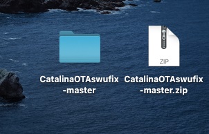

Using the guide from post:
#13,956
If I download from https://github.com/jacklukem/CatalinaOTAswufix
I get CatalinaOTAswufix-master.zip
If I Unzipped I get only a folder with the name CatalinaOTAswufix-master
If I renamed CatalinaOTAswufix-master to CatalinaOTAswufix.app and move to the desktop I have an error:
Code:
Open CatalinaOTAswufix app. (If it gives you errors, move the application to your Desktop. Make sure it's the actual application and not an alias. Delete it from your Applications folder once you move it)
Click on "Software Update Fix"
The app is on Desktop giving me an error
Where is "Software Update Fix"?
Thanks
Camelia
Reactions: Dilli

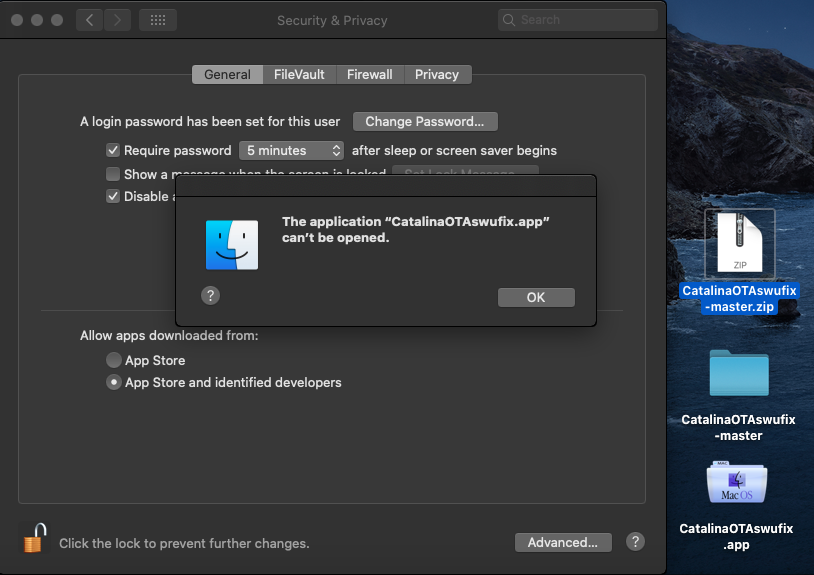

Generally, apps that you download from outside of the App Store in macOS will always?/often? need to be given special permission to be opened in [system preferences] —> [security & privacy] —> [general] tab
Nothing in security & privacy after run the renamed CatalinaOTAswufix.app asking for a permission
Reactions: Dilli
What is odd?
Trying to run a .zip file or trying to run a folder?
It should be clean, what file exactly you did not rename? or what I should do with the zip file or the folder?

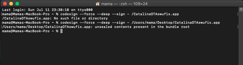

This normally happens when the certificate of the app is not allowed by Catalina.
You can use this command in terminal window
codesign --force --deep --sign - /CatalinaOTAswufix.app
After this you will be able to open the CatalinaOTAswfix.app
Still does not want to open
Code:
Last login: Sun Jul 11 23:38:10 on ttys000
mama@Mamas-MacBook-Pro ~ % codesign --force --deep --sign - /CatalinaOTAswufix.app
/CatalinaOTAswufix.app: No such file or directory
Code:
mama@Mamas-MacBook-Pro ~ % codesign --force --deep --sign - /Users/mama/Desktop/CatalinaOTAswufix.app
/Users/mama/Desktop/CatalinaOTAswufix.app: unsealed contents present in the bundle root
Thanks
Try this, copy above command in terminal and then drag the catalinaOTAswufix app in the terminal window and press enter.
Then try opening the app.

Try this: https://support.apple.com/guide/mac-help/mh40616/10.15/mac/10.15
or if still can't launch the app, this: sudo spctl --master-disable
if still can't launch the app with above methods, remove any downloaded copies of the app, then download from here: CatalinaOTAswufix.app.zip
possibly download it zipped (Safari Preferences General uncheck "Open safe files after downloading"), then try unzip it with "The Unarchiver" or "Keka" and retry to launch.

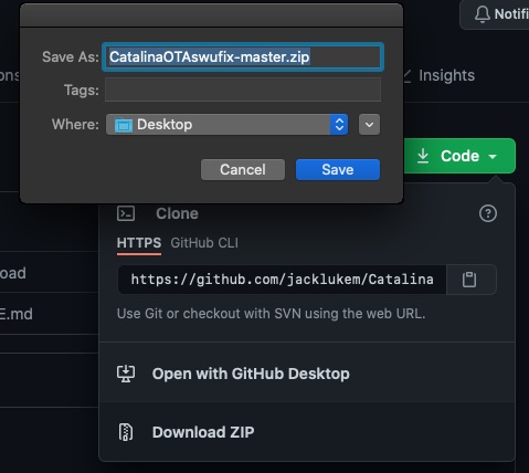

A) My first problem was to download CatalinaOTAswufix-master.zip instead of CatalinaOTAswufix.app.zip
(Checksum are different)

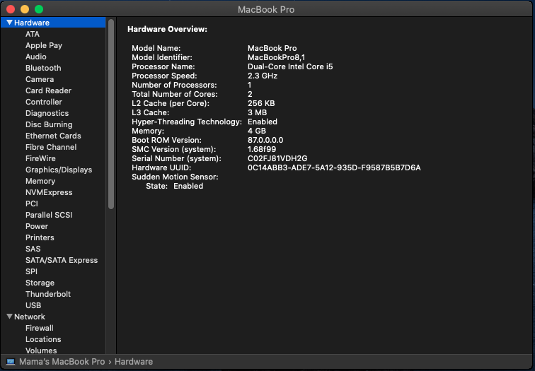

Which Mac are trying to update Catalina ?
If you already install the update reapply from dosdude1 post install patches selecting "Force cache rebuild".
Or try after power on to hold alt option key for 10 seconds, then at apple startup manager select "macOS Installer", otherwise select "Catalina"
If still doesn't work try using this USBOpenCoreAPFSloader3.app.zip as "EFI Boot" from apple startup manager targeting "macOS Installer" or "Catalina".
If none of this worked simply reinstall Catalina through dosdude1 patcher, data are kept.

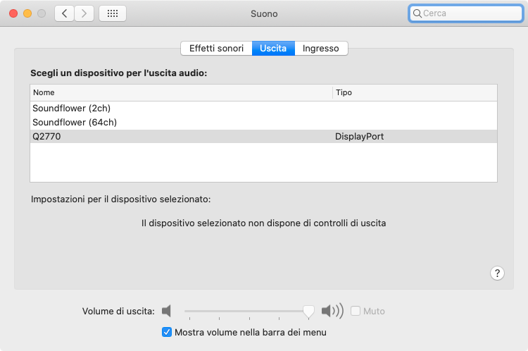

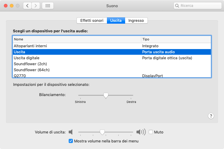

Help... some how my audio hardware support is gone after 19H524, any idea how to get my Audio back?
Did you find the trick to get sound back? I've the same issue on my MacPro 2009 after 19H1217 upgrade, until Catalina 19H15 alls seems to work right, but after upgrade through OTAswufix.app, internal audio exit disappeared. I reapplied dosdude's patches: first time without checking "Legacy Platform Compatibility Patch", second time with it, boot forcing cache rebuild and made a PRAM reset but it didn't help. Hardware is OK, because if I boot MacPro Mojave that I hold in another partition, sound works normally.
This is Mojave sound preference pane (and I'm pretty sure it was the same with Catalina 19H15):
and this is Catalina 19H11217 sound preference pane:

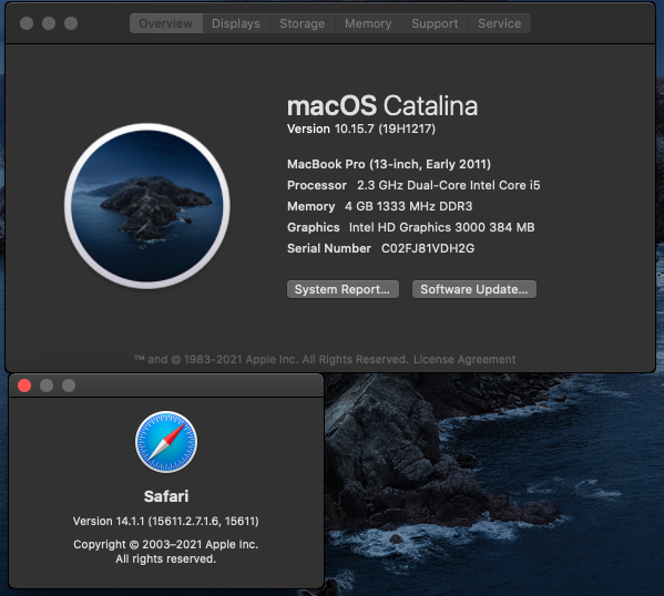

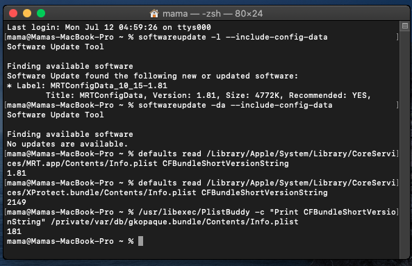

Thank you very much to all!!
Finally my macOS Catalina, Gatekeeper, Xprotect and MRT are up to date!
How do I clean my macOS of all the crashed I had because my lack of knowledge (.Logs)?
Thanks
Camelia
Code:
Last login: Mon Jul 12 04:59:26 on ttys000
mama@Mamas-MacBook-Pro ~ % softwareupdate -l --include-config-data
Software Update Tool
Finding available software
Software Update found the following new or updated software:
* Label: MRTConfigData_10_15-1.81
    Title: MRTConfigData, Version: 1.81, Size: 4772K, Recommended: YES,
mama@Mamas-MacBook-Pro ~ % softwareupdate -da --include-config-data
No updates are available.
mama@Mamas-MacBook-Pro ~ % defaults read /Library/Apple/System/Library/CoreServices/MRT.app/Contents/Info.plist CFBundleShortVersionString
1.81
mama@Mamas-MacBook-Pro ~ % defaults read /Library/Apple/System/Library/CoreServices/XProtect.bundle/Contents/Info.plist CFBundleShortVersionString
2149
mama@Mamas-MacBook-Pro ~ % /usr/libexec/PlistBuddy -c "Print CFBundleShortVersionString" /private/var/db/gkopaque.bundle/Contents/Info.plist
181

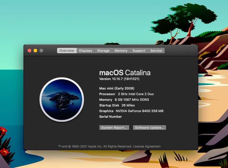

Thanks
Camelia
Code:
1.81
2149
181

Ok, but have you some suggestion how I could restore audio capacity of my MacPro?
Apply patches again and force the cache rebuild - as always. If this fails, re-install Catalina latest (your data will be kept) and apply all OTA upgrades and finally patch and force cache rebuild.
