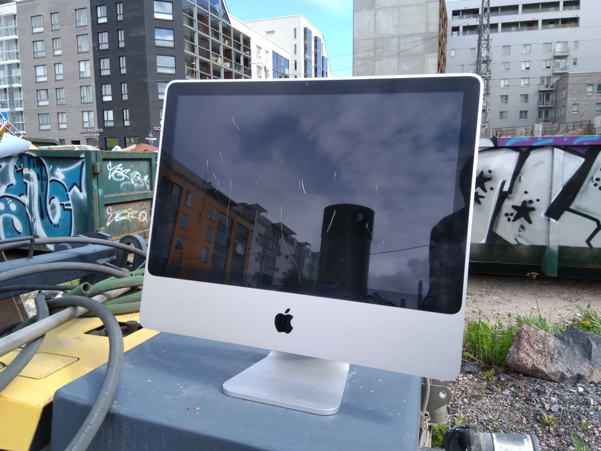

This project started when I found a 20 inch 2007 iMac in a dumpster. I added some RAM and installed El Capitan and gave it to my iPhone-loving cousin.

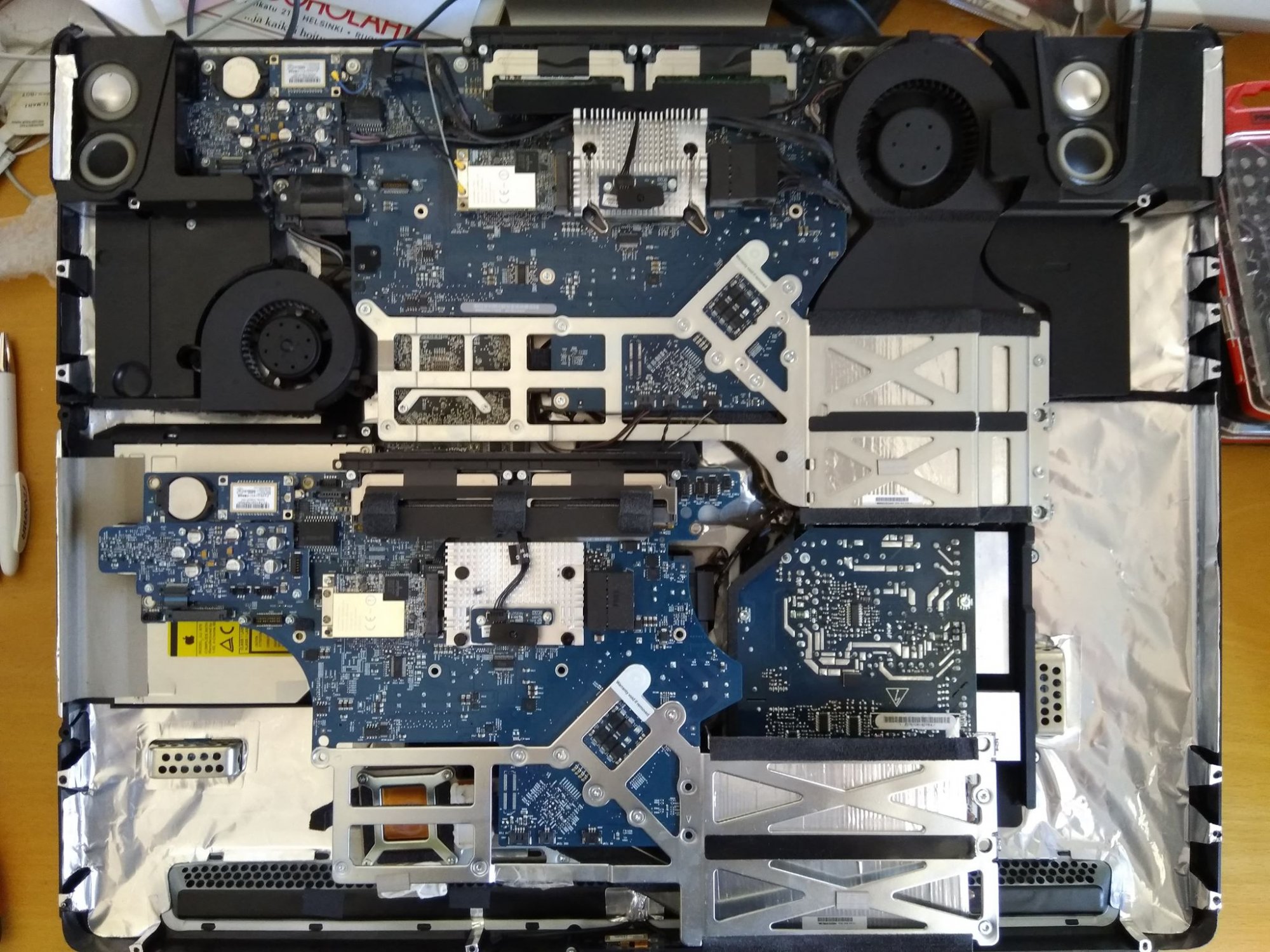

The 20 inch iMac was the top model with a 2.4 GHz CPU and a Radeon HD 2600 Pro. Unfortunately the dumpster had scratched the glass. Instead of searching for a replacement glass I bought a 24 inch iMac with a failing GPU for 30 euros. The plan was to swap the good GPU from the 20 inch iMac to the 24 inch iMac.
I first updated the firmware for APFS booting using Dosdude1's APFS ROM Patcher. I also prepared a clean install of El Capitan on an SSD on my Mac Pro. (Unfortunately I forgot to enable remote desktop.)

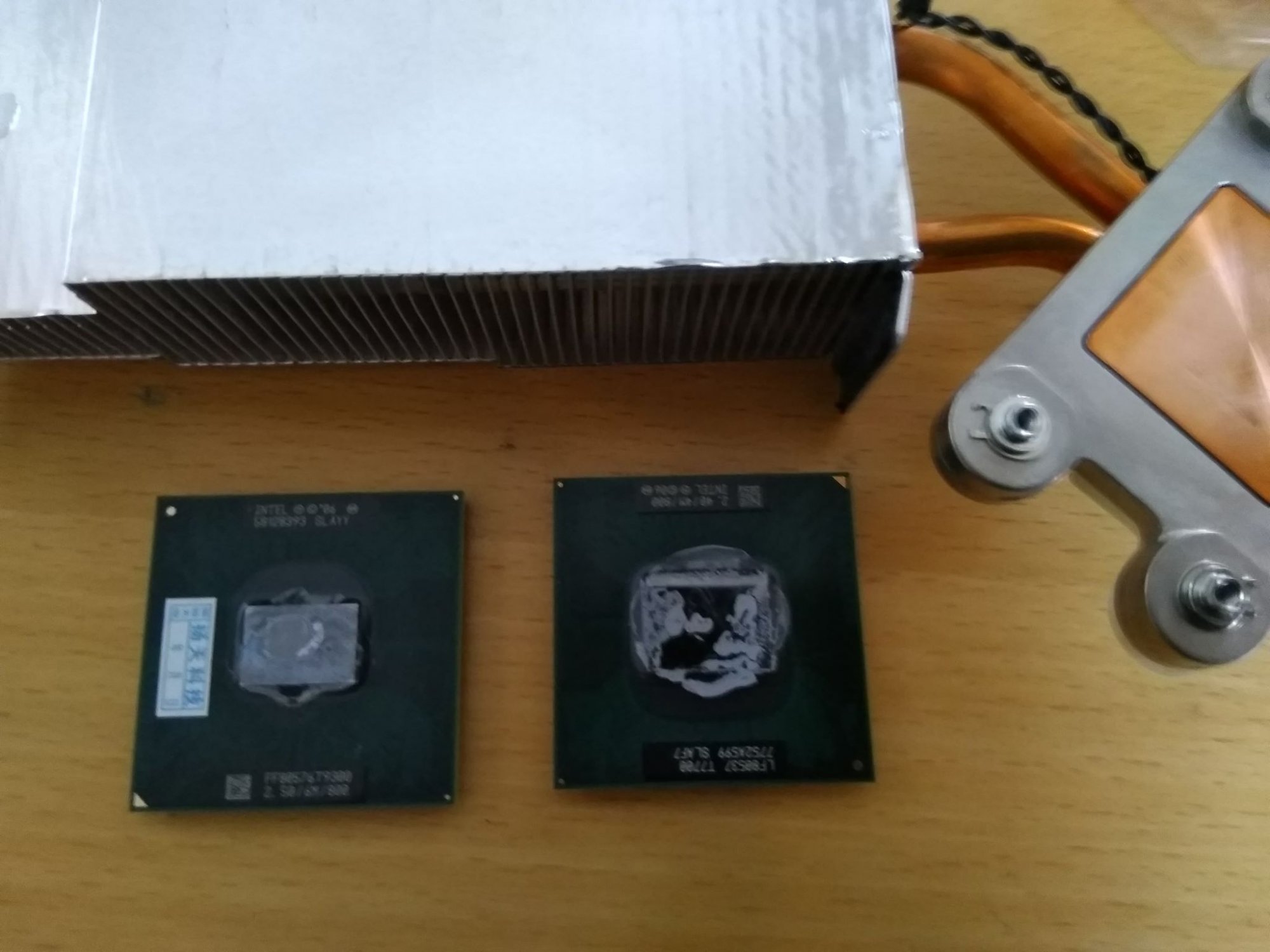

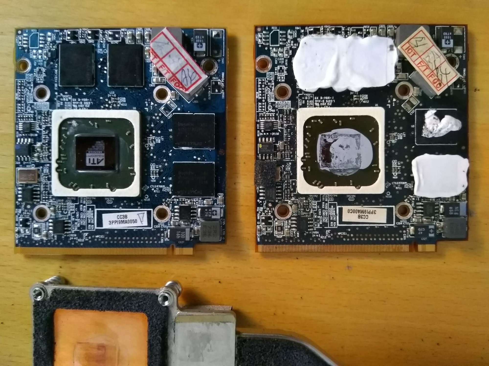

I had ordered a Core 2 Duo T9300 CPU to enable the Mac to run Catalina. I used some old Arctic Silver 3 on the CPU and the GPU. For the GPU ram I reused the white silicon paste. The GPU on the 24 inch IMac had been running much hotter than in the 20 inch iMac, deteriorating the black rubber foam and leaving sandy black dust inside the Mac.
I had considered just swapping the whole logic board, but once inside I noticed that the 24 inch logic board is larger. The only electronic difference seems to be that there are unused extra pins in the MXM connector in the 24 inch model.
I placed the 120 GB SSD in a plastic 3.5 inch adapter I had ordered from eBay for $15. I moved the thermal sensor to the new drive and used the original fasteners to attach the drive.
The most difficult part in reassembly was attaching the inverter cable to the power supply. I had to unscrew the PSU from the case to get the cable in place, then screw it back in place with one hand. Despite this I failed on the first attempt. When I restarted the iMac the display stayed black. I could hear the boot chime and all four status LEDs lit up. Unfortunately I had not enabled any form of sharing, so the Mac did not show up on my network. After some experimenting I did manage to put the Mac to sleep, so I knew the backlight was the issue. Also LEDs 3 and 4 indicated that the GPU was on and communicating with the LCD.

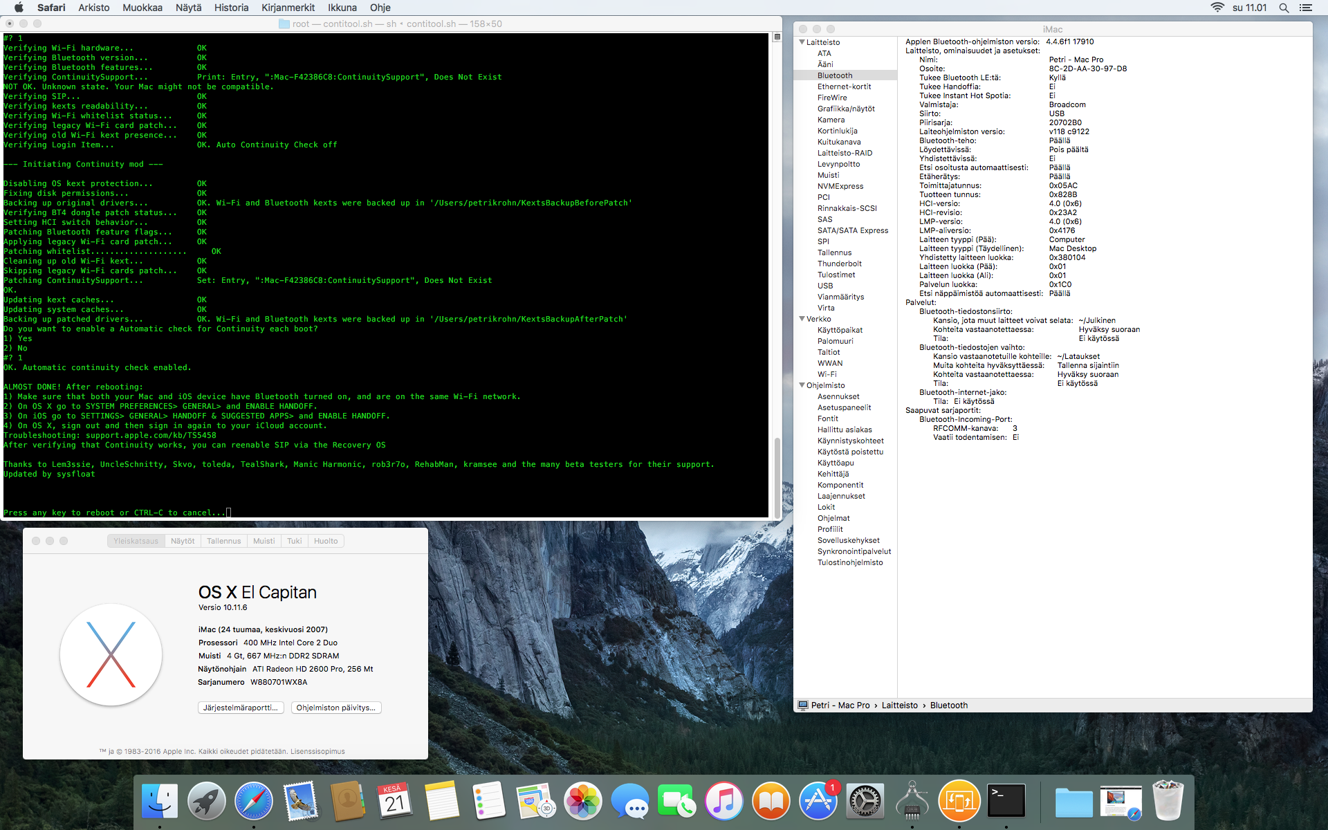

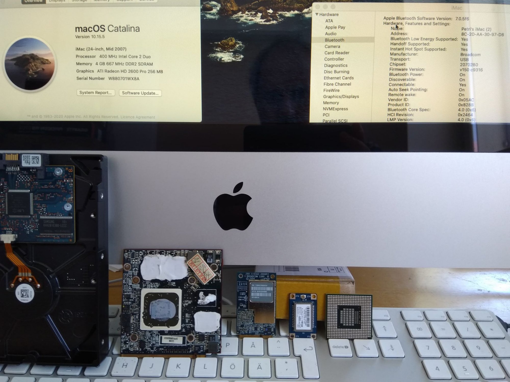

After removing and reattaching the LCD I got the iMac to boot into El Capitan. As the aluminum bezel was still missing, the WiFi and USB cards were exposed. I tried the BCM94331CD card and adapter I had ordered from AliExpress from my Mac Pro 3,1 for $13.99. Turns out the miniPCIe slot on the iMac has the needed USB connection. (For some reason the adapter in question failed to work on the Mac Pro, preventing the Mac from even booting or chiming. On the iMac it works fine.)
At first the Bluetooth function on BCM94331CD card did not show up on the System Profiler. After I removed the original BT card it showed up. I then ran Continuity Activation Tool on El Capitan to check that everything worked. I had trouble securing the BCM94331CD card as the only screw hole on the adapter was on the wrong side. I ended up securing a bag sealer to the single stud, hoping that the bezel would put additional pressure on the card.
I did a clean install of Catalina using Dosdude1's Catalina patcher. Some minor issues emerged. It was not possible to manually select the patches before the installation. The installer applied the APFS boot patch and the legacy WiFi patch which are unneeded in my system but are part of the default list for the iMac 7,1. Also I ended up without a recovery partition.

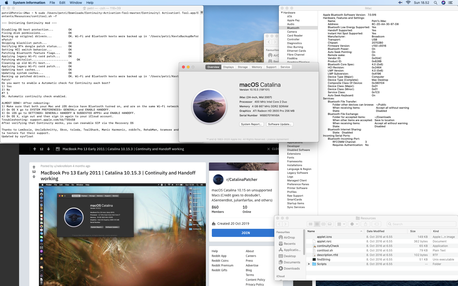

On Catalina I tried to run Continuity Activation tool again. The script failed to start. I then followed instructions I found on Reddit: I opened the package contents and ran the included script file directly from the terminal. System Preferences under "General" now shows that "Handoff" is available and activated.

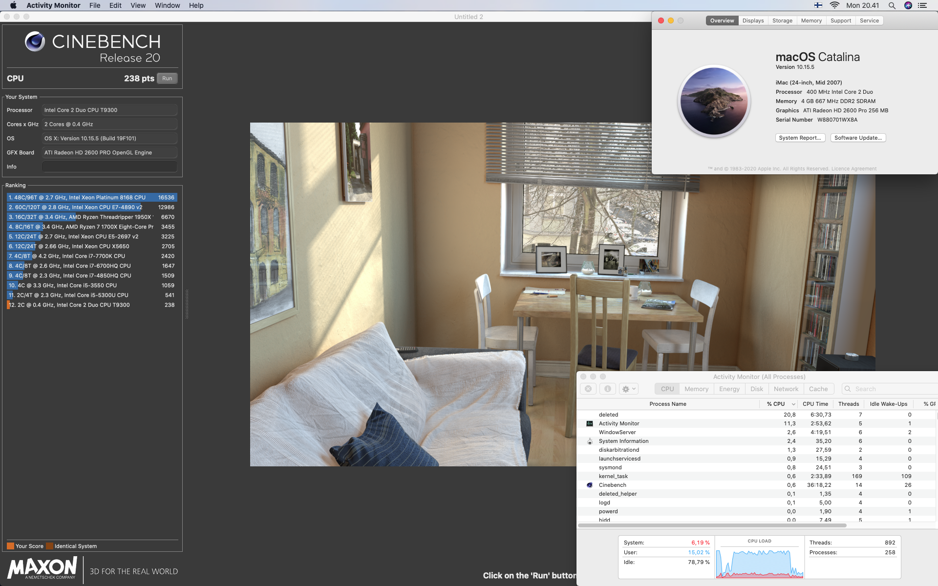

The iMac already had 4 GB of ram. I found El Capitan on a HDD to be extremely sluggish with constant beachballing. Catalina on an SSD seems usable, but it still shows an occasional beachball. My 4-core Mac Pro 3,1 with technology from the same generation works noticeable better. The 4 GB of ram should not be the limiting factor as many modern Macbook Pros and Airs came with 4 GB of non-upgradable ram soldered on. The weakest link may be the GPU. It takes several seconds for all windows to show up after login. Evidently there is still room for upgrades and improvement!
