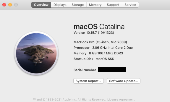

Another successful CatalinaOTAAswufix update to macOS Catalina 10.15.7 (19H1323) on my Late 2009 iMac 27 i7 16GB RAM 1TB SSD Samsung 860.
It did take several tries to get CatalinaOTAAswufix to patch the update. On a hunch, I tried running Silent Knight 115 and found that a couple of things were out-of-date and as soon as those were updated, CatalinaOTAswufix finally worked! I'm not completely sure Silent Knight fixed the issue, but I'll take it for now, as I have 19H1323 up and running!
🚧 If a CatalinaOTAswufix.app update fails, go to /Library/Updates 📁 and delete everything within and re-try. Only a few get it right on the first attempt.🎯The most common user-error seems to be not applying the <OTAswFix> button early-on in the download. Also, SilentKnight is a great tool as it aggressively checks for updates and pulls in MRT and X-Protect changes, as well. 😎

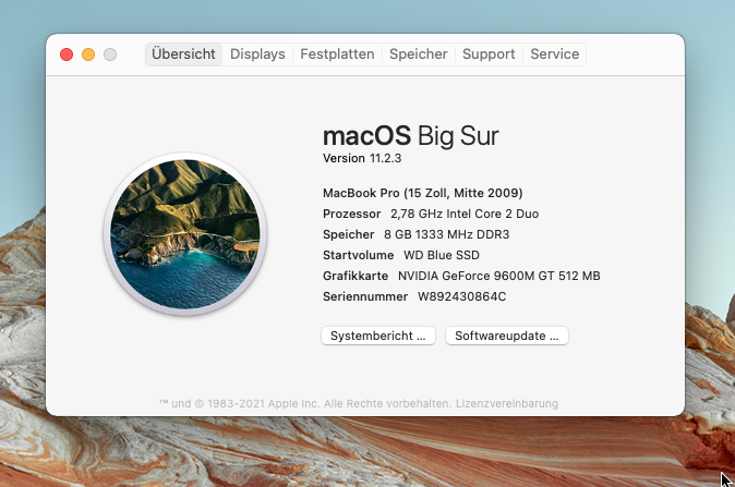

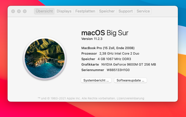

I have the problem with Catalina crashing and restarting in sleep mode on MacBook Pro 2008 and 15" MacBook Pro 2009. Is there any fix for this?
Apply SMC reset(s). Last resort, re-install dosdude1 patches and Force Cache Rebuild. Battery condition can effect stability. FWIW
Thank you for your answer! I did all of these things and none of them helped. But I managed to install Big Sur 11.2.3 on both machines with OCLP and the Non-Metal GPU Acceleration Patches. Both machines work absolutely great now and there are no more problems with sleep mode! I'm so grateful to the developers who made this possible! 🥳

Congrats on BS. Suggest at least 6GB RAM for useful performance. If BS starts to fall apart, replace the SATA cable(s) to the SSDs. A very common h/w issue w/MB of our vintage, see last entry in signature.🧐
Reactions: RioRio
Thank you! :) Actually BS runs well enough on the 2008 MBP with 4GB, but i will max it out anyway. Yes, I have already replaced the SATA cable of the 2009 MBP with a new one from ifixit. It is expensive, but it's less of a headache than ordering a used one from ebay that will either be faulty from the start or will fail soon.
Reactions: K two
A strip of electrical tape where the SATA cable rubs against the housing is inexpensive insurance, if the CDR is still in use. 🧐

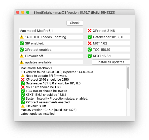

From Silent Knight - should I install all updates?
Unfortunately there is no easy way to update EFI I believe. I would have to remove graphic card, put back original one and go back to some OS X to trigger this update. Too much hassle I think.
I have updated to 19H1323 from 19H1217 thanks to CatalinaOTAswufix.app , however every time I reboot the system there is a Patch Updater prompt on re-installing patches, specifically "night shift" patch. I tried to re-install and reboot like 10 times already but the same prompt is coming back on every reboot. Any idea how to fix it?
If you efi is working well no need to update. Just a suggestion.

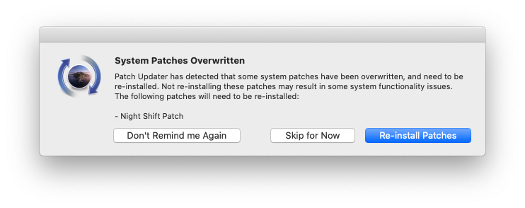

The problem is I am getting this prompt all the time - I have re-installed it 10 times and still getting it:
Edit: nevermind, I run patch updater manually - reinstalled all patches and the Night Shift had to be reinstalled twice it seems and it seems resolved.
