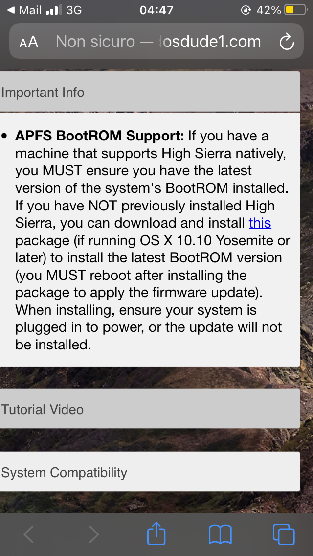

I’m trying to install on a 2009 13 MBP. I used to have a snow leopard & High Sierra dual boot system on this machine but in the last month or so it has shown a few issues, so I’ve decided to wipe everything and have a Snow Leopard & Catalina mac instead, hoping it will solve the issue.
Anyway, I booted in the SL installer and wiped out everything, making two 60GB partitions, then installed, all went smoothly. Then I booted in the dosdude Catalina installer and tried to install on the second partition. Now the mac keeps rebooting up to the black screen “6 minutes left” (or 10 or it depends), goes on for a bit and reboots.
Any suggestion?
did you update the firmware for APFS? there's a link to it on dosdudes catalina page under important information
That’s not necessary (or possible, actually) on machines that don’t support High Sierra natively.
Anyway, it took over three hours but the installation finished eventually. We’ll see how it goes in the next few days.
Reactions: K two

Can you see the name of your startup partition in the boot selector that you get while booting while holding the option key or you get a “EFI Boot” option instead?
Because according to dosdude:
So either you did something that he didn’t anticipate or document or you remember wrong.
