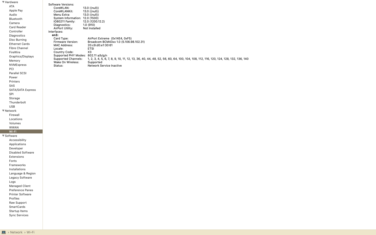

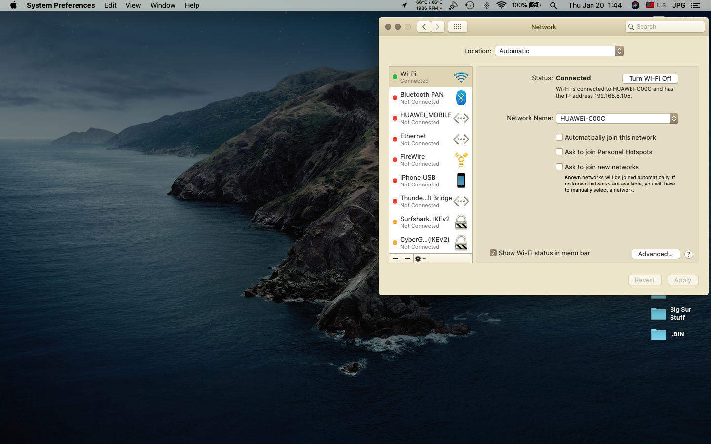

Hi K two, Yes SMC and PRAM but problem remains. Disconects after a while. I will look affrayed cable as you suggest but wouldn't that mean that I would be even able to see card in System Report?
Reactions: K two
During an intermittancy does the card continue to appear in the System Report? 🤷‍♂️
Yes for the most part; in rare occasions when I delete card from network settings so as to reinstall as some posts have suggested, it doesn’t show when I want to add it back. I then need to reset with PRAM to see again WiFi to add to network list of devices. I wonder again if it could be the firmware issue since supposedly it should be boot rom version 84.00 as oh high sierra and I show version 82.00. I had after having tried BS came back to Catalina with a clean install via high sierra last compatible for mbp 8,2 but the mbp still showed version 82.00 rather than the 84. Perhaps I should have waited to get an update before immediately proceding afterwards to a clean install of Catalina? I am on a big fishing expedition here haha…

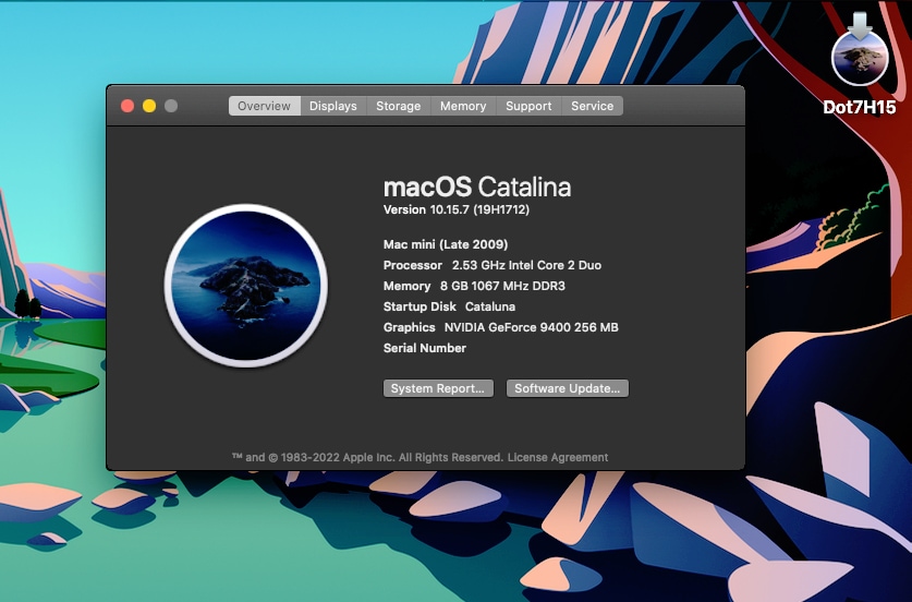

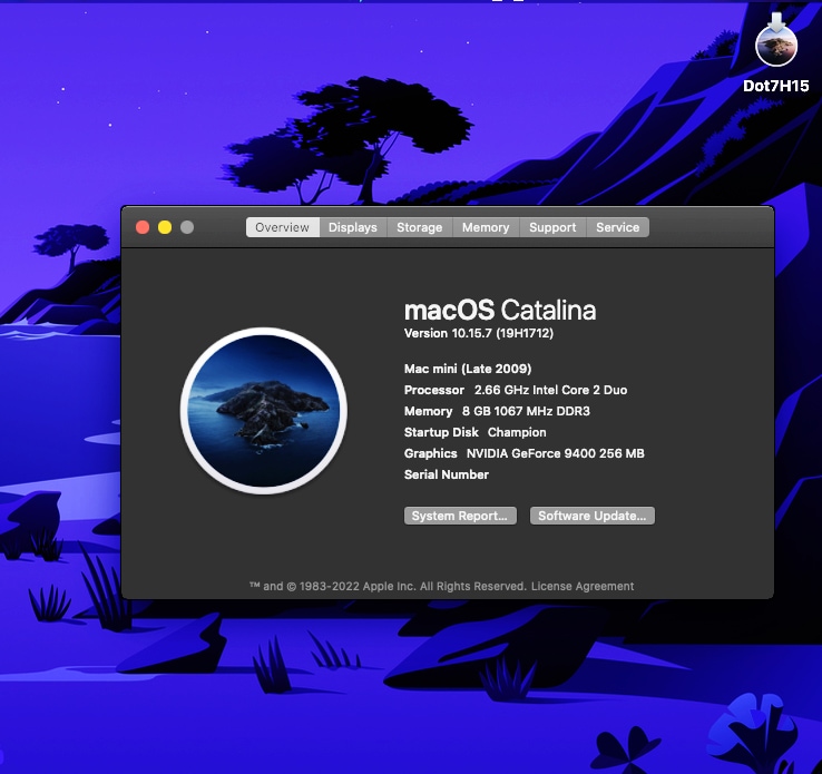

Hi,
just noticed - even if the updates seem to install, I see the Catalina build number in my case always shows up as 19H2. This is a bit suspicious, isn't it ?
EDIT: I expected the build to increment after software updates. But please correct me - if it's not true. Thanks.
Reactions: K two
Hi,
The update is not completing. :eek:
