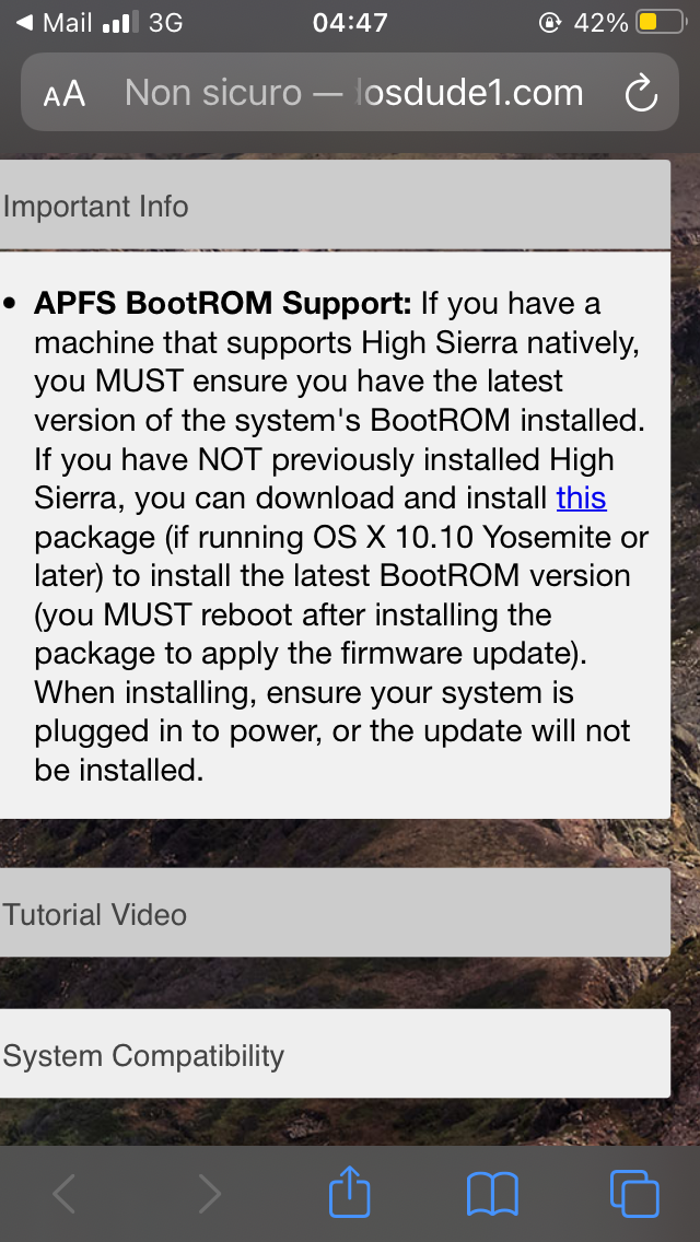

Can you see the name of your startup partition in the boot selector that you get while booting while holding the option key or you get a “EFI Boot” option instead?
Because according to dosdude:
So either you did something that he didn’t anticipate or document or you remember wrong.
Because according to dosdude:View attachment 1940059
i don’t think you are parsing what dosdude is trying to convey properly.
You didn’t answer my question.
As per your original comment:
did you update the firmware for APFS? there's a link to it on dosdudes catalina page under important information
And THIS firmware update is the one made by apple and, as far as I know, only works on machines that officially support high Sierra.
The several patches that allow APFS booting have zero to do with the firmware and are not linked on dosdude’s page, but one is automatically installed with the postinstall tools on the modified installer. With this one you get a “EFI Boot” icon and a verbose booting script before the OS loads and it’s the only way to boot APFS on machines that don’t support it starting from dosdude’s page. Other ways exists, but, afaik, none involves apple’s firmware updates.
yes, i installed the APFS firmware from dosdude1's link.
joevtt's post has more than enough details to cover your lack of comprehension

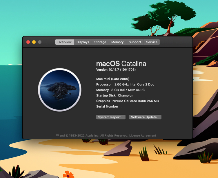

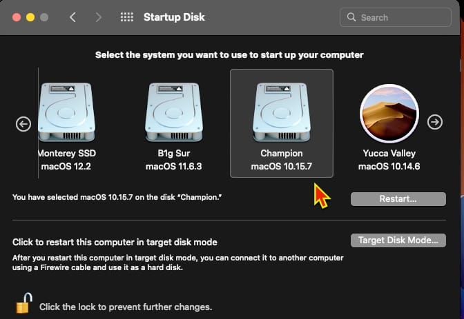

🪓Each macOS is installed on their own separate partition on a Mini3,1 with an UNPATCHED bootROM. The Mojave and Catalina installs are originally via @dosdude1 patchers installing his APFS boot patch PRIOR to the use of OCLP for Big Sur and Monterey. 🚧 And as stated clearly in the OCLP docs, the patching of the bootROM is not required using OCLP - https://github.com/dortania/OpenCore-Legacy-Patcher#readme >see fifth bullet down. And in-fact, the original dosdude1 APFS boot patches are completely bypassed during start-up, yet @dosdude1 Mojave and Catalina installs boot and run as expected. All four (4) macOS installs run on the same unpatched bootROM machine w/o issues. :cool:

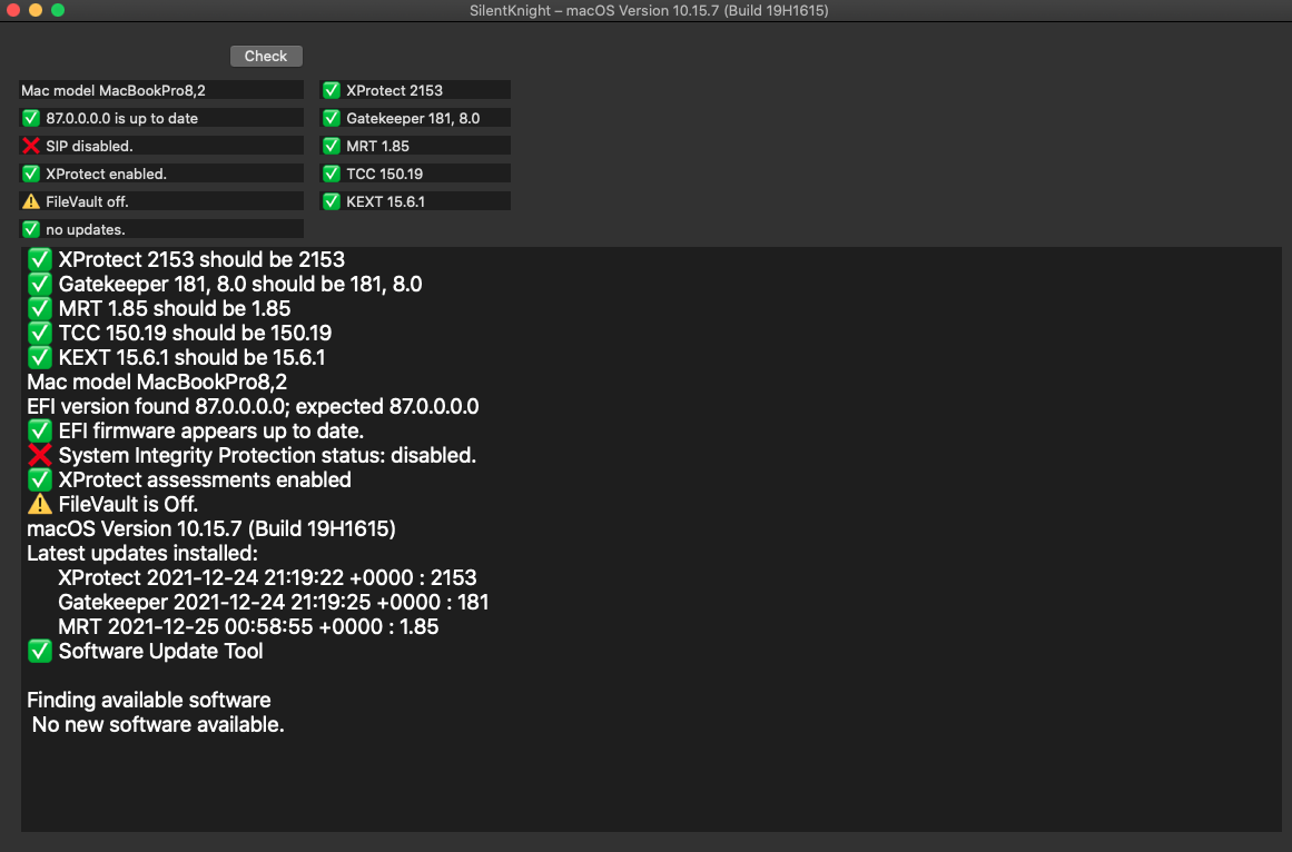

I also use SilentKnight to confirm updates:
Reactions: makra and K two

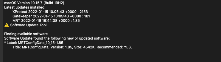

Hi, thanks for this hint.
I've run it, although the MRT is messaged as "version not known", it informs on new version available 1.85 - but here it lists that same version 1.85. Maybe, I bricked the update installer ? It is a imac7,1 with Catalina, but all seems to work great. Any ideas ?

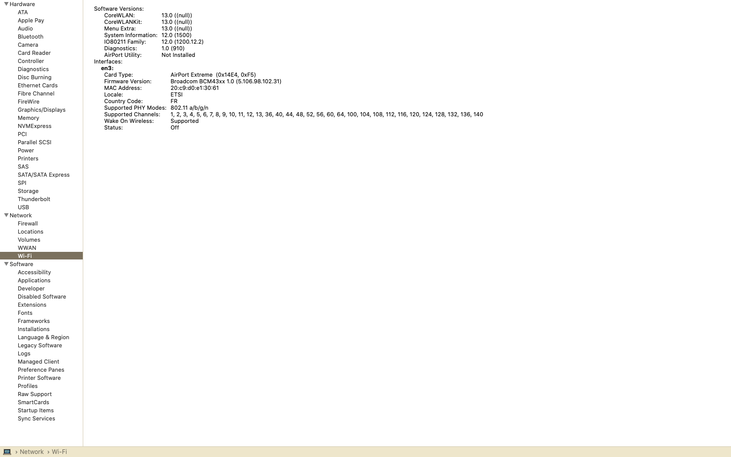

RE: WiFi erratic behavior; will not turn back on.
Hello all, I have been experiencing Wifi connection issues. I have tried to "delete" wifi and reinstall as per explanations found on Net; sometimes I get a connection that lasts about 15' and turns off without being able to turn back on. My Lan connection works fine as well as using my iPhone 12 mini and/or portable modem (Huawei) via USB/Bluetooth only connection. I know the Wifi/Bluetooth is working as it appears in system report. Actually swapped out a defective original wifi card with a compatible Wifi n and BT 4.0. which worked after install but began disconnecting shortly after. I have even tried PRAM and SMC reset to no avail. this has occurred with Catalina 10.15.7 official release as well as latest security/beta updates. Anyone have any ideas? Thanks.
You just discovered why the replacement card, used was sold. ;)
The same happened with the original card before failing. Many have been using thé updated card without a problem and is also sold by ifixit, I seriously doubt they would be staking their reputation on a ‘bogus” card IMHO. Many have also reported the disconnect issue on Catalina , Iwas hoping someone had encountered the problem and found a solution for the wifi as the BT works fine.
