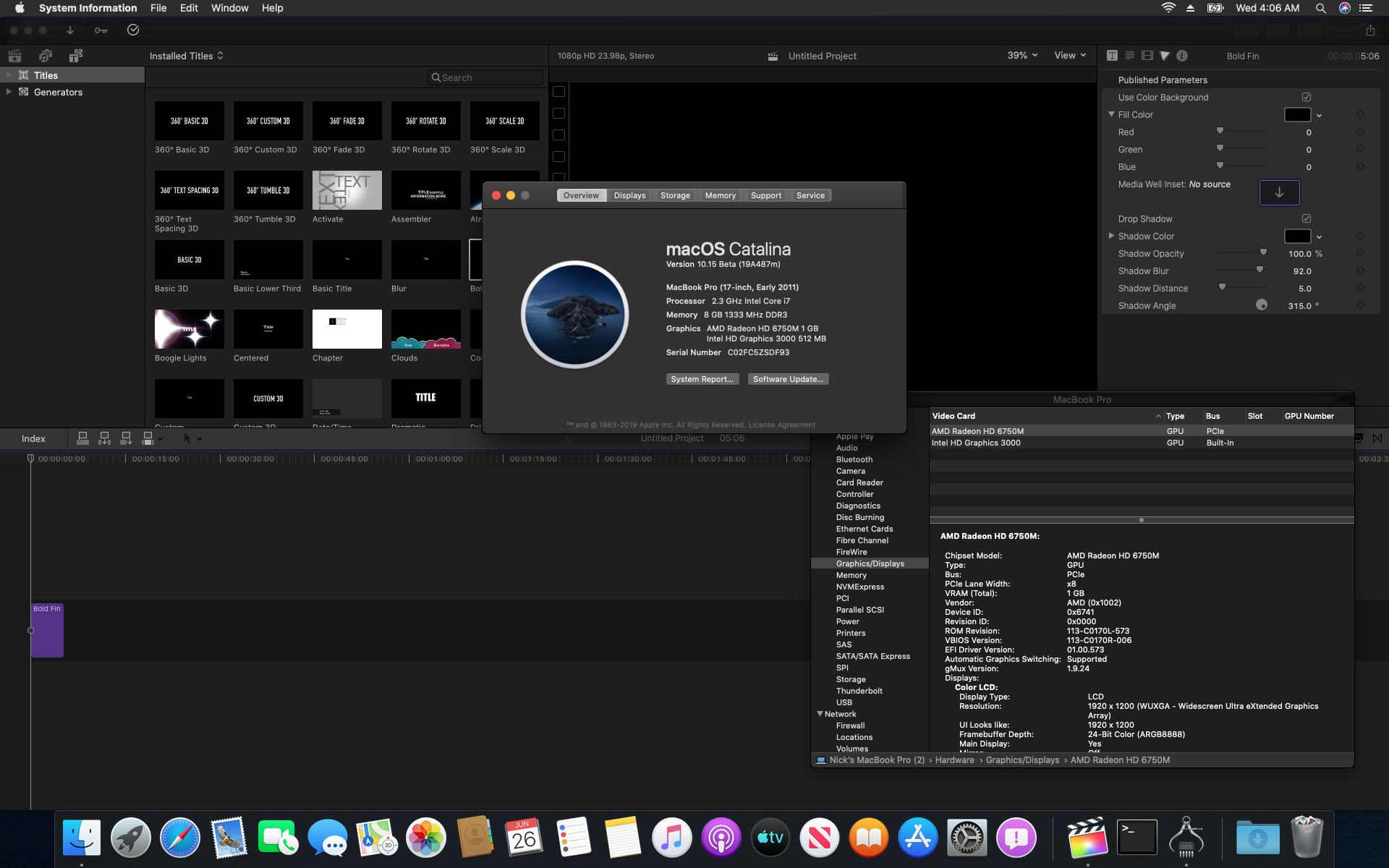

From @nicksilverstein picture from a dualGPU seems to be using as primary the AMD 6750M, and even if the "dark mode" doesn't help in distinguishing well, seems that the Dock (thinner edges) is transparent under that AMD GPU.
Unless it's an hybrid acceleration that gained from the IntelHD3000.
I don't know about that. I was confused by that post also since I don't see anything accelerated. Looks like the Dock is simply framed to me. Maybe @nicksilverstein can post another screenshot where we can see a vibrant Dock or Notifiction Center or Finder etc. ?

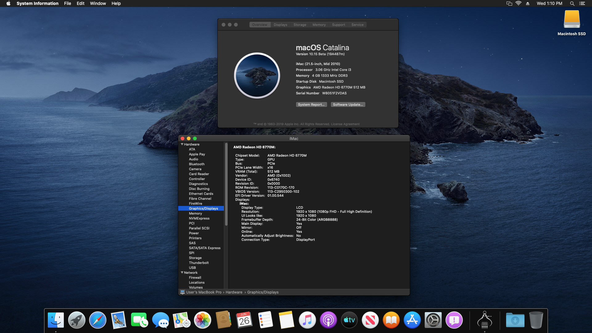

Sure, would still be great for MBP, whilst their AMD GPUs hold-up... I looked at trying to use the intel GPU to control the iMac back-light, no dice. Also been testing Mojave + Lilu/WEG to get HEVC decode on my iMac's WX7100, pretty sure I swapped a 6770 back in at one point, and would probably have noticed acceleration...

The original screenshot clearly shows acceleration, though. Hey @nicksilverstein, would you mind sharing how you got this setup? This could be one of the most significant finds since last year.
From his own machine if shares just this from Catalina Terminal:
kextstat > ~/Desktop/kextstat.txt
I guess it would be enough suffice to understand.
As a basis surely @nicksilverstein used all your Catalina patches, because without your patched non-metal frameworks no loginUI, and without patched IOSurface.kext the IntelHD3000 kernel panic on boot.
I got Final Cut Pro X 10.4.6 to launch on macOS Catalina on a MBP 2011 17-Inch without removing the AMD kexts. All I did was I installed macOS Catalina with @dosdude1's tool. Then, I installed Lilu and Whatevergreen and bam it launched. It's really buggy probably because Lilu and Whatevergreen haven't been updated for macOS Catalina yet and neither has Final Cut Pro X. I am going to try Mojave and Lilu and Whatevergreen. Maybe there's hope for these old AMD Cards after all (by someone way smarter than me). I'm going to post a picture (if you don't believe me) and look up my serial number (if you don't believe me either):
That dock is definitely accelerated.

Good suggestion. And if the screenshot was against a different background the Dark/Light mode vibrancy (true test of OpenGL acceleration) could be more obvious.

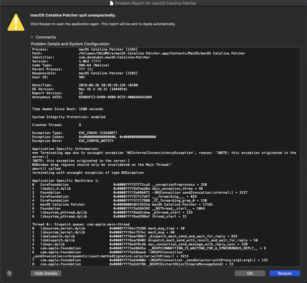

Try running
Code:
sudo killall patcherd
in Terminal, then try running the tool. There's a few small cleanup operations I need to implement still to prevent this.
I've run that command in terminal and this happened

The graphic card has 512 mb. That's acceleration, right?

Not necessarily. You can get to login and UI without full OpenGL gpu based acceleration. That's the whole point behind our acceleration patches. If there's a Lilu/WhatEvergreen plug-in that enables GL acceleration on our unsupported non-metal machines - I'd like to see it!
The fact is that FCPX typically used also in HighSierra a "dark mode UI style", so vibrancies are not much noticeable, however checking at minimum requirements: https://www.apple.com/final-cut-pro/specs/
seems that FCPX is capable to run also on an IntelHD3000, so not sure if a full acceleration on AMD 6xxx is really achieved there.

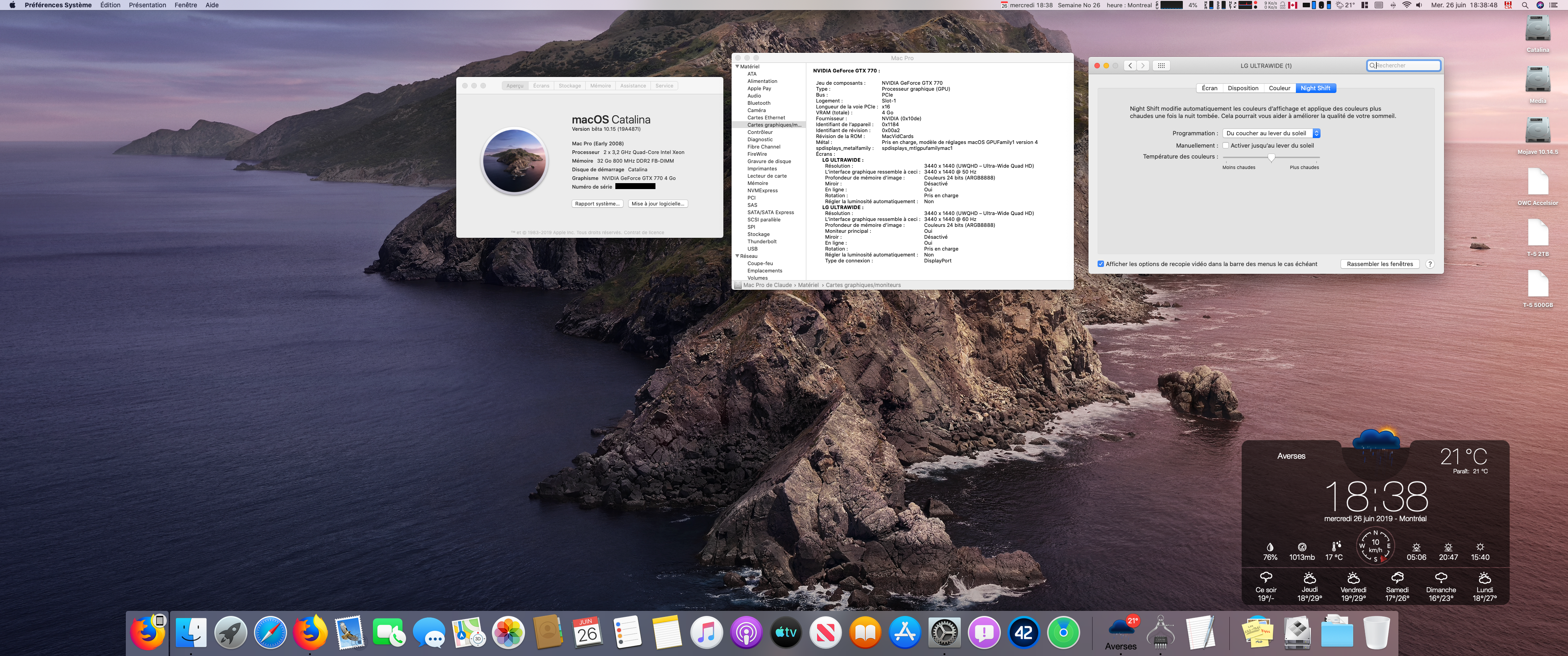

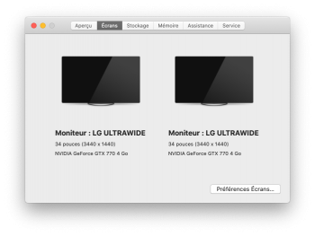

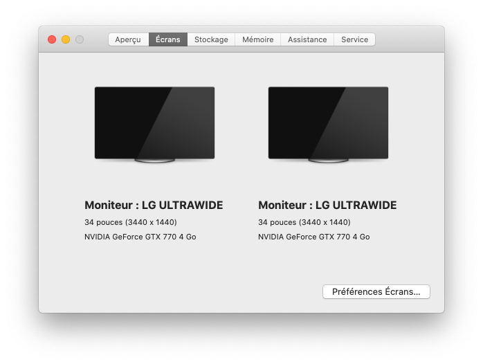

Hello jackluke.
I have a NVIDIA GeForce GTX 770 4 GB with MacVidCards ROM. That card works well in Mojave. Also, Night Shift is activated and is functional in Mojave.
Both monitors are detected correctly in the Displays tab in Catalina. I have also video acceleration in Catalina
If you need other info, please let me know.
