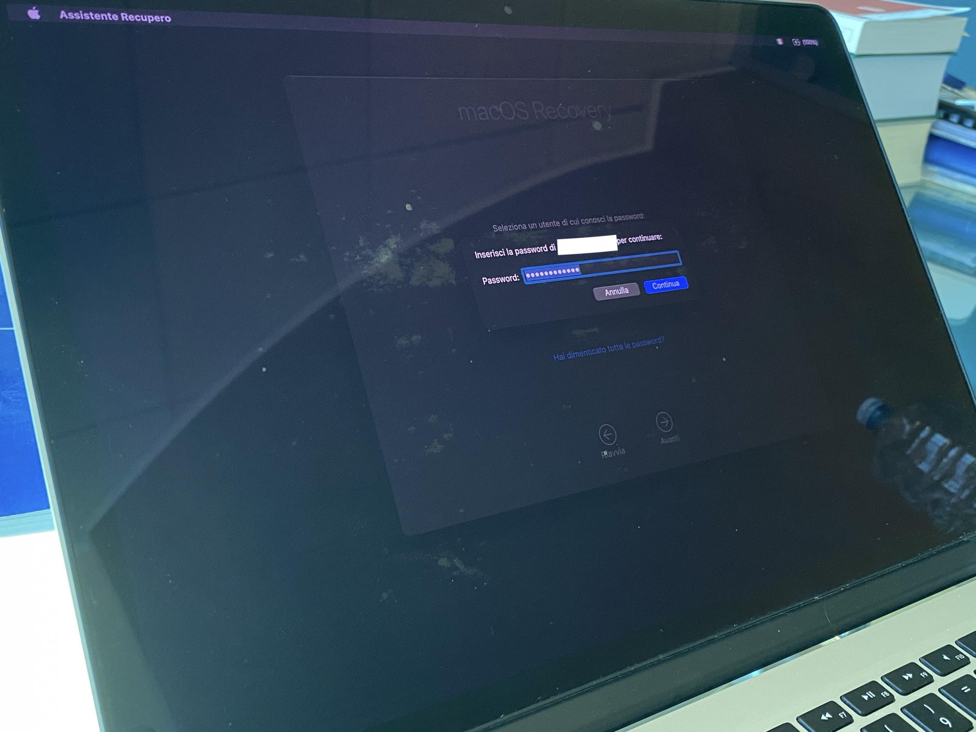

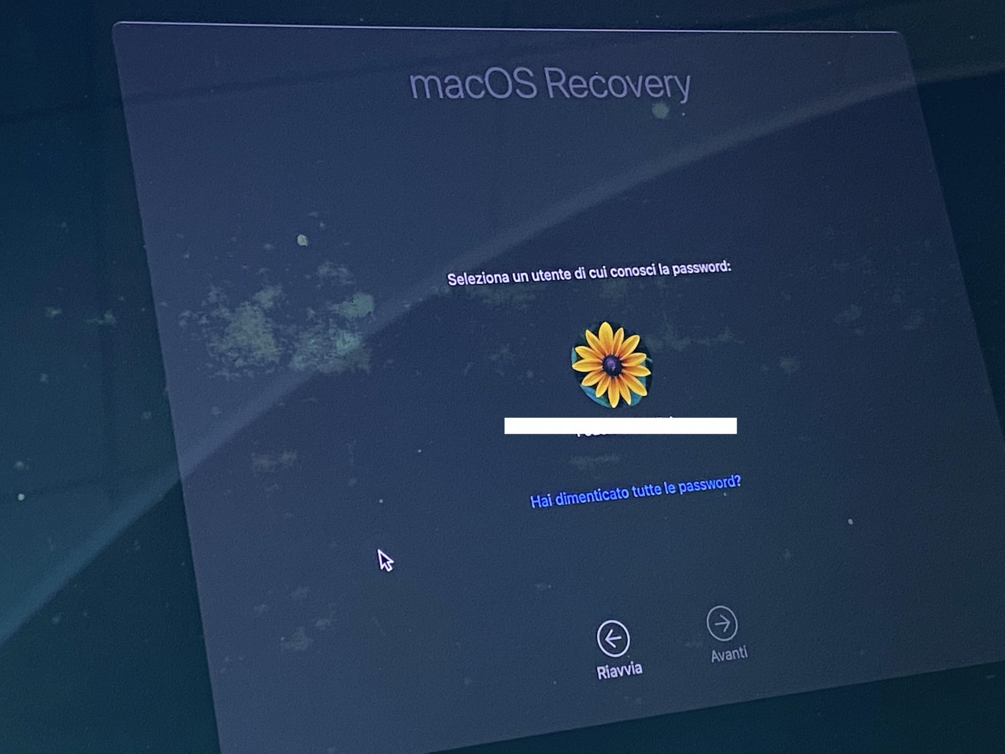

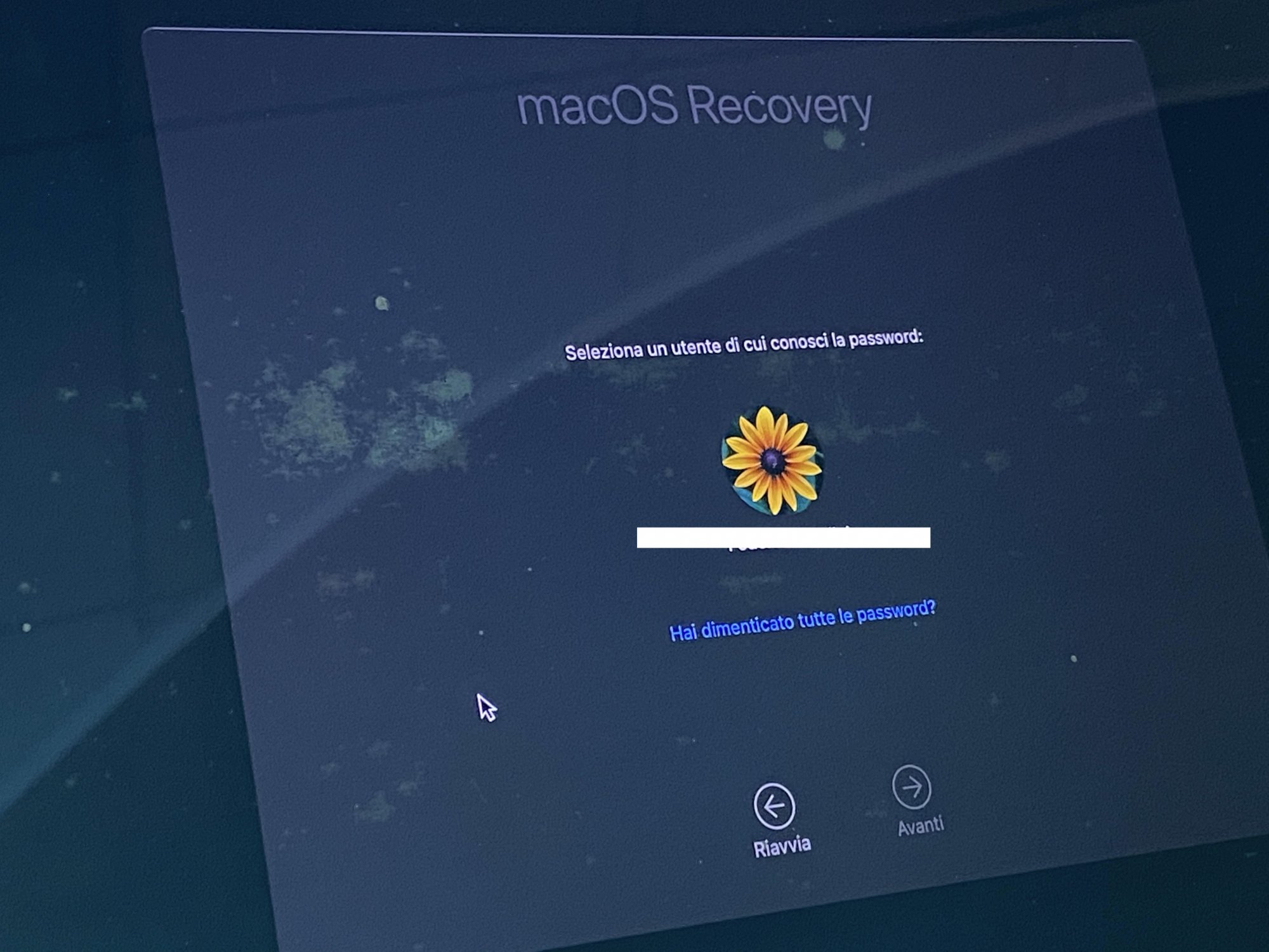

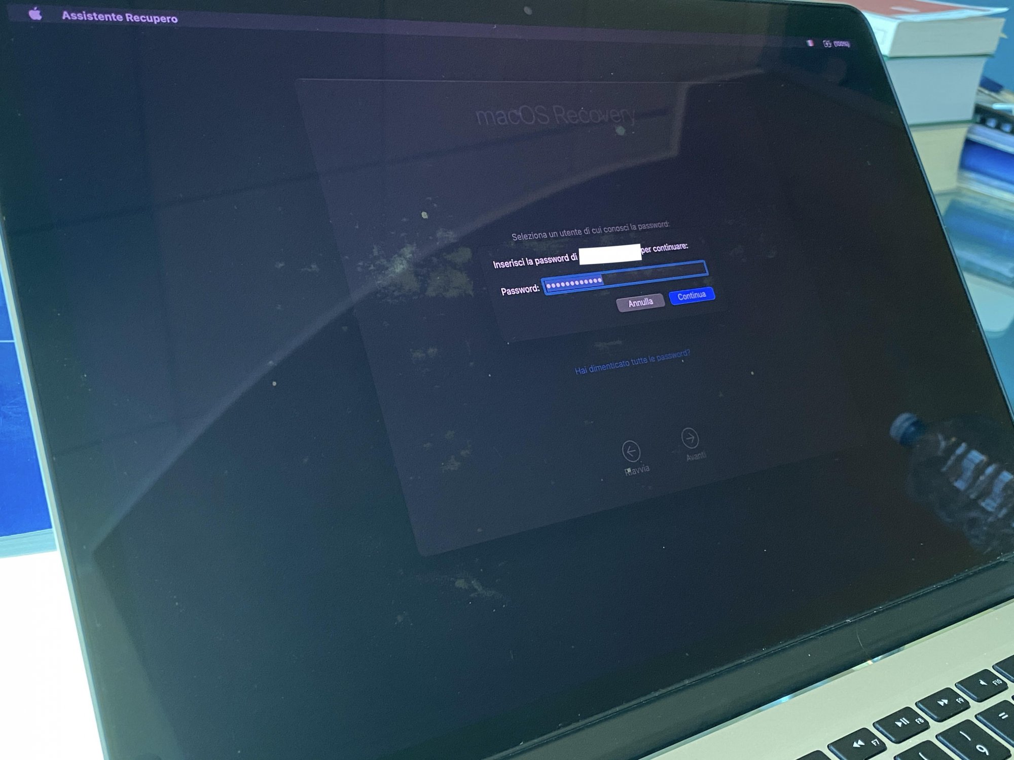

I think I need some more information: Are you using FileVault by any chance? If so, on your Big Sur installation or on another macOS installation? (Or both?) Looking at your previous posts, it appears that Big Sur beta 3 was upgraded from beta 2. Was beta 2 a fresh installation or was it an upgrade from an earlier version of macOS?
Without FileVault, I haven't seen the installer ask for a password.
I just realized, if you're using a different password on a previous (pre-Big Sur) installation of macOS, that might be the password that's needed.
A photo of the password prompt might give me a better idea of what's going on -- but if it might reveal anything private, then don't bother.

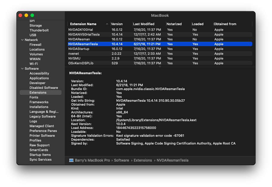

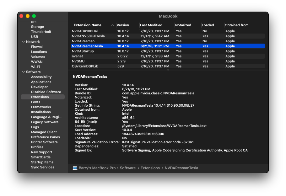

If the signing issue (by itself) was the problem, then ASentientBot's patched NVDAResmanTesla.kext shouldn't work -- but it does, as shown in the screenshot below. (Note that the machine is called "Barry's MacBook Pro" because I installed Big Sur beta 3 onto a USB SSD using my MacBookPro8,1 before I applied the patches and brought the USB SSD over to my MacBook6,1. Also note that even though there's a signing error and it says "Loadable: No", it also says "Loaded: Yes" because disabling SIP bypasses the signature check.)

Just an update on Big Sur Beta 3 installation on MacBook Pro 5,2 (Penryn C2D). Most of the "fixes" used to install Big Sur beta3 were courtesy of jackluke and Asentientbot, but there are many other individuals involved in this endeavor.
Reinstalled Big Sur beta 3 on the internal drive of my machine (from separate partition on same internal drive). I applied all the necessary modification, as noted in this thread, with near-total success.
WiFi is fully functional
Sound and microphone are functional.
Frame buffer appears to be active.
"light" mode works; all icons on right side of menu-bar are visible.
However, the modified NVDA drivers do not appear to load; there is no brightness control, nor do function keys allow for change in light intensity. The display control panel has a generic "look" and no visible controls.
I tried to manually to insert a modified NVDAResmanTesla.kext directly into extension folder, using jackluke's method, as described in post 1781 (page 72), but on reboot a kernel panic occurred; trace back showed the NVDAResmanTesla to be the part of the problem. I had to reinstall the Big Sur 3.
For non-Metal Nvidia Tesla on BigSur you should replace this package of kext, not only the patched ASentientBot NVDAResmanTesla, in the package is also included the patched ASentientBot GeForceTesla, but it is not included the GLDriver because too big to upload, anyway "brightness control" should work without it, only framebuffer video is required.

After I wrote the rest of this post, I remembered that an upcoming version of my patcher (probably v0.0.18, so probably not the next release but the one after, hopefully later this week) is going to change step 9 so you don't have to boot from the installer USB again. That might end up solving your problem. However, I'll still leave the rest of the post here, because I'm still curious about what's going wrong.
Hi, yes, my disk is encrypted with FileVault. However, it was encrypted when I (a) installed Big Sur Beta 1 on top of Catalina; (b) upgraded from Beta 1 to Beta 2, and from Beta 2 to Beta 3 (which I am currently using): in those cases, I had no issue at all when I was requested to enter my password (BTW, I used my login password). The problem has shown up only three days ago, when after a successful upgrade to Beta 3 I rebooted into the installer to perform step 9 in order to fix the WiFi. It's really strange. Attached are two photos of my Retina MBP with password request. Thanks! P.S.: I know, my MBP has the StainGate!

Hi, yes, my disk is encrypted with FileVault. However, it was encrypted when I (a) installed Big Sur Beta 1 on top of Catalina; (b) upgraded from Beta 1 to Beta 2, and from Beta 2 to Beta 3 (which I am currently using): in those cases, I had to issue at all when I was requested to enter my password (BTW, I used my login password). The problem has shown up only three days ago, when after a successful upgrade to Beta 3 I rebooted into the installer to perform step 9 in order to fix the WiFi. It's really strange. Attached are two photos of my Retina MBP with password request. Thanks! P.S.: I know, my MBP has the StainGate!

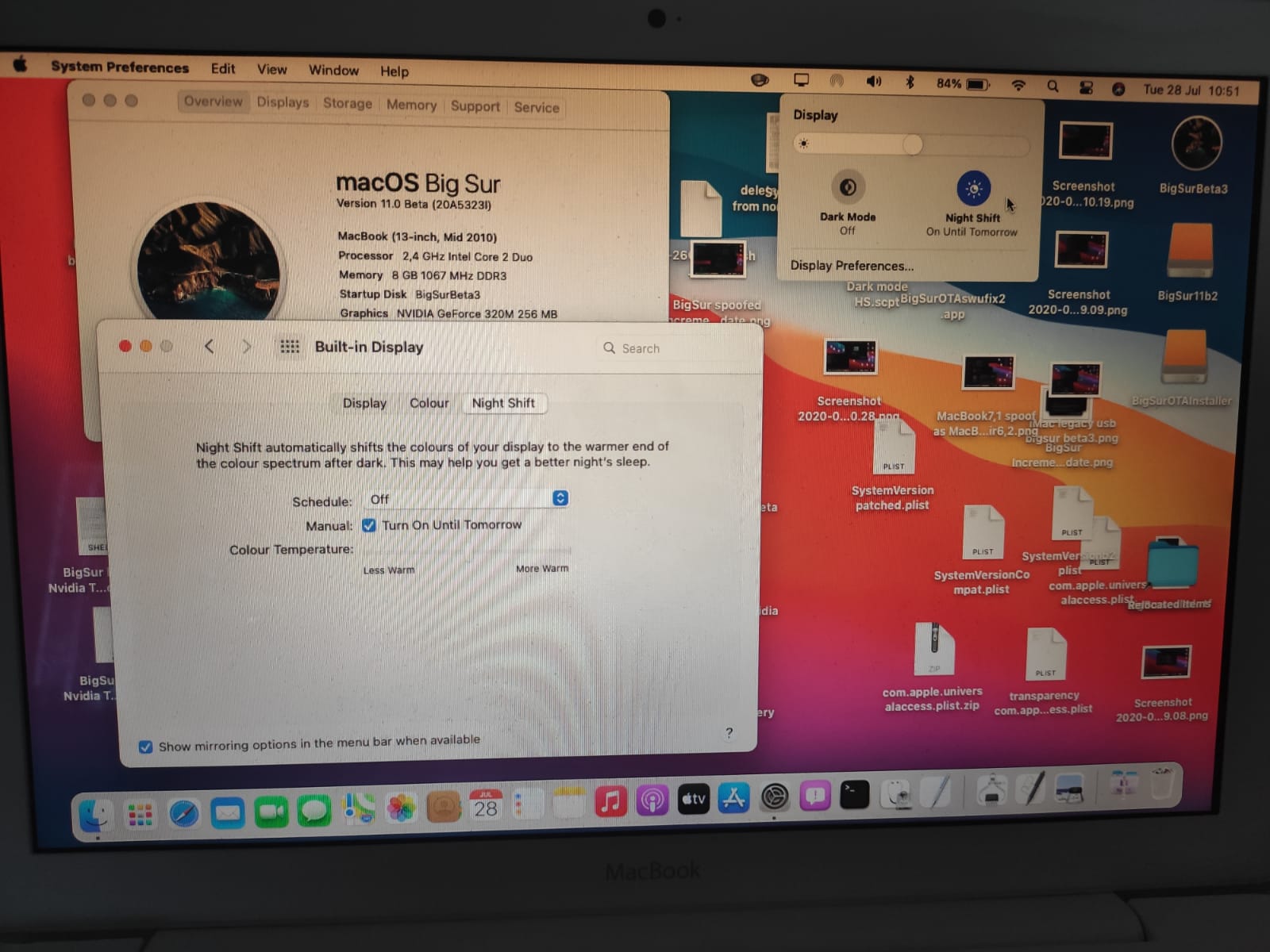

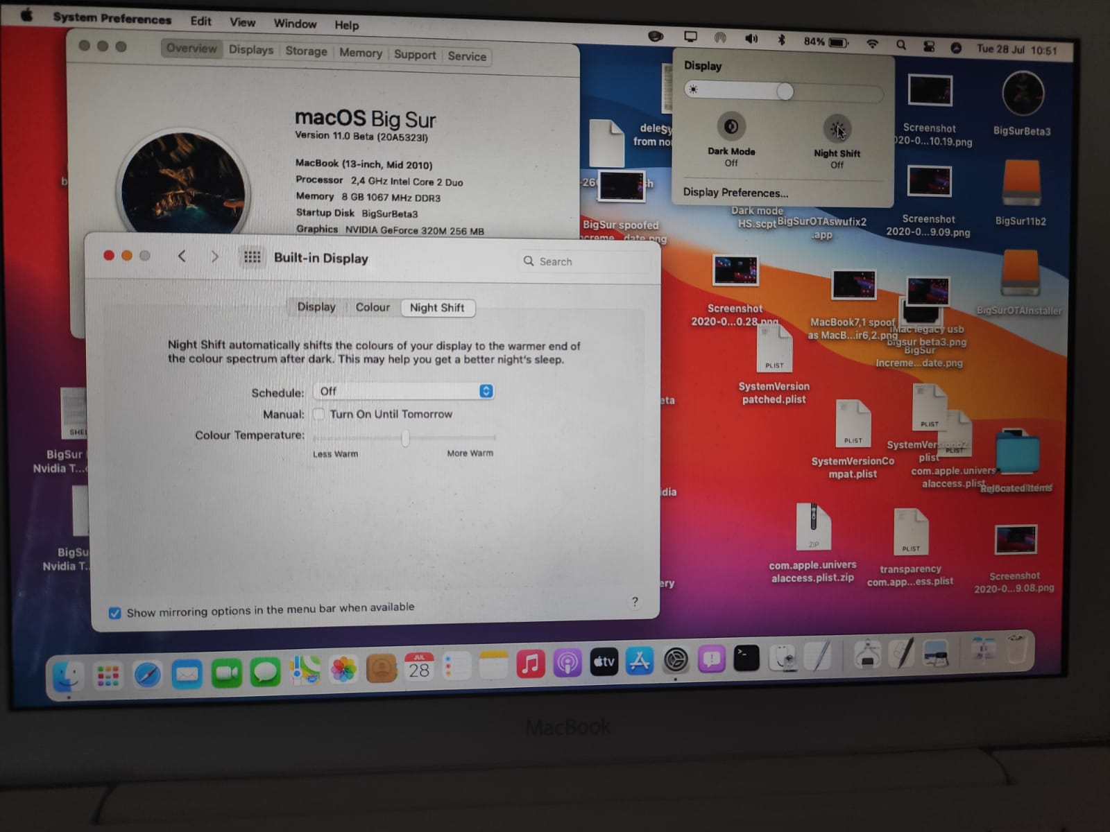

It worked, keeping the stock BigSur "dyld_shared_cache_x86_64", I simply replaced the BigSur Privateframeworks CoreBrightness.framework (that essentially is only an alias) with the one from Catalina 10.15.6 and now Night Shift is working on an unsupported MacBook7,1 (@ASentientBot you could test this attached it should work).
Note: the non-metal videoframebuffer drivers are required, and to use any patched framework you need a disabled library validation, you could use nvram boot-args="-no_compat_check amfi_get_out_of_my_way=1"
(this is already included in my prelinkedkernel fix and USBopencore so there is no need to add it on nvram)
otherwise if you use the stock BootKernelExtensions.kc you can use this ASentientBot method (before replace the framework):

(@hvds you could test it should work also on your MacBookPro5,2 , just replace the framework in ~/Snapshot/System/Library/PrivateFrameworks/ with the same method you used for replacing AppleHDA.kext)

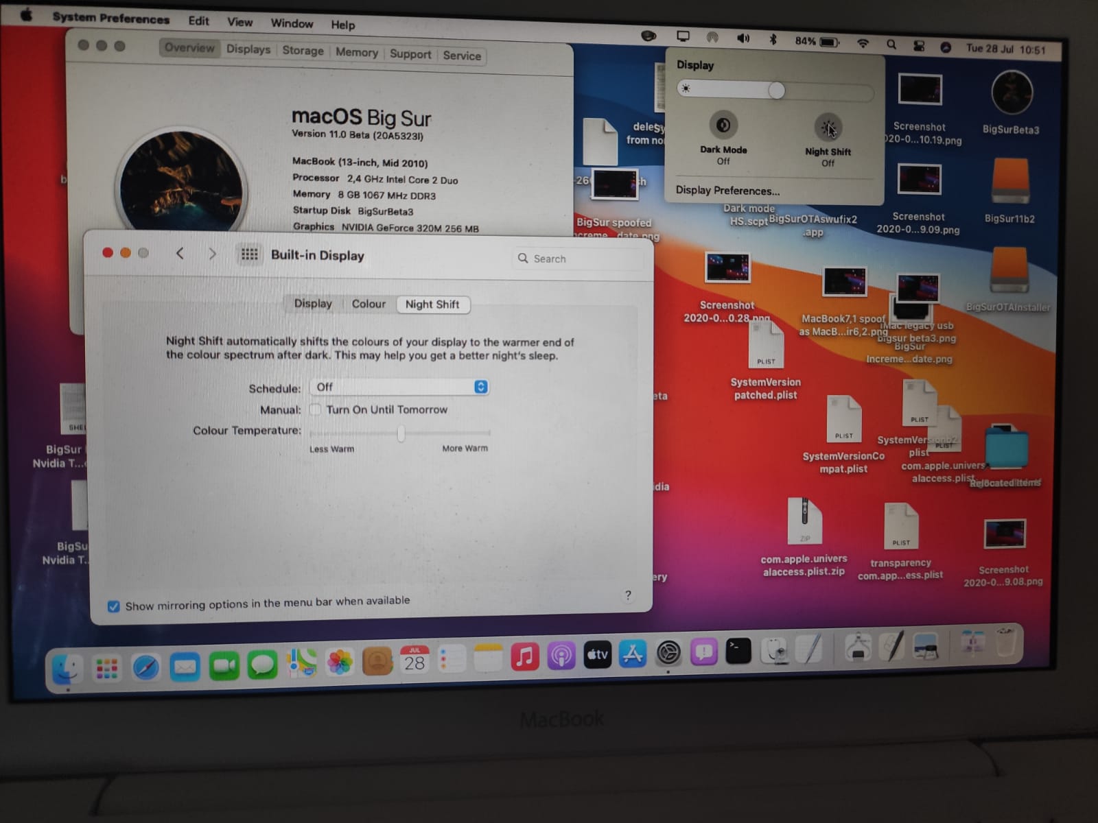

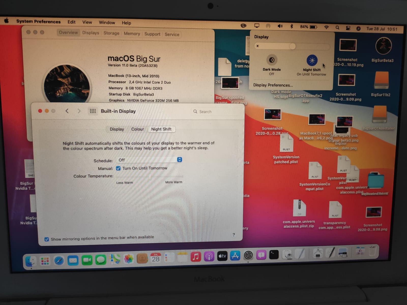

I attach two proof pictures and the CoreBrightness that I patched with pikeralpha method.
This attached should allow Night Shift on any BigSur unsupported mac, use it from BigSur beta 3 or later (because apple from this version changed the IOKit from 10.16 to 11.0 ).

Thanks! This information is helpful. Now I can try to reproduce the problem, although I expect it will take me a while.
My best guess is that this is a bug in Big Sur, so it's possible that beta 4 will fix it. (I'll still try to reproduce the problem when I get a chance, however.)
