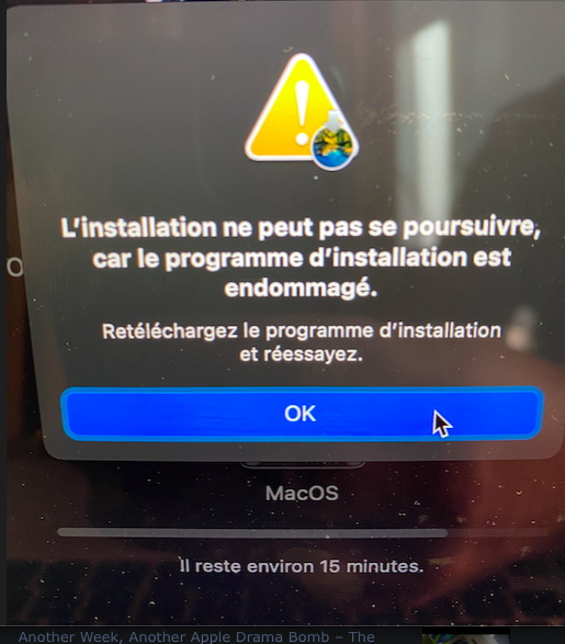

I tried to re-disable SIP and set the compat_check but no luck.
Text in French sorry : Installation cannot proceed because the installer is damaged
Any thoughts ?
Thanks
Reactions: TimothyR734
All,
Any thoughts ?
Thanks
The installer is damaged? Happens all the time while downloading and copying 12GB of data. Bit errors may occur while writing and USB thumb drives are more rubbish than a data storage... it may even be the downloaded installer file which is damaged and you can create as many new USB thumb drives as you want without having success.
Good point. I already tried 3 times but 4th the charm :). will do it from another machine. Even from official channels.

I had this "corrupted installer" issue several times with all MacOS versions I installed on unsupported machines during the last five years

USB drives for less than a dollar are the most likely reason. The transport protocol has several checks to avoid transportation of corrupted data, but with limited check bits you cannot detect every error.
I barely had to to do a download twice, mostly because I decided to reboot before finishing the download, but I often had to rewrite a cheap USB stick. Guess your provider theory just collapsed...

When I ran the first time into this bad installer problem I could hardly believe it, too. Never had an obvious problem with data corruption, but the main developer of Sun ZFS blogged about the probability to have bit rot in these days. I guess we simply do not see these problems when 90% of data is pictures and movies on our discs and 90% of the internet traffic is unwanted email :)

I tried what you suggested to same result. Given the error messages I am wondering if I don't have a nvram issue :
nvram: Error getting variable - 'boot-args': (iokit/common) data was not found
I noticed also on boot that the Primary partition is not showing anymore.
I am starting from scratch again ..
Try a PRAM/NVRAM reset and/or a SMC reset.

Update .. Found a post (I wasn't sure if Could post it here) stating that Apple "killed" the nvram command on BS so you cannot set it anymore. workaround is to use a recovery or another installer to do it.. I will try this and report back.

OK, this is confirmed. I booted using a Mojave disk and I was able to set the nvram.
I rebooted again on BS installer and ran the setvar.sh .. restart and the installer continued ... yeahh
So I think this is definitely a requirement to set in place. I had reset my nvram a while back so this needs to be accounted for.
