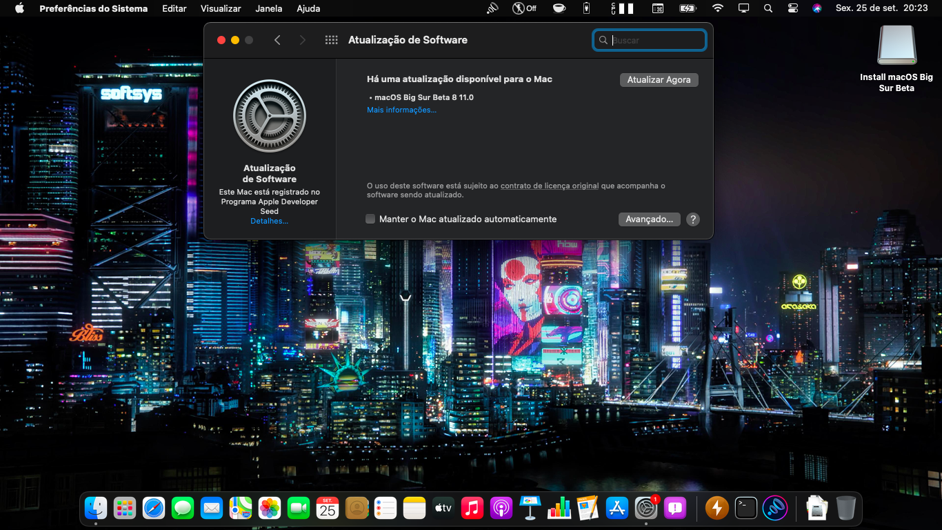

Ok, guys. I just heard from a friend of mine how to get beta 8 using jackluke's usbopencore and Barry's patcher, with airdrop enabled. I will be testing it out this weekend, and will post steps if it works. He even said that hardware acceleration is working on his 2012 13" MBP, but I need to fact-check that with my 2011 13" MBP.
[automerge]1601031636[/automerge]
I will be testing it on a separate partition, and if the results are good, I'll repeat the process on my main drive!
Some notes about my USBopencore 4.2 spoofing version, if after beta 6 installation you patched some kext (typically the Wifi and Sound) that means these kernelcollections changed compared to a "sealed system apple stock":
BootKernelExtensions.kc (easily recoverable), SystemKernelExtensions.kc (size 500 MB or more, not easily recoverable, but more easier if you have an unsealed system or a working "sudo mount -uw /") and AuxiliaryKernelExtensions.kc (that are kext installed on /Library/Extensions/ not useful for Wifi or Audio patches).
Probably some mismatched kernelcollection is recoverable from a BigSur recovery through: kmutil invoke-panic-medic or kmutil trigger-panic-medic --volume-root /Volumes/<YourVolumeName>
Anyway regardless of "SystemKernelExtensions.kc" that is also updated when kext are patched, this should fix an usbopencore booting for the BigSur's Preboot: https://forums.macrumors.com/thread...unsupported-macs-thread.2242172/post-28948321
I know It's weird but you need a separate snapshot for opencore, because the snapshot booting used for "apple startup manager" is tagged for a different UUID root, but using my previous step from single user mode should fix this even when using a kernelcollection with patched kext.
My USBopencore setup could work also for other machines, but for those who have a MacPro I advise to follow this thread: https://forums.macrumors.com/threads/opencore-on-the-mac-pro.2207814/

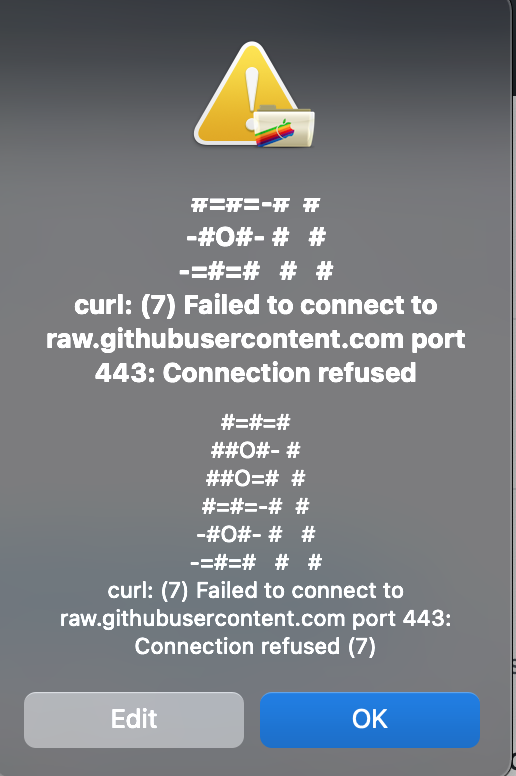

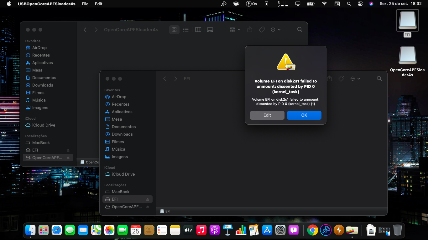

What can I do for this error ?

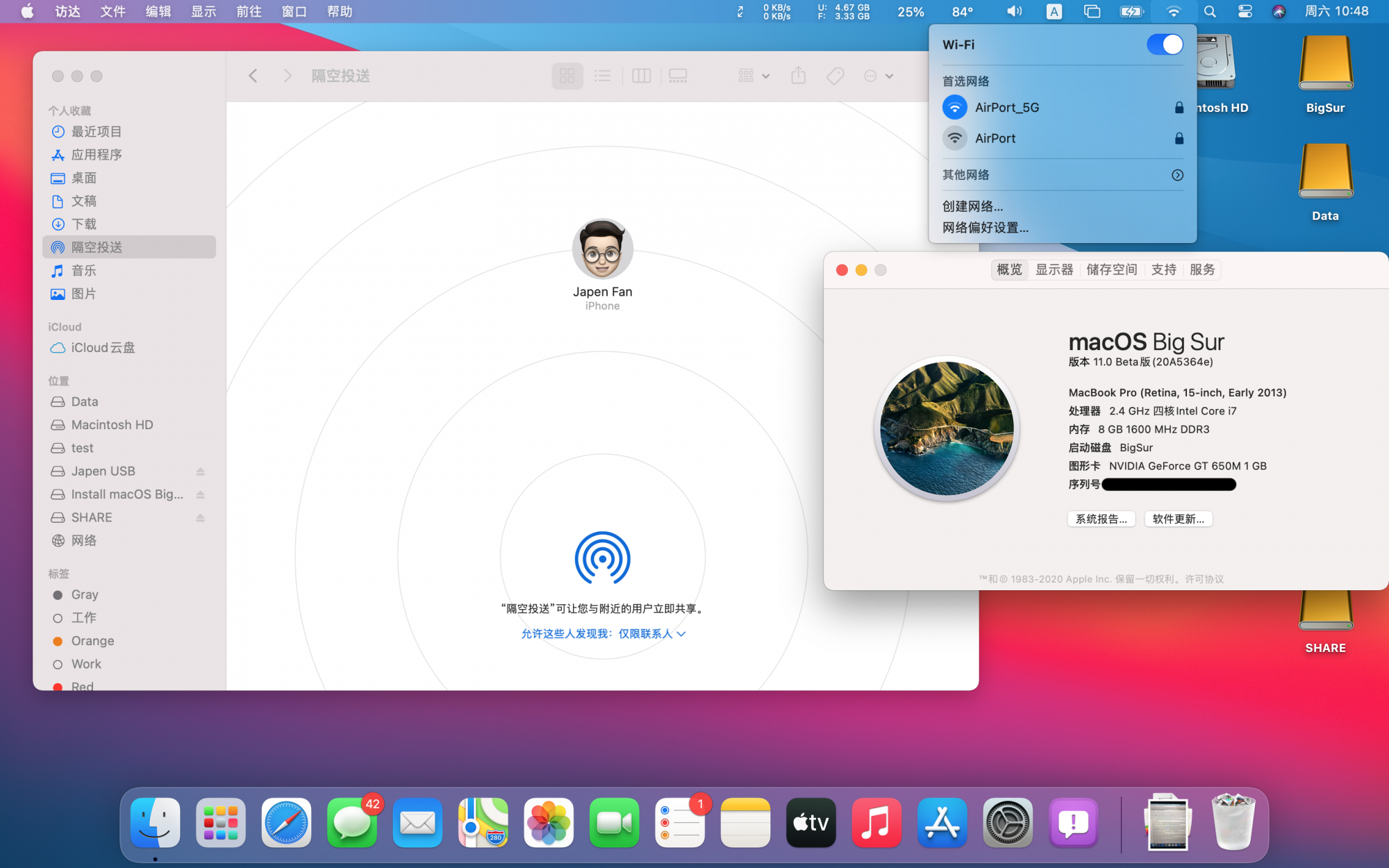

Thank you, Barry K. Nathan. AirDrop works well, but no hand-off =.=.
To make handoff working, from System Preferences General tab check this:
Allow Handoff between this Mac and your iCloud devices
If already checked then you should from System Preferences Sign out and Sign in again with your Apple ID that must be the same for your iOS devices, moreover you should enable the two form factor authentication: https://support.apple.com/en-us/HT204915 that since Catalina is required to get continuity features to work.

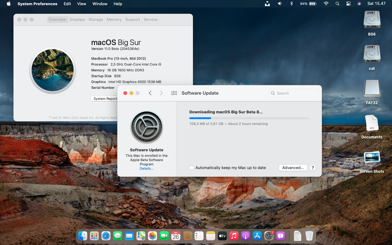

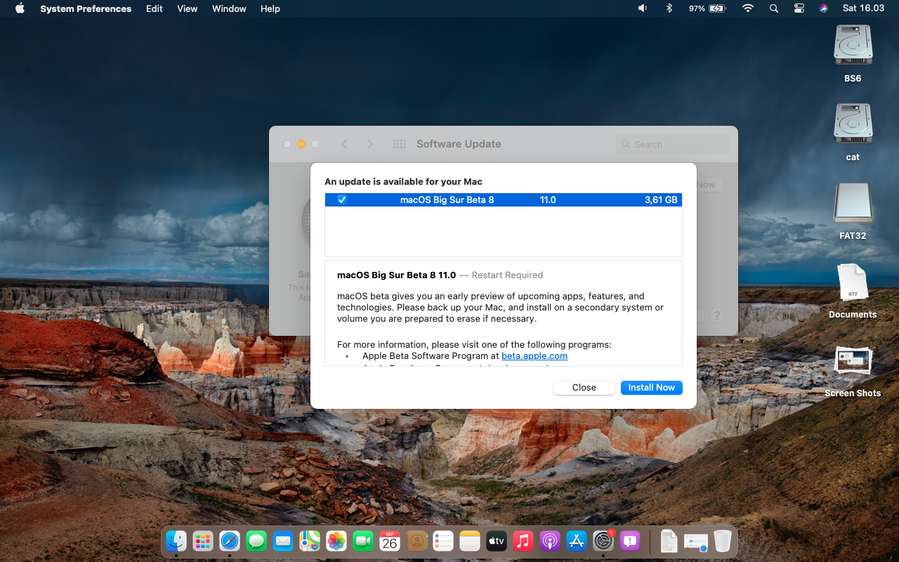

oh TQ..it's work!
oh TQ..it's work!

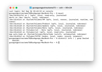

Even if it's downloading the small OTA it might not install and you get instead delivered an update of 11,51 GB that is also the beta 8 and you could try to install it, allow the "Preparing macOS Big Sur beta 8" to complete, meanwhile check from BigSur terminal:
mount
if the first output line shows a diskXs5s1
that means you are using a snapshot booting (of course it is because you can download a small OTA update)
diskutil info / | grep Sealed
If No means that you have an unsealed system (in few words mountable and writeable from other APFS macOS)
But as I wrote a snapshot booting (and sealed system) is required to complete the OTA update properly.

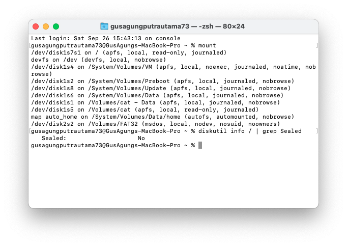

mount
it's show like you said
I add that when Sealed: Broken means that you can use sudo mount -uw / (even with a sealed system), but in this condition after opencore spoofing OTA update might not downloading or preparing (so it is still on beta 6), to run the OTA update smoothly apart a diskXs5s1 root as apple prefers the System should be Sealed , but this is not so relevant because when they release a full installer app updating process is more simpler.

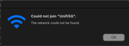

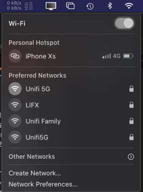

I still get this weird behaviour, didn't change, but Wifi overall seems to be more stable, might have been a bit more stable before I used your dev-v0.2.1 patch.
BTW, I hate the new Wifi Menu, before we could see all the networks in the Menu, now you have to click the other networks button to see the networks near you.
Just before my Wifi was connected to "LIFX", if I try to connect to one of my other networks from the Wifi Menu Bar I get the dreaded Could not join "X" network, LIFX was in the preferred networks in System Preferences, I uncheck the checkbox and then it allows me to connect to another one of my own without problem, weird stuff.
