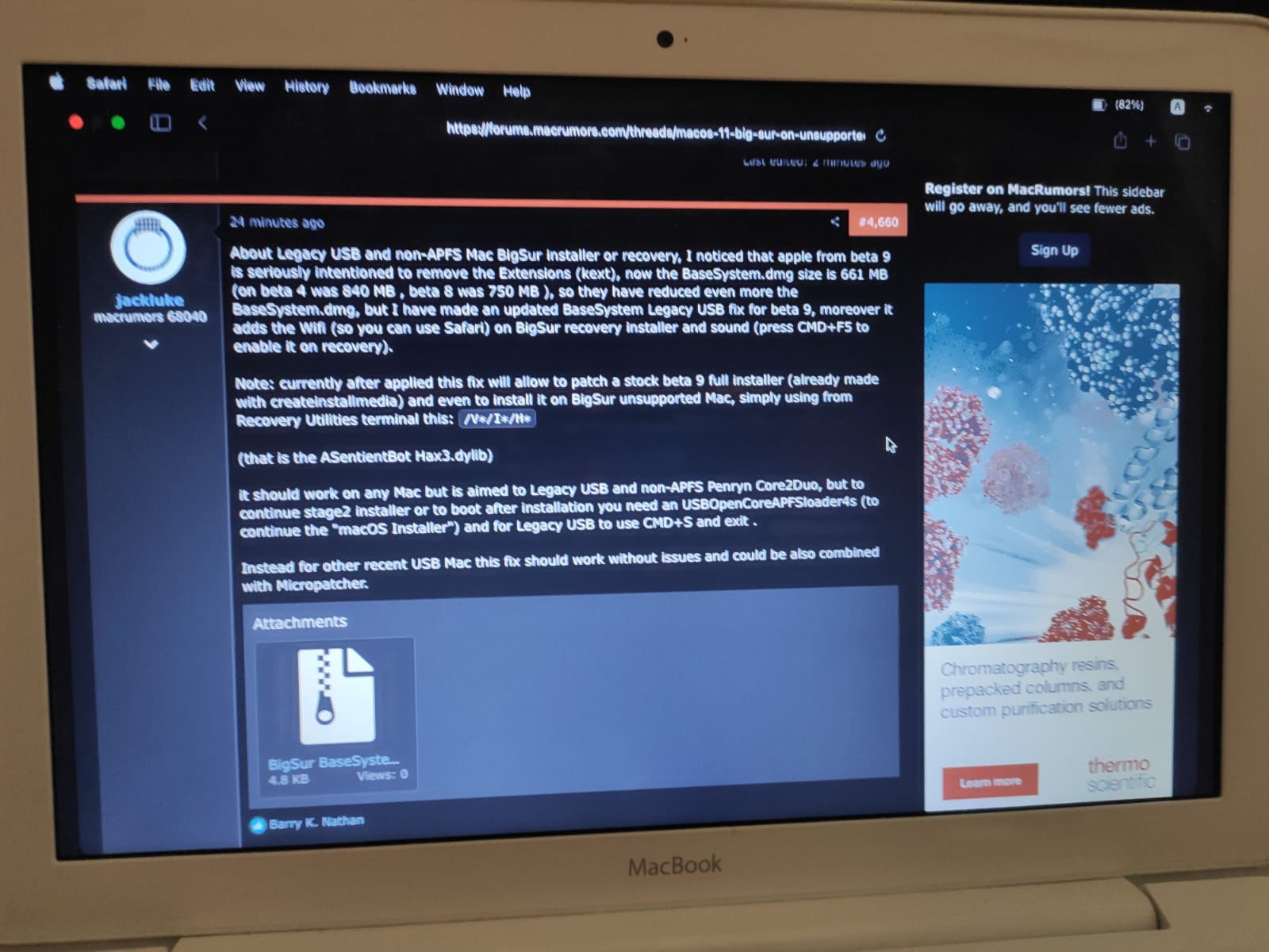

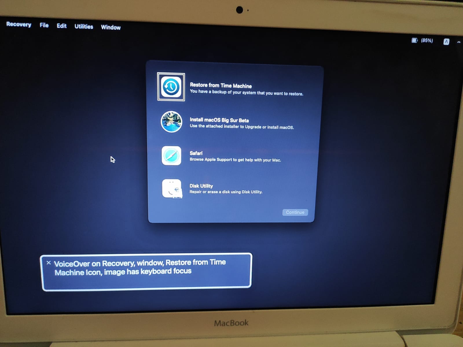

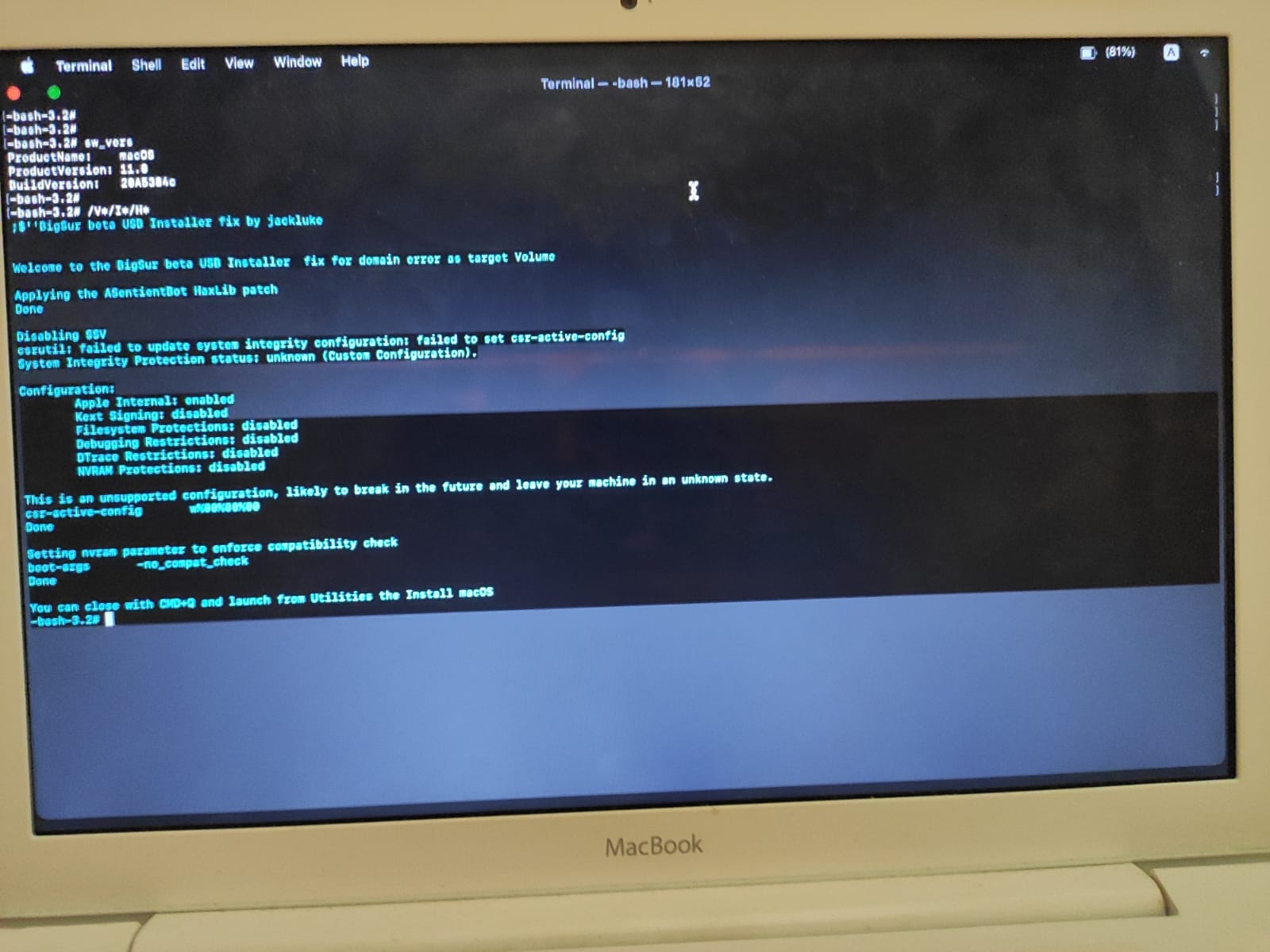

About Legacy USB and non-APFS Mac BigSur installer or recovery, I noticed that apple from beta 9 is seriously intentioned to remove the Extensions (kext), now the beta 9 BaseSystem.dmg size is 661 MB (on beta 4 was 840 MB , beta 8 was 750 MB ), so they have reduced even more the BaseSystem.dmg, but I just made an updated BaseSystem Legacy USB fix for beta 9 , moreover it adds the Wifi (so you can use Safari) on BigSur recovery installer and sound (press CMD+F5 to enable it on recovery).
First requirement is that from any macOS Recovery terminal at least set csrutil disable
Then get an "Install macOS Big Sur Beta.app" (currently beta 9 InstallAssistant.pkg) making a stock apple USB BigSur installer with this method:
Code:
sudo /Applications/Install\ macOS\ Big\ Sur\ Beta.app/Contents/Resources/ createinstallmedia --volume /Volumes/YourUSBLabel
then apply the "BigSur BaseSystem b9 legacy usb fix" , after unplug and plug again your USB drive and apply the "BigSur BaseSystem b9 legacy usb fix2".
After made you can boot from a Penryn Core2Duo non-APFS or legacy USB Mac the USB BigSur Installer from apple startup manager or USBopencore, then upgrade or install it on BigSur unsupported Mac, simply typing from Recovery Utilities terminal this: /V*/I*/H*
(that is abbreviation for /Volumes/Image\ Volume/Hax3.sh based on ASentientBot Hax3.dylib)
It should work on any BigSur capable Mac but is aimed to Legacy USB and non-APFS Penryn Core2Duo, to continue stage2 installer or to boot after installation you need a non spoof version of USBOpenCoreAPFSloader4s1.zip (to detect the "macOS Installer") and for Legacy USB to use CMD+S and exit (this check is required to have responsive usb input devices and concurrently a BigSur USB external installation).
Instead for other recent USB Mac this BaseSystem fix should work without efforts and could be also combined with Micropatcher.

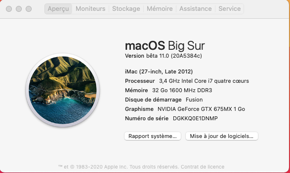

Wow! You did it! It works like a charm! I just installed beta 9 on my iMac without any problem, and even the wifi works! Thank you so much, Barry!!

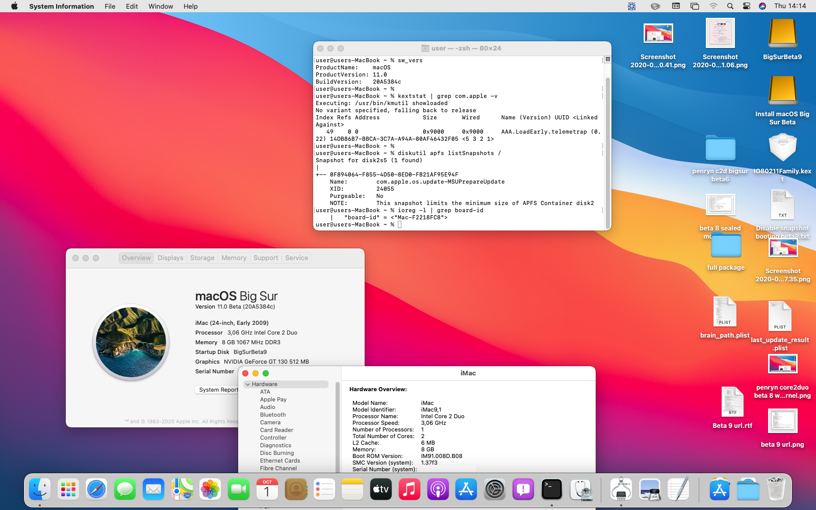

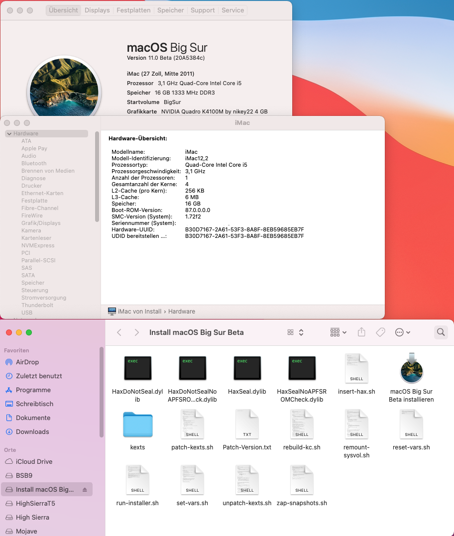

Success with Big Sur Beta 9 on an iMac 2011/metal GPU with a slightly different work plan
  1. Download Installassistant.pkg.
  2. Download @Barry K. Nathan Micropatcher 0.3.1.
  3. Create USB installer with createinstallmedia.
  4. Run Micropatch.sh in Terminal
  5. Restart into Installer, called the set-vars.sh command in terminal because I did not read the changed docs.
  6. installer started, installed and finally had a successful login
Did not patch the iMac so far, have to fix the patch script first - WIFI is running oob with the BCM94360CD
EDIT: Do not use this method ignoring the install-setvars.sh! Follow the docs @Barry K. Nathan provides on GitHub!

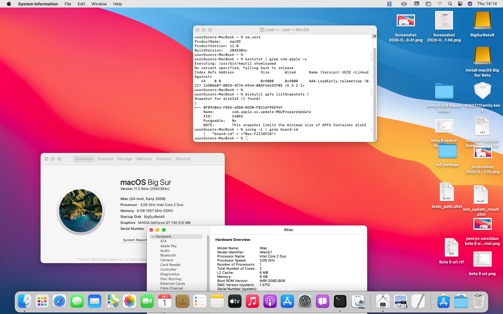

Currently it would be more easy for the few users ( single user) of the K1100M/K610M/K2100M to change their (his) config.plist on the Catalina Loader.
The current config.plist for Nvidia cards assumes the HD3000 to be installed on disk and injects only the BacklightFixup, FakeSMC, Whatevergreen, Lilu - so you left already the "standard" - how shall I catch up with all these possible configurations? H.264 iGPU acceleration does not work with injected HD3000.
But you are free to edit the script and change some lines to delete whatever you do not need.

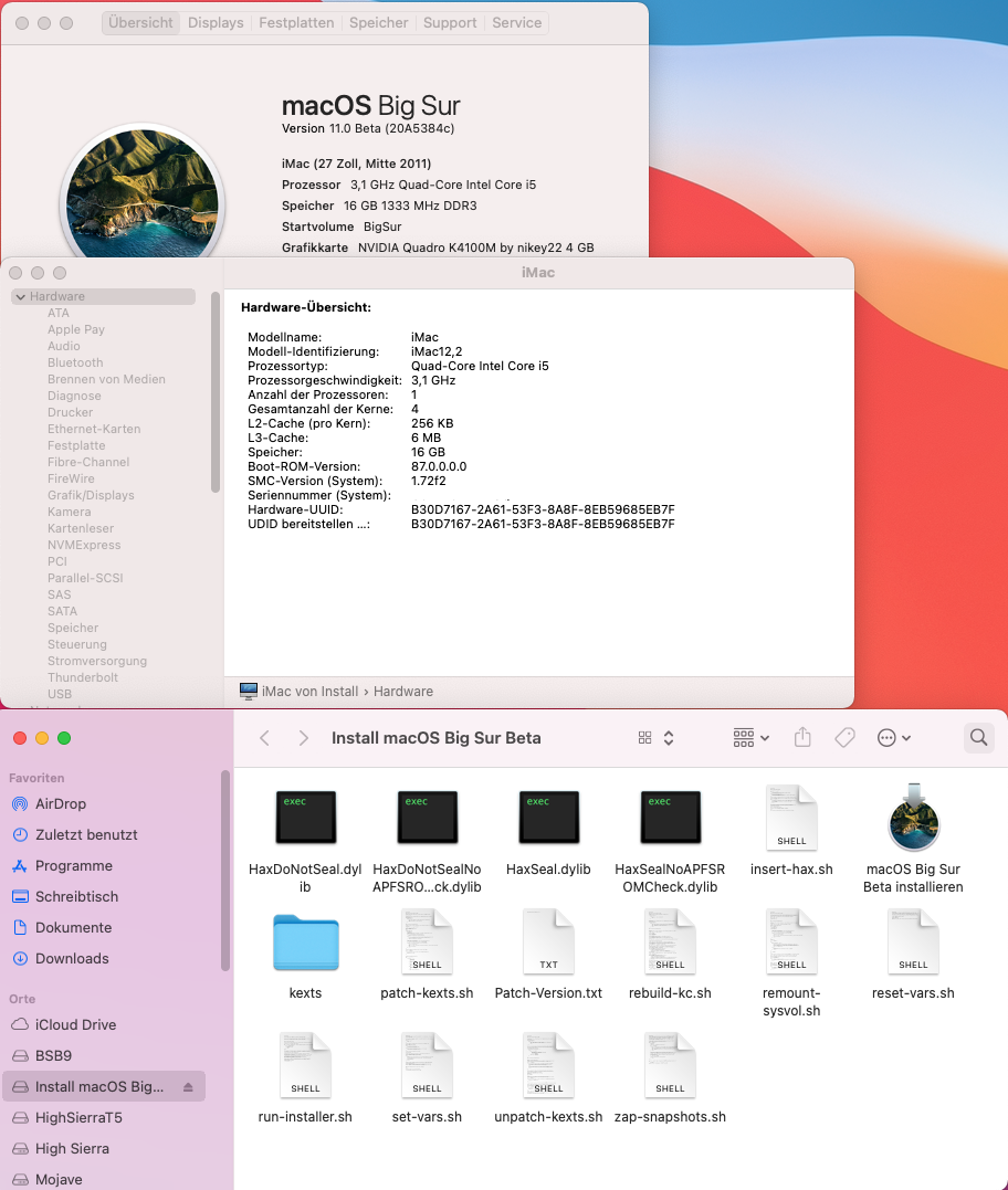

Big Sur Beta 9 on iMac 2011 with metal enabled graphics cards
Would you mind letting me know which kexts need to be added? I should probably add them to my patcher as an option like --2011-imac or --2011-imac-metal or something like that. (My recollection is that you've posted about that in the past, so a link to a previous post is fine, if that information is still current. I tried searching, but I was having some trouble, and anyway I want to make sure I make the changes based on up-to-date information and not something that's outdated and incorrect.)
I would love this!
Let me first change your script (adding just a few lines) and do a final test if all this still works with your latest 0.3.1 patch-kext.sh version. There are some changes from 0.10 to 0.3.1. It would be easy to see the changes using plain diff or some more sophisticated source code control software.
install@T5-BSB9 Install macOS Big Sur Beta % ./patch-kexts-iMac.sh --no-wifi --iMac --2011
Password:
Disabling WiFi patch (--no-wifi command line option)
Enabling 2011 iMac patch (--iMac command line option)
Using --2011 mode.
Installing kexts to:
Volume appears to have a Big Sur installation (build 20A5384c). Continuing.
Volume is mounted from device: /dev/disk6s5s1
Mounted device is a snapshot. Will now mount underlying volume
from device /dev/disk6s5 at temporary mountpoint:
/var/folders/zz/zyxvpxvq6csfxvn_n0000000000000/T/tmp.U1l641gF
Checking for KernelCollections backup...
Backup not found. Performing backup now. This may take a few minutes.
Backing up original KernelCollections to:
/var/folders/zz/zyxvpxvq6csfxvn_n0000000000000/T/tmp.U1l641gF/System/Library/KernelCollections/KernelCollections-20A5384c.tar.lz4
a BootKernelExtensions.kc
a SystemKernelExtensions.kc
Installing High Sierra AppleHDA.kext
Installing High Sierra Intel HD 3000 kexts
Installing LegacyUSBInjector.kext
Installing Catalina AppleBCM5701Ethernet.kext
Installing highvoltage12v patched iMac-2011-family.kext
NVIDIA Kepler based graphics adapter found
Using stock NVIDIA compatible version of AppleIntelSNBGraphicsFB.kext
Using kmutil to rebuild boot collection...
Using kmutil to rebuild system collection...
Copying deferred prelinked kernels in /private/var/folders/zz/zyxvpxvq6csfxvn_n0000000000000/T/tmp.U1l641gF...
/AppleInternal/BuildRoot/Library/Caches/com.apple.xbs/Sources/kext_tools/kext_tools-692.40.6/kc_staging.m.279: Encountered error while inspecting path: Error Domain=NSCocoaErrorDomain Code=260 "The folder “PrelinkedKernels” doesn’t exist." UserInfo={NSFilePath=/private/var/folders/zz/zyxvpxvq6csfxvn_n0000000000000/T/tmp.U1l641gF/Library/Apple/System/Library/PrelinkedKernels, NSUserStringVariant=(
Folder
), NSUnderlyingError=0x7fd3de506110 {Error Domain=NSOSStatusErrorDomain Code=-43 "fnfErr: File not found"}}
Folder
), NSUnderlyingError=0x7fd3de70f250 {Error Domain=NSOSStatusErrorDomain Code=-43 "fnfErr: File not found"}}
Copying KCs in /private/var/folders/zz/zyxvpxvq6csfxvn_n0000000000000/T/tmp.U1l641gF...
System Volume UUID: 078F6D13-9764-4E11-A9EF-507A0C6E9250
Volume Group UUID: 5D8C8B7A-A669-467F-B892-D4E51334109E
Preboot disk: /dev/disk6s2
Preboot volume: /System/Volumes/Preboot
Copying: /private/var/folders/zz/zyxvpxvq6csfxvn_n0000000000000/T/tmp.U1l641gF/System/Library/KernelCollections/BootKernelExtensions.kc.elides -> /System/Volumes/Preboot/5D8C8B7A-A669-467F-B892-D4E51334109E/boot/System/Library/KernelCollections
Copying: /private/var/folders/zz/zyxvpxvq6csfxvn_n0000000000000/T/tmp.U1l641gF/System/Library/KernelCollections/BootKernelExtensions.kc -> /System/Volumes/Preboot/5D8C8B7A-A669-467F-B892-D4E51334109E/boot/System/Library/KernelCollections
Creating new root snapshot.
Attempting to unmount underlying volume (don't worry if this fails).
This may take a minute or two.
umount(/private/var/folders/zz/zyxvpxvq6csfxvn_n0000000000000/T/tmp.U1l641gF): Resource busy -- try 'diskutil unmount'
Volume BigSur on disk6s5 failed to unmount: dissented by PID 0 (kernel_task)
Installed patch kexts successfully.
Made the test and it works with your current 0.3.1 micro patcher. Added the single package I created before and the new and renamed script to this post.
I simply added an --iMac option and in my special case having an iMac 2011 with a metal enabled GPU and an upgraded WIFI BCM94360CD this call patch-kext-iMac.sh --2011 --iMac --no-wifi does the trick.
For all users of an (metal GPU enhanced) iMac 2011 having only the old Atheros WIFI card I assume the correct call would be simply patch-kext-iMac.sh --2011 --iMac.
Notes:
  • Patching has to be done from the booted BigSur using the terminal command line. There is a call/hack to the system_profiler to get info about the installed GPU.
  • Currently I did only a single test with the 2009/2010 iMacs. The micro patched Apple installer switches off the machine after a few seconds.
  • I could not make the installer work directly on the iMacs having a metal AMD Polaris based GPU. The lack of the EFI boot screen makes it nearly impossible to to this. Possibly the USBopencore may work to circumvent this problem.
  • The attached file iMac2011Family-highvoltage12v.zip has to be copied into the kexts folder on the patched USB installer. The modified shell script has to be copied onto the patched USB installer directly side by side with the original file. If you cannot make it run use the chmod +x patch-kext-iMac.sh from the terminal before. Just change the to the installer directory.
Edit:
  • Updated patch-kexts-iMac.zip, fixed error and deleted Whatevergreen and Lily from installation in case of AMD cards. The third case needs a new command line argument (CL)
  • Updated extension zip
Notes:
  • Currently I did only a single tests with the 2009/2010 iMacs. The micro patched Apple installer switches off the machine after a few seconds.
  • The BCM94360CD works out off the box with BT and WIFI, but I had to enable Continuity manually.
