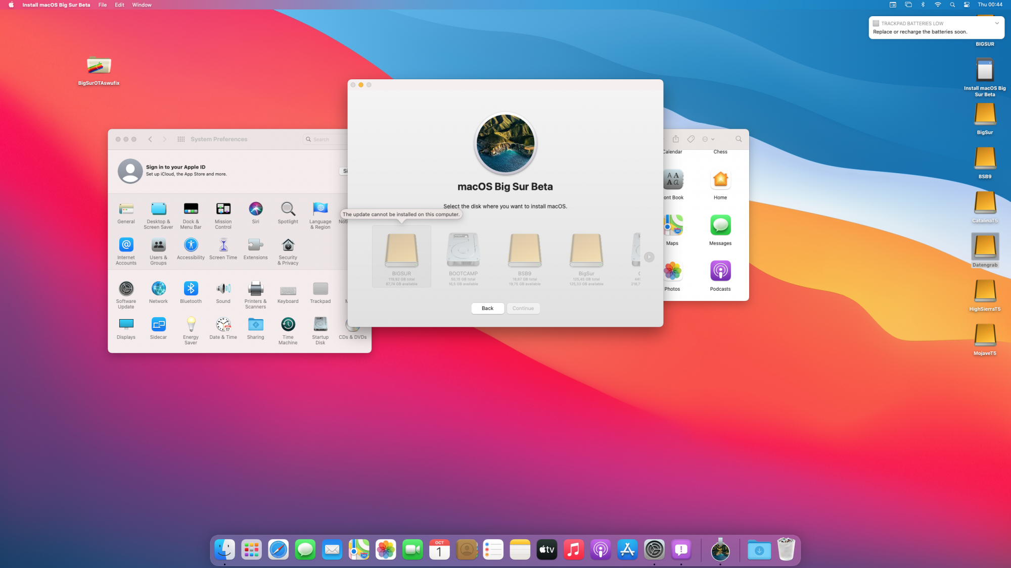

EDIT:
This did not work! Could not boot into BigSur using the USBopencore - forbidden sign all the time, regardless which crs and boot-args settings I used.

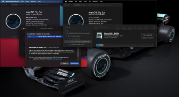

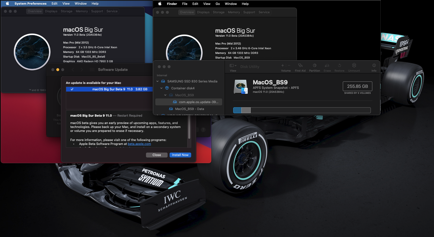

First big thank you jackluke for creating the USBOpencore4S1.
I used jakeluke USBOpencore4s1 to update my cMP mid 2012 BS Beta6 to Beta9.
https://forums.macrumors.com/thread....2242172/page-179?post=28952250#post-28952250
  1. Boot with Option/alt key hold down via OpenCoreAPFSLoader4s1 USB and choose your drive.
  2. Run the software update, the package Beta9 is 3.82 GB. This will take awhile to preparing/installing.
  3. Again boot with Option/alt key hold down via OpenCoreAPFSLoader4s1 USB and choose 'macOS Installer’.
  4. If normal boot grey screen with prohibited sign, you need to boot in Recovery Terminal (command+R) => nvram boot-args="-no_compat_check”. If unable you may use Cat or Big Sur USB installer.
  5. Again boot with Option/alt key hold down via OpenCoreAPFSLoader4s1 USB and choose 'macOS Installer’.
  6. Now wait for software update finished.
  7. Unable to boot without OpenCoreAPFSLoader4s1 USB. You must reboot with OpenCoreAPFSLoader4s1 USB, and follow jakeluke commands at link below.
https://forums.macrumors.com/threads/macos-11-big-sur-on-unsupported-macs-thread.2242172/page-181
