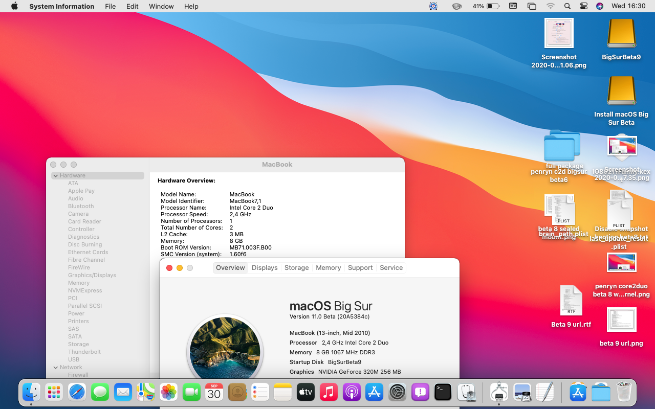

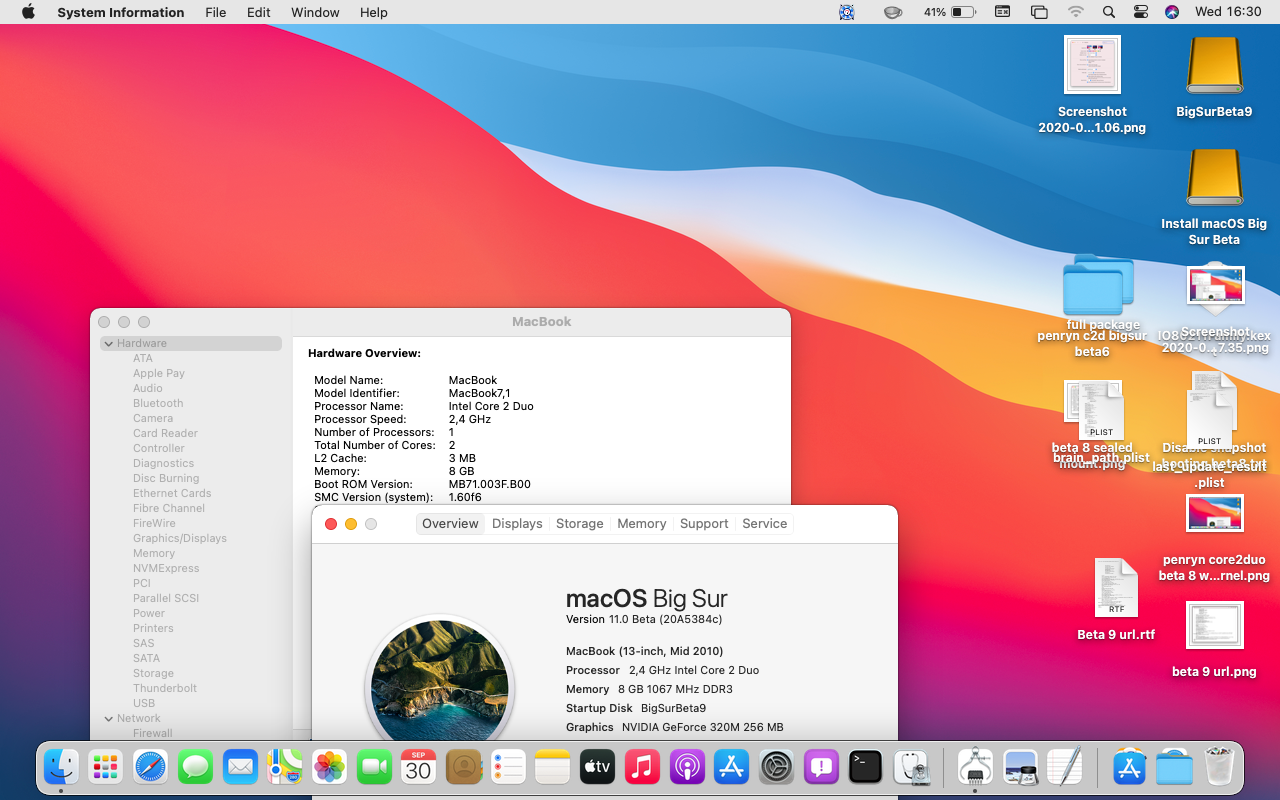

@ASentientBot seems beta 9 kernel (compiled by apple on September 25 ) can boot Penryn Core2Duo, so it's no more required a downgrading to beta 6.
