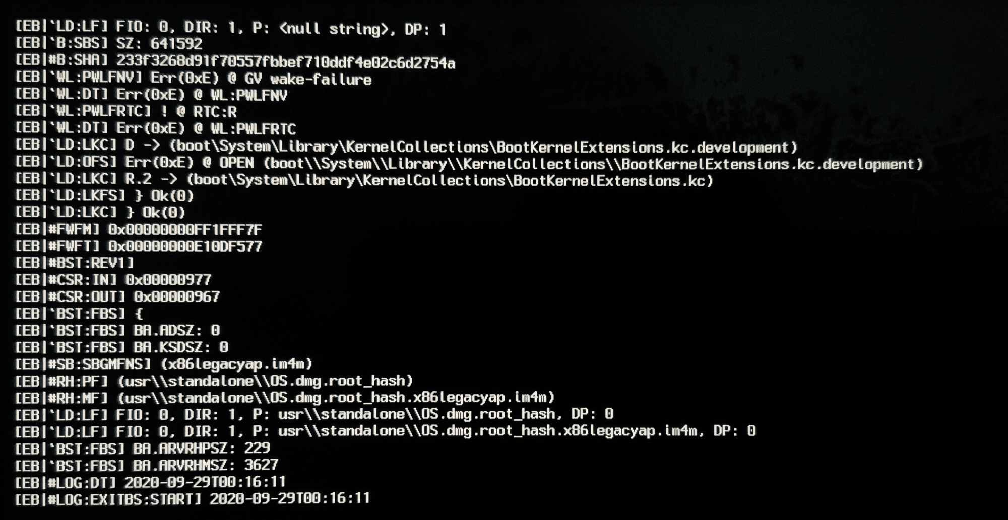

About Penryn Core2Duo Legacy USB and non-APFS Mac, I patched a beta 8 BaseSystem.dmg and it still works with my BaseSystem Legacy USB fix (so this eventually could be used as BigSur Recovery for non-APFS Mac), but to continue the staged installer is required USBopencore and a replacement of patched BKE on these paths:
/APFS Data Volume/macOS Install Data/Locked Files/BootKernelExtensions.kc
/APFS Data Volume/boot/BootKernelExtensions.kc
/APFS Preboot/UUIDBigSur/boot/System/Library/KernelCollections/BootKernelExtensions.kc
Thanks to @ASentientBot method downgrading the beta 6 kernel and an updated version of usbopencore I was able to boot with CMD+S and exit on a non-APFS Mac (legacy USB) the beta 8 through an external USB SSD installation .
I uploaded the patched BKE that embeds beta 8 extensions and beta 6 kernel here: https://github.com/jacklukem/BigSurfixes/tree/master/penryn c2d bigsur beta6
because a beta 6 kernel is required to boot BigSur with Penryn Core2Duo.
Meanwhile I attach the updated usbopencore that is not for spoofing or OTA updates, but mainly to inject some legacy kext on the BootKernelExtensions.kc still experimental and legacy USB booting works only with CMD+S and exit (stock Recovery 11.0 beta 6 also works, I'd advise to keep a beta 6 BaseSystem.dmg copy).
To use the bootloader simply copy the EFI folder to any FAT32 formatted volume, then reboot with alt-option key and select EFI Boot.

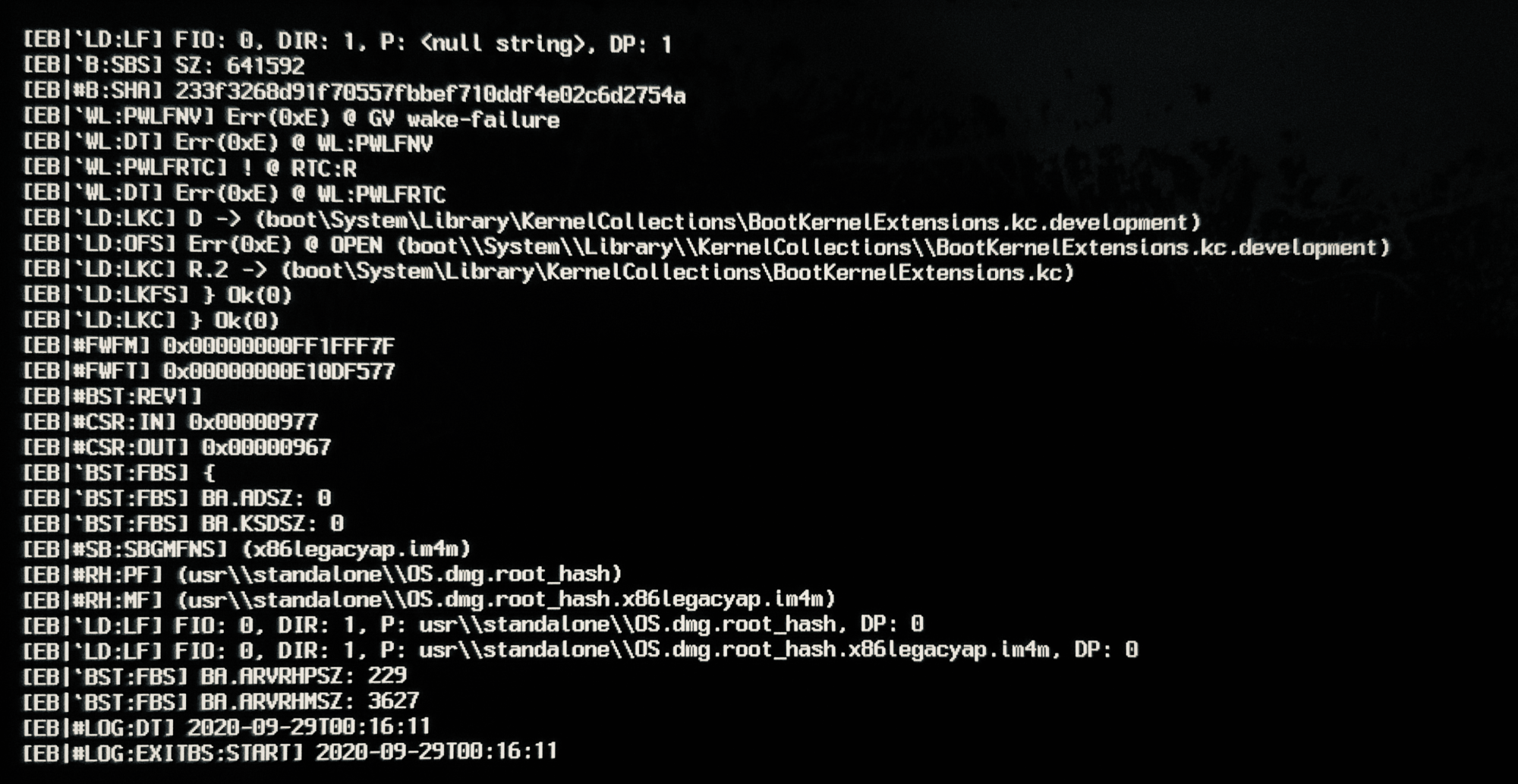

Thank you! Very interesting as always :)
BTW using different csr-config giving a different error number. Does anyone realize that?
In general, we are getting 66 but when I try to 67000000 then I got 77. is that mean if we can find the correct csr we can pass the disk read/write?
Note: I know this is a stupid idea. 😊

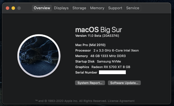

I just installed Beta 6 on my MacPro5,1 and updated to Beta 8 w/OpenCore 0.6.1. Previously running Catalina 10.15.7. Apple Watch unlocking is working too to my surprise. The only thing that is broken right now is DRM for tv shows/movies.

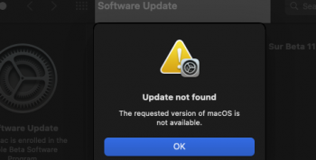

I did that
But I get this error again

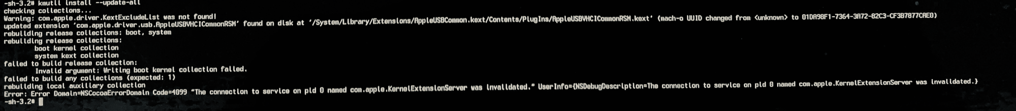

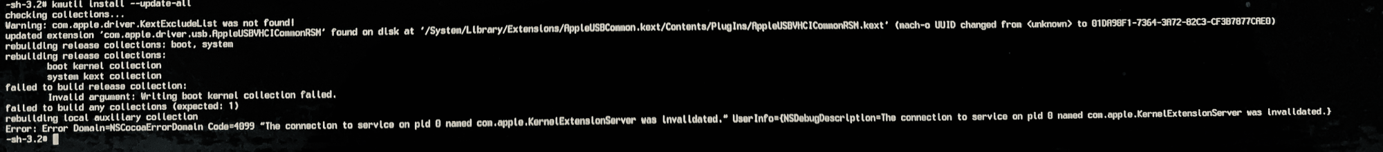

I have tried to follow the instructions. When I am executing kmutil install --update-all , it shows that it failed to build release collection, as shown
When I boot with USBopencore, I stuck with apple logo
kindly, any suggestion ?
Regardless of that error, do you typed also kcditto before reboot to opencore ?
If you did and stuck there, then try this updated USBopencore: https://forums.macrumors.com/thread...unsupported-macs-thread.2242172/post-28952250
