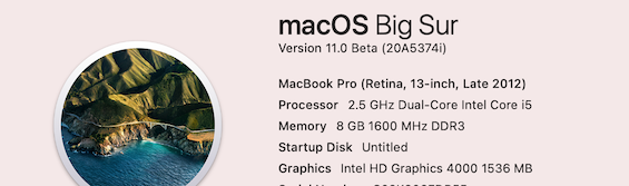

After being pointed in the right direction by @jackluke, I've got an *unpatched* Big Sur beta 8 running on a Late 2012 Retina MBP. I did not use big-sur-micropatcher or in any way patch the downloads, it relies on @jackluke's id spoofing and on manually setting -no_compat_check when needed.
I think this could be applied to any Mac where the only incompatibility with Big Sur is that the Wi-Fi card needs to be upgraded (and I think that means late 2012 and early + mid 2013 retina MPBs only?).
Here's a screenshot. :
To install unpatched Big Sur beta 6:
  1. Upgrade the physical WiFi card on your Mac, to either of BCM94360CS or BCM94360CSAX (worth noting as a positive side effect of this, I found this gives much more reliable Bluetooth pairing than the original component)
  2. Make a USBopencore4s1 Mac id spoofing disk from @jackluke's zip file
  3. If you're happy to install in place over your existing OS then simply: enroll your Mac in the beta program; boot your existing OS via USBopencore, go to 'About This Mac/Software Update...' (and untick auto-update if ticked); you should be offered the beta upgrade and can upgrade in place, but you'll have to adapt the remainder of these steps yourself
  4. If you want to install onto a separate partition (recommended):
  5. Create a partition to install onto (min. 35Gb is recommended)
  6. Create an SSD partition to install from (13.5Gb is needed for macOS beta 6); this is normally done using a USB, not a partition, but I could not get OpenCoreAPFSLoader4s1 on a USB to successfully boot another USB (maybe I just didn't wait long enough?); though this means setting up more partitions, it at least has the advantage that creating the install media and installing from it is quicker than with a USB
  7. Get hold of the Big Sur beta 6 download package, and run createinstallmedia from it onto the 13.5Gb partition
  8. Boot holding down ⌘, select OpenCoreAPFSLoader4s1, then select your (unpatched) install partition in the next screen
  9. At a certain point this will try to reboot into a 'macOS Installer' partition, and you will get a 'no entry' sign
  10. Set -no_compat_check as follows (which you will also need to do again later, after receiving the OTA update): reboot holding down ⌘+R, wait for recovery mode, open a terminal, enter the command nvram boot-args="-no_compat_check"
  11. Reboot (without using OpenCoreAPFSLoader4s1), allow to complete, you should now have a running, unpatched macOS beta 6
To receive the OTA update to beta 8:
  1. Boot into Big Sur via OpenCoreAPFSLoader4s1
  2. Go to Software Update; now that your id is spoofed by booting via USBopencore, you should see the update available; get it
  3. For me it went through 'An Update is Available' and 'Preparing...' twice, but it only downloaded the update once (downloading ~3.6Gb). Preparing this update takes quite a long time.
  4. When it comes to restarting during the update, be *sure* to boot into the temporary 'macOS Installer' partition (which has been made for you by the beta 8 updater) using OpenCoreAPFSLoader4s1 (I rebooted into the main Big Sur partition, without using USBopencore, and ending up having to fetch the update all over again; I'm not sure whether that's because I went into the wrong partition, or because I didn't use USBopencore, or both)
  5. At a certain point this will reboot again and show a no entry sign: set -no_compat_check again, as above, reboot (without using OpenCoreAPFSLoader4s1) and allow to continue
  6. You should now have a completely unpatched macOS beta 8
