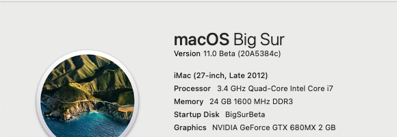

Hello to all,
Successful instalation of Big Sur Dev. Beta 9 on 13,2 iMac 27" using BarryKN's micropatcher 0.3.2.
I did have to reboot into BigSur USB installer, after original installation, and apply "patch-kexts.sh" to activate WiFi.
I was reminded of this WiFi-activation procedure by justperry's post#4702. Thank you.
Thereafter, all functions are available and system remains stable.

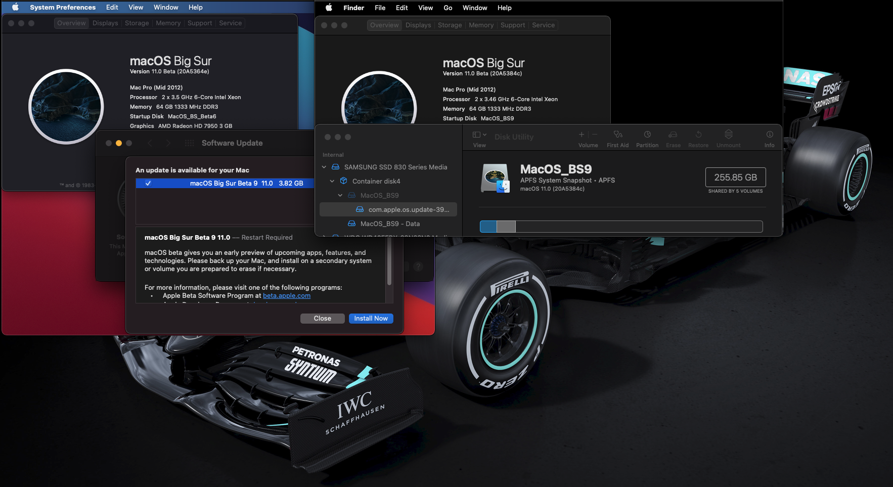

I been away after Beta6 and now try to catchup reading...
First big thank you jackluke for creating the USBOpencore4S1.
I used jakeluke USBOpencore4s1 to update my cMP mid 2012 BS Beta6 to Beta9.
https://forums.macrumors.com/thread....2242172/page-179?post=28952250#post-28952250
  1. Boot with Option/alt key hold down via OpenCoreAPFSLoader4s1 USB and choose your drive.
  2. Run the software update, the package Beta9 is 3.82 GB. This will take awhile to preparing/installing.
  3. Again boot with Option/alt key hold down via OpenCoreAPFSLoader4s1 USB and choose 'macOS Installer’.
  4. If normal boot grey screen with prohibited sign, you need to boot in Recovery Terminal (command+R) => nvram boot-args="-no_compat_check”. If unable you may use Cat or Big Sur USB installer.
  5. Again boot with Option/alt key hold down via OpenCoreAPFSLoader4s1 USB and choose 'macOS Installer’.
  6. Now wait for software update finished.
  7. Unable to boot without OpenCoreAPFSLoader4s1 USB. You must reboot with OpenCoreAPFSLoader4s1 USB, and follow jakeluke commands at link below.
https://forums.macrumors.com/threads/macos-11-big-sur-on-unsupported-macs-thread.2242172/page-181
