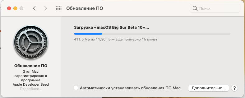

Updating my MacMini 2012 late - 11,36 Gb

can it be done by software update? I'm with beta 9. I have a 2012 iMac and can't find an update. Do you have to do something to update like on your Mac? sorry for my English
Boot from this USB, go to System Pref, download update, wait too long for prepare update and on every reboot hold ALT to boot from this USB and choose Preboot volume, then after second reboot this USB then your BS volume until you finally update your Mac, then boot from EFI from Barrys Micropatcher https://github.com/barrykn/big-sur-micropatcher and then normal boot to Big Sur. Its simple )))

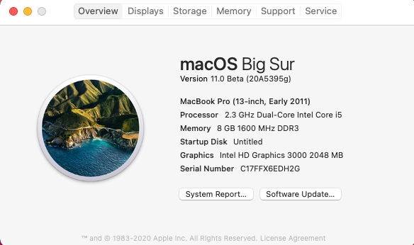

wertico
macrumors newbie
Jun 27, 2013
29
7
Done
But they make a small change in a file
And update for the operating system key
However, the main bugs have not been fixed with 10 new versions
And it still has time to install or run a semi-heavy program or run a virtual keyboard crashing and bad regiments
This operating system has a great beauty
But all people are looking for a new version of Big Sur
So that maybe the bugs will be fixed and they will enjoy the beauty
But nothing special happens
And I don't think the original version will solve the problems either
In any case, thank you View attachment 966762

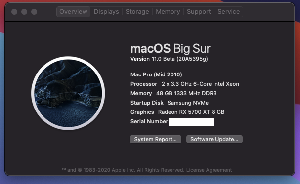

That method didn't work for me. The 'Install Data' folder mentioned wasn't on my USB installer after Stage 1. However, the following worked for me - to update from b9 to b10. [edit: JackLuke's #5102 post didn't show up on my system until after I posted this, so mine is more or less the same experience - but I'll leave this up, all the same]
1. Download b10 full delta update file and unzip.
2. Create a b9 'createinstallmedia' USB installer if you haven't already done so.
3. Apply Barry K. Nathan's 0.4.1 micropatcher.sh and install-setvars.sh to the USB installer.
4. Reboot to USB EFI, then USB Installer and progress through Stage 1 (about 15 minutes on my cMP 2010).
5. At auto-reboot (no chime!), hold Opt and select 10.14 Mojave if available (maybe 10.12 or 10.13 would work too - but, for me, 10.15 Catalina will not show any of the folders in the next step at all. I couldn't get them to show up in any bash 'ls' list via Single User mode or similarly using the b9 Recovery's Terminal.app either).
6. Go to existing BS Data volume/macOS Install Data/UpdateBundle and overwrite the [b9] AssetData folder with the b10 one (select replace and not merge). Also replace the Info.plist file with the one from the unzipped delta folder.
7. Reboot to 'macOS Installer' (not the USB Installer) and allow it to run (about 30 minutes for me).
8. End up with an unsealed b10 (20A5395g), with one snapshot (which I'll [try to] delete from Recovery*).
*Some may be interested that I've created a 1GB HFS+ partition containing a reduced set of the unpatched 'Install macOS Big Sur Beta' USB files on it (including all of the hidden folders and files). My Mac setup doesn't seem to like booting into Recovery using Cmd-R, as I have 5 Mac OS's available to boot from (10.6/9/14/15&11.0), so I've created a quick-boot 'Base' BS volume to help manipulate the latest OS from the terminal. The main work-around, to reduce the total files size from 12GB+ to under 1GB, is to replace the SharedSupport.dmg (inside Install macOS Big Sur beta.app/C/MacOS/InstallAssistant.app/C/SharedSupport) with one created using Disk Utility of about 10MB in size, or however small you can make it. You have to bless the boot.efi file (inside the hidden S/L/CoreServices folder) for this 'base' OS to show up in the standard Mac boot menu. Also, make sure that the 'com.apple.Boot.plist' file (inside the hidden L/Pref/SysConfig folder) includes:
