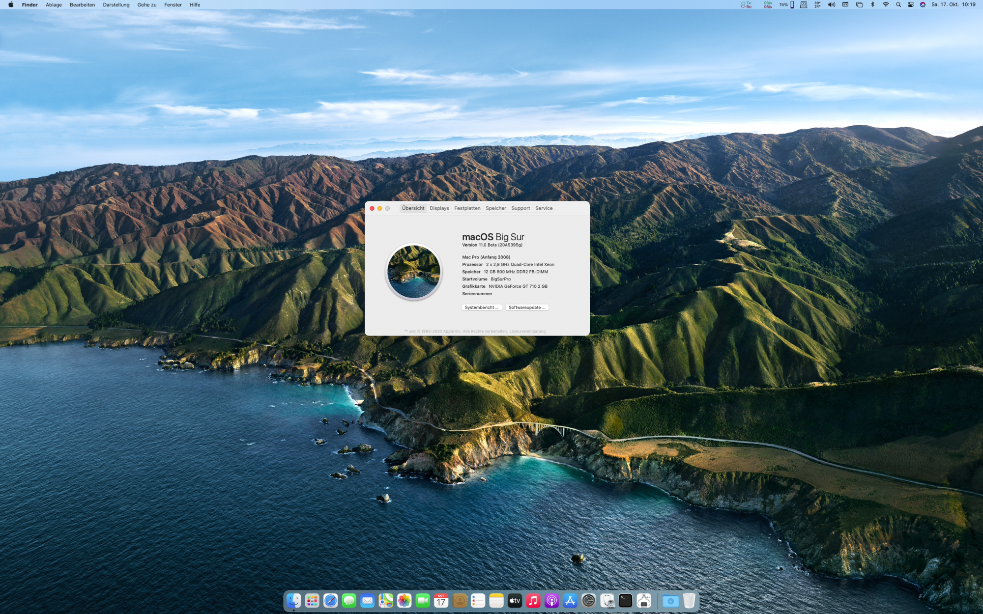

Yes, after the kexts patch. I patched it from the Big Sur not from the USBoot, and after restart the grey screen happened... So I rebooted from the USB, got into terminal and just used the bless command. After that rebooted a bit longer but with no problem and all working, wifi, airdrop and handoff ;)
the easier way is to patch without booting and directly apply the code. then boot and all is fine. Do it ditrectly from the usb drive after installing.

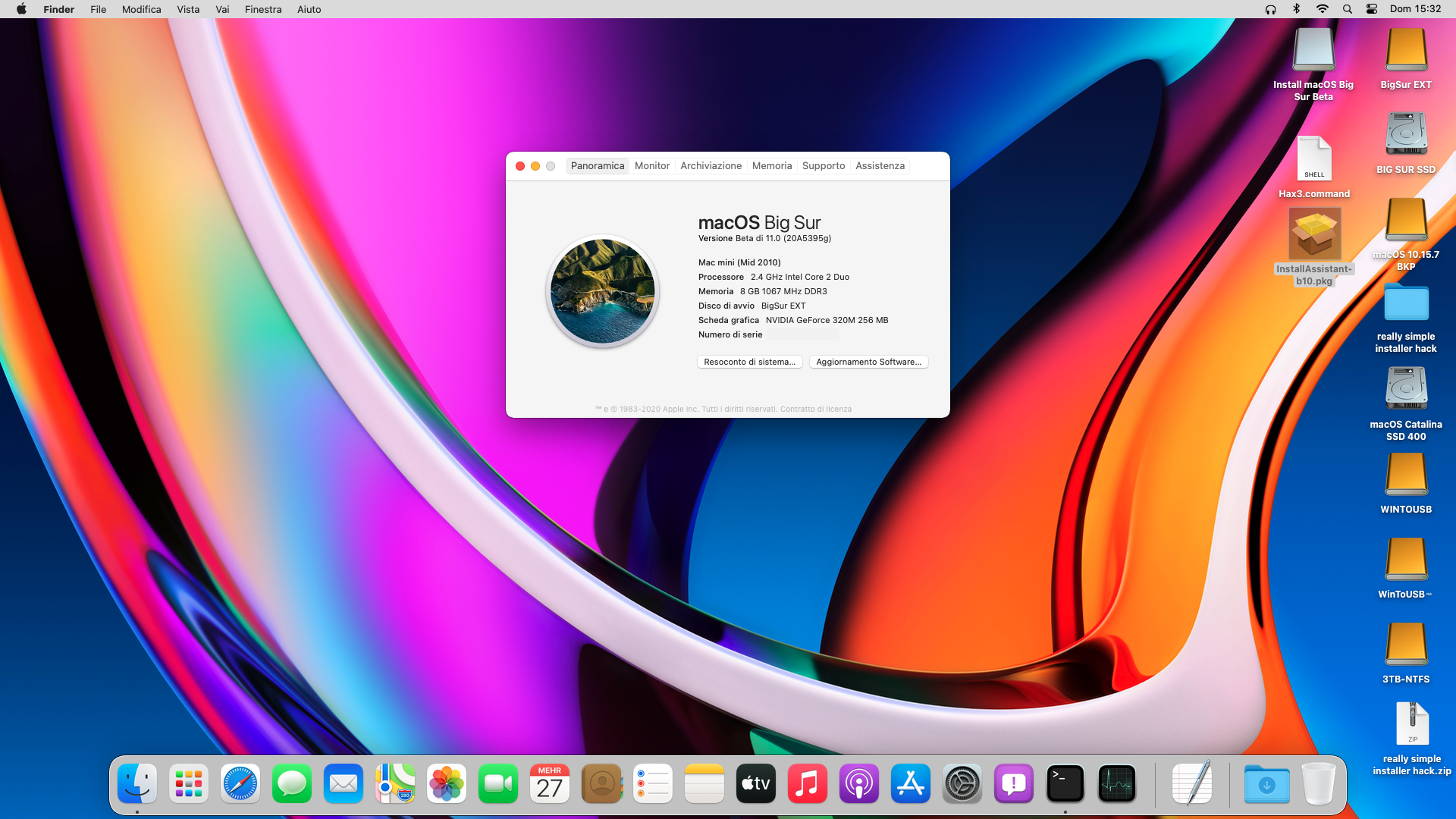

Success updating BS beta 9 to 10 on Macmini 2010. The only difference from Beta 9 seems the wallpaper 😂
using hax3 to install it from Catalina to avoid gray screen, then applying 0.3.2 USB micropatcher to remove telemetry.
@jackluke @Barry K. Nathan I have managed to rebuild kexts doing that as suggested by @Ausdauersportler from inside BS B10: https://forums.macrumors.com/thread...unsupported-macs-thread.2242172/post-28799574 If it could be used to inflate kexts on Core 2 Duo Penryn, but still no USB mouse and keyboard. Bluetooth, Wifi, internal audio, ethernet usb webcam and mic are OK.
1: APFS Volume ⁨BigSur EXT - Dati⁩ 15.2 GB disk7s1
2: APFS Volume ⁨Preboot⁩ 327.2 MB disk7s2
3: APFS Volume ⁨Recovery⁩ 655.1 MB disk7s3
4: APFS Volume ⁨VM⁩ 1.1 MB disk7s4
5: APFS Volume ⁨BigSur EXT⁩ 15.5 GB disk7s5
6: APFS Snapshot ⁨com.apple.bless.AB36...⁩ 15.5 GB disk7s5s1
alex@Mini-di-alex ~ % sudo mkdir /Volumes/ROOT
Password:
alex@Mini-di-alex ~ % sudo mount -o nobrowse -t apfs /dev/disk7s5 /Volumes/ROOT
alex@Mini-di-alex ~ % sudo chown -R 0:0 /Volumes/ROOT/System/Library/Extentions
alex@Mini-di-alex ~ % sudo chmod -R 755 /Volumes/ROOT/System/Library/Extensions
alex@Mini-di-alex ~ % sudo kmutil install --update-all --volume-root /Volumes/ROOT
checking collections...
Warning: com.apple.driver.KextExcludeList was not found!
updated extension 'com.promise.driver.stex' found on disk at '/Volumes/ROOT/System/Library/Extensions/PromiseSTEX.kext' (mach-o UUID changed from <unknown> to AE253556-66D8-38D2-B9D1-179B78F29153)
updated extension 'com.Areca.ArcMSR' found on disk at '/Volumes/ROOT/System/Library/Extensions/ArcMSR.kext' (mach-o UUID changed from <unknown> to 01FC5EBD-0A34-3E77-9216-53B89DDD8CE4)
updated extension 'com.apple.driver.usb.AppleUSBVHCICommonRSM' found on disk at '/Volumes/ROOT/System/Library/Extensions/AppleUSBCommon.kext/Contents/PlugIns/AppleUSBVHCICommonRSM.kext' (mach-o UUID changed from <unknown> to 983BD0E8-C3D2-3035-82FA-4791749754CB)
rebuilding release collections: boot, system
boot kernel collection
system kext collection
rebuilding local auxiliary collection
kmutil done

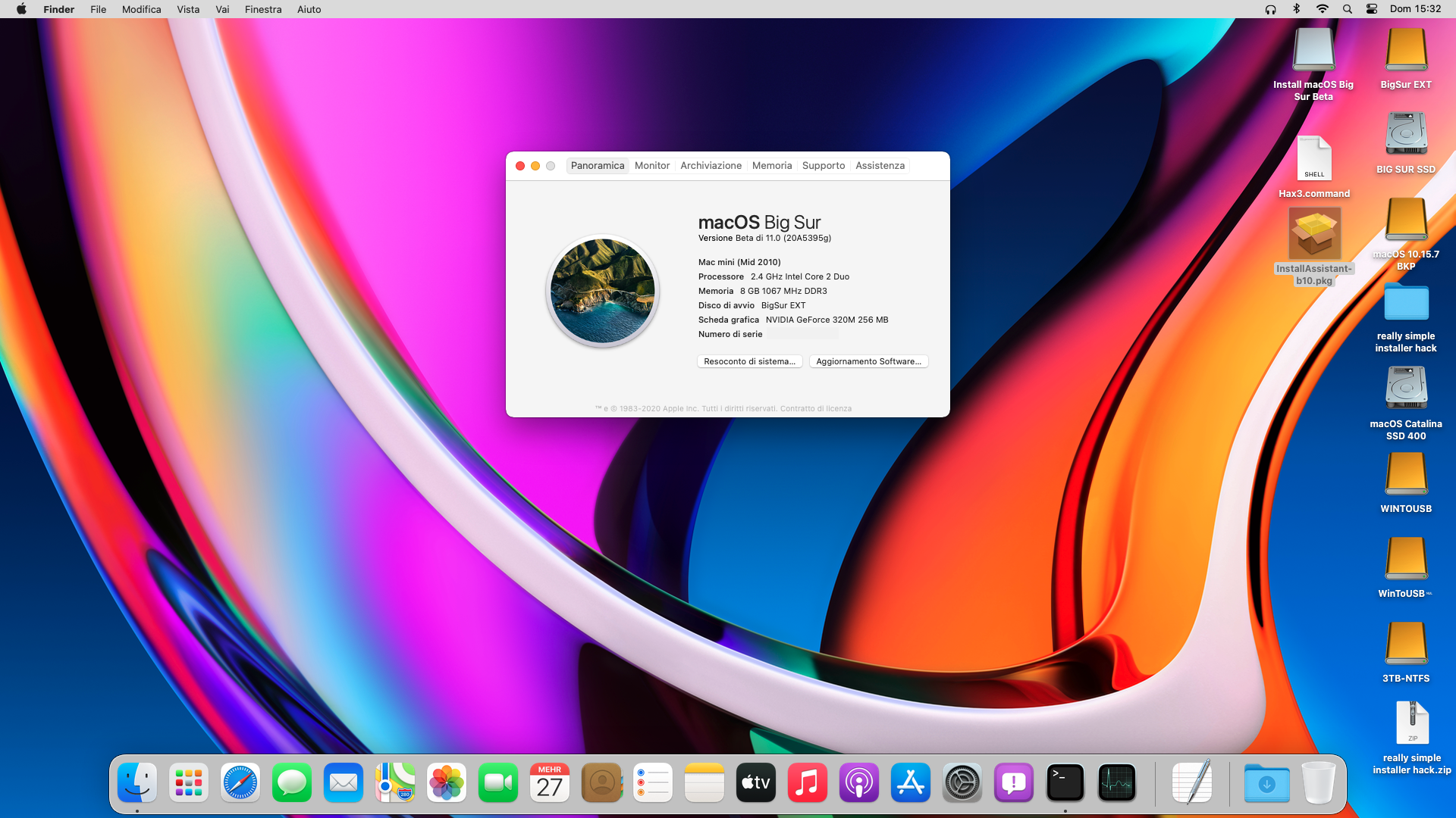

Password:
kmutil done
