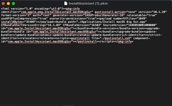

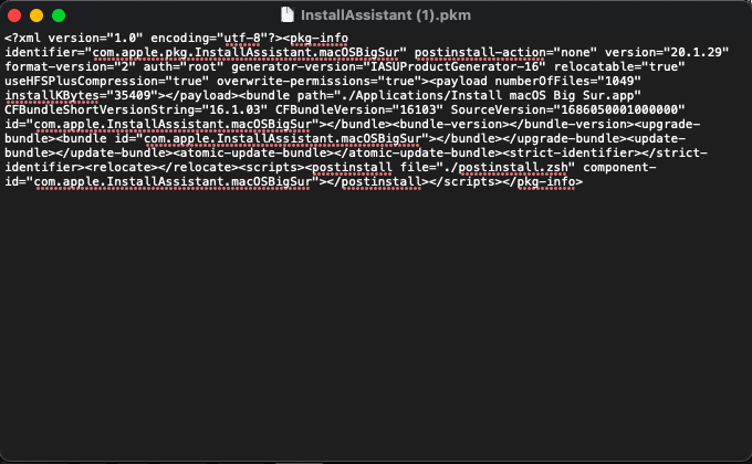

To download a full "Install macOS Big Sur.app", from Catalina as many reported can be used CatalinaOTAswufix, while if you are already on BigSur beta, since it's locked with snapshot booting, you should use this: https://forums.macrumors.com/thread...unsupported-macs-thread.2242172/post-28740283
The BigSurOTAswufix (should work also on Mojave HFS+) requires AMFI disabled (nvram boot-args="-no_compat_check amfi_get_out_of_my_way=1"), you can use this ASentientBot method and reboot:
Code:
sudo defaults write /Library/Preferences/com.apple.security.libraryvalidation.plist DisableLibraryValidation -bool true
After reboot just open BigSurOTAswufix and click "Software Update fix" button, don't worry it won't allow you to proceed with an OTA update or OTA full install, because the supported BigSur machine is not spoofed, after a reboot "Software Update" is again stock, so it just would let you to download a full install app from Software Update prefpane directly on the Applications folder.
edit:
if BigSur installer doesn't show from BigSur Beta try this:
sudo softwareupdate --fetch-full-installer --full-installer-version 10.16

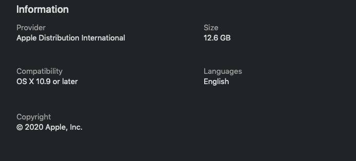

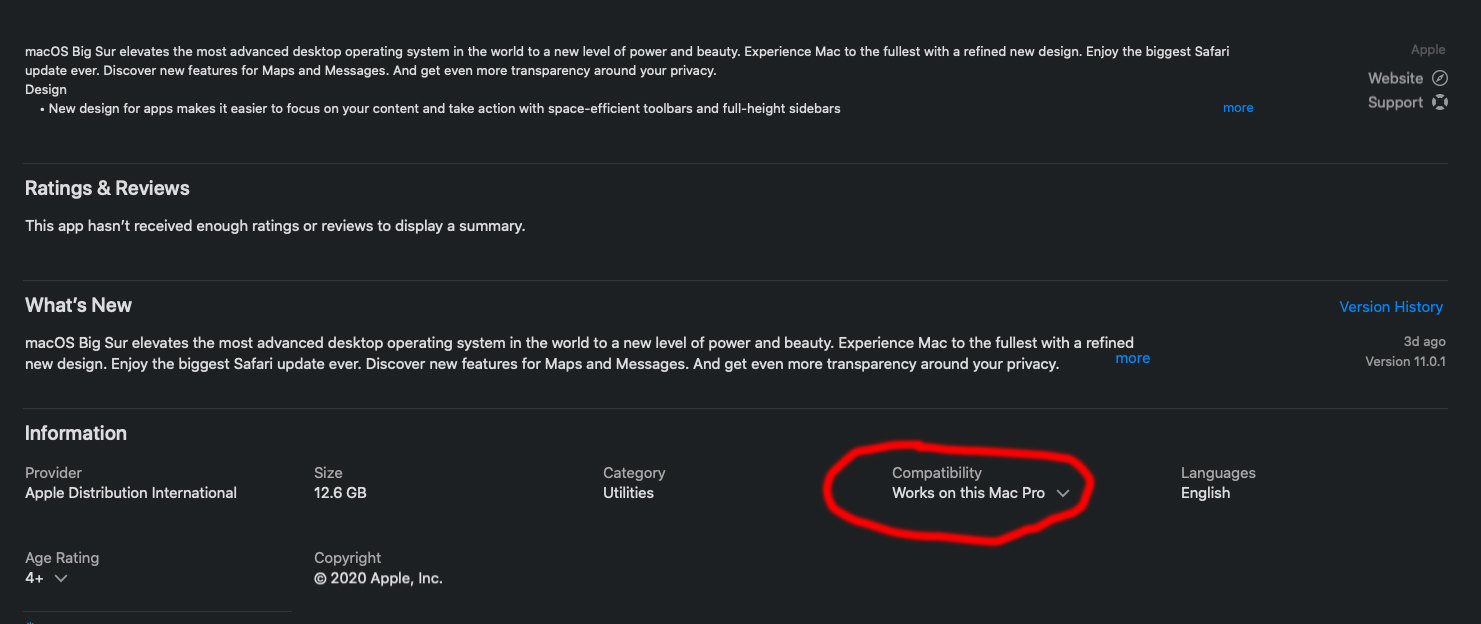

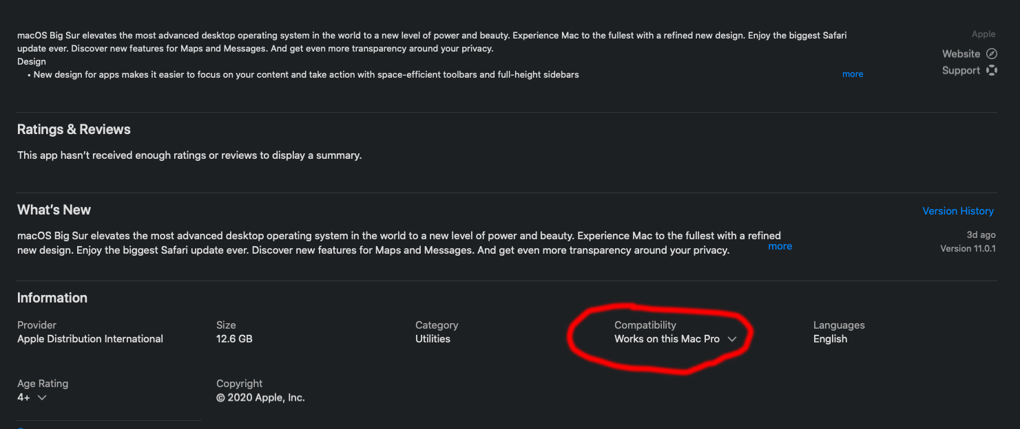

That's why I came to this thread, to see if Apple changed what was supported. I have a 2013 iMac that is unsupported and Apple is prompting me to download and install. The App Store page likewise saying it "Works on this Mac."
I have a 3.1 mac pro and it also says that for me, so I think it is just a glitch / mistake.
If you click on "Works on this Mac" it shows that it is for mac osx 10.9 or later. See the image below.
