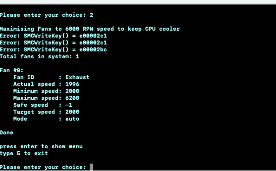

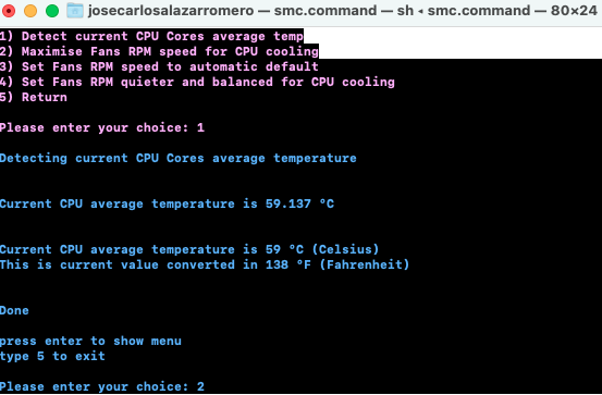

Right, BigSur since beta 1 caused on any unsupported Mac overheating (I have even a doubt that those few who EFI bricked instead of OTA spoofing was a logic board overheat), because smc sensors are not correctly detected (probably are required some additional kext), I made a simple app from BigSur recovery environment, based on this: https://github.com/hholtmann/smcFanControl
I attach also my customised shell app, run it directly from Downloads folder double click "smc.command" (use sudo -s and drag n drop in terminal) , for your MBP to detect average temperature use "CPU temp for Ivy Bridge" function.
Or you can use "Macs Fan Control" but "Auto" on BigSur won't work, just customise your CPU temperature range for adeguate RPM speed.
Thanks!! right now it looks normal, but im thinking there is something wrong with my fan... maybe disconnected?

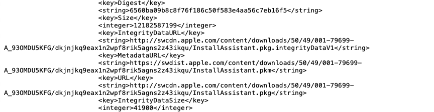

Download this
Next go to this
then RTFM. ;)
