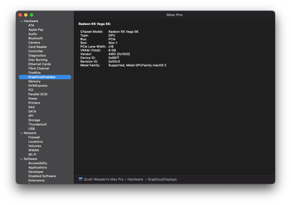

After doing this upgrade on my 2009 Mac Pro 4,1 -> 5,1 there is no video output. If I connect up using Screen Share the display is visible. The Graphics Card is not displayed in system information. Adding the original GT 120 card to the machine allows it to boot to the OS but is slow and pinwheels easily. During the boot the upper half of the display has purple lines before the entire display goes black. Any help is much appreciated!

Did you go to the Option Boot screen and run EFI to boot.This will set necessary NVRAM parameters. It should quickly turn off. Then restart with Option and select the installer partition.
Yes. Did that many times. No luck. Also tried booting Cmd-R into Recovery mode, then opening Terminal and typing this command sudo nvram boot-args="-no_compat_check"

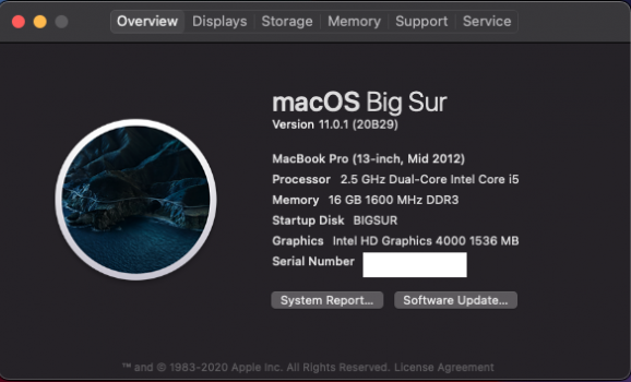

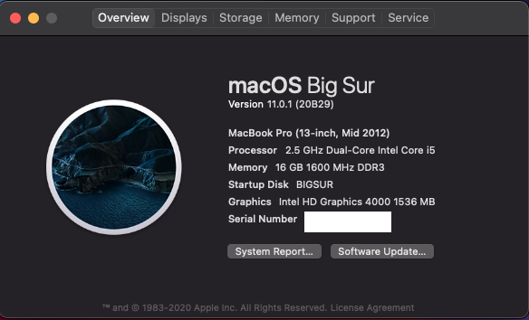

Upgraded successfully on my MacBook Pro 9,2 (13 inch, Mid 2012 model) using described USB instructions and kext patcher.
One thing I notice wrong straight off however, I cannot get an external display to connect using a thunderbolt to HDMI adapter where it worked in Catalina. Is this an already known limitation?

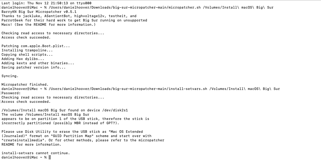

Late 2013 iMac
In Step 4. I Used Disk Utility to erase the USB stick using "Mac OS Extended (Journaled)" format but didn't find> "GUID Partition Map" scheme until I looked in the Apple UDZIF read only Media and I see Partition Map> GUID Partition Map. I'm lost now.
When I got to step 7 everything went fine and the I got this. How do I get to the GUID Partition Map part?
I don't see it anywhere.
I'm computer illiterate so I guess I need an easier how to or just forget it.

click on view in pull down arrow and select show all to see the partition other details. apple hides this for simplicity some OS version ago.
Is there any way to get external video to work off of a MBP 13 inch?
Reactions: TimothyR734
MacBook Pro Retina 15" Mid 2012: I'm still on 20B28, my external HDMI display is connected using Elgato Thunderbolt 2 dock and it works.

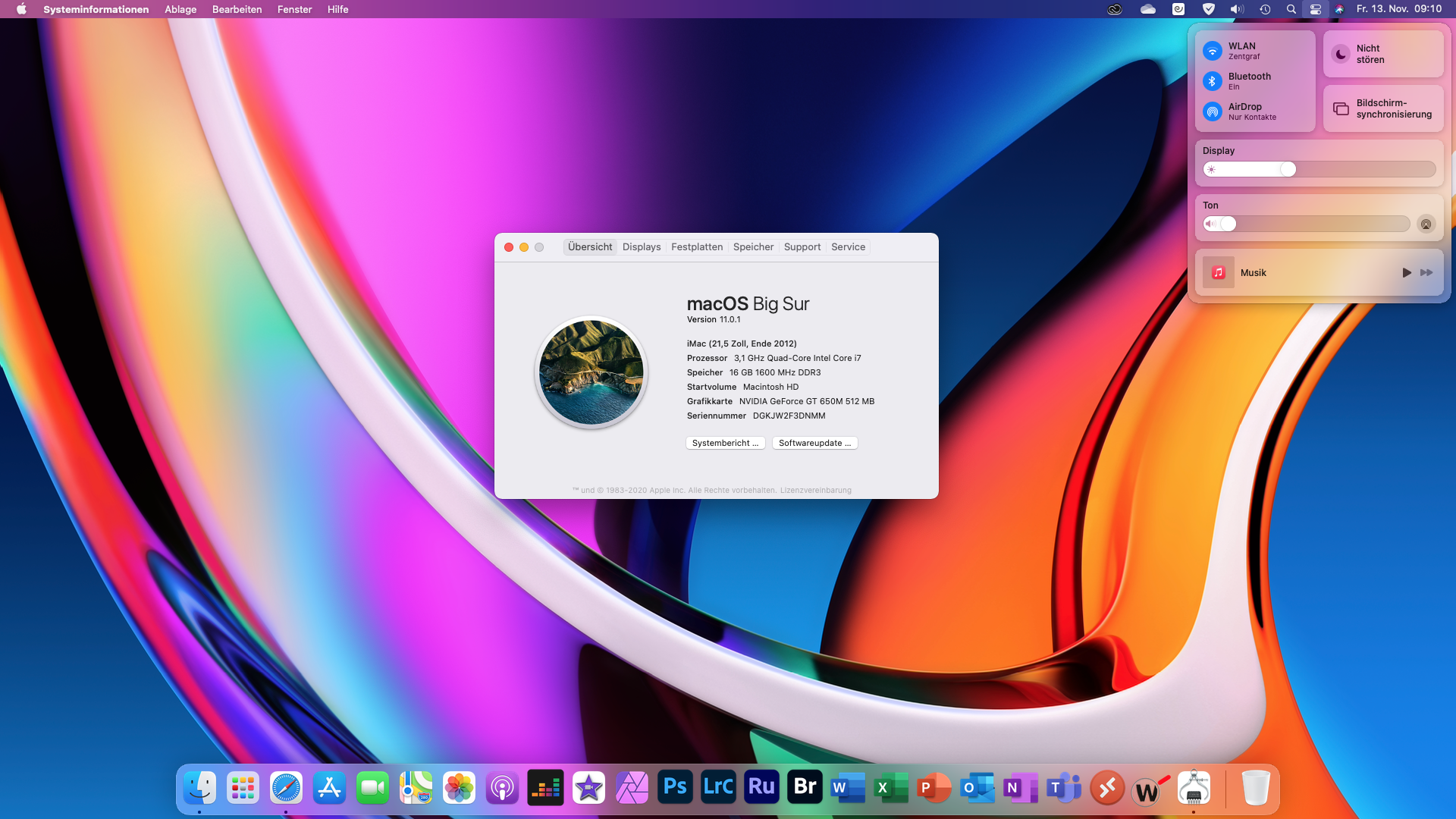

Well, I took the plunge and installed it on my main partition. And so far, it's running amazingly.
Thanks to all the devs who made this possible!! My Mac and I will enjoy another year of software updates that aren't just for security. :p

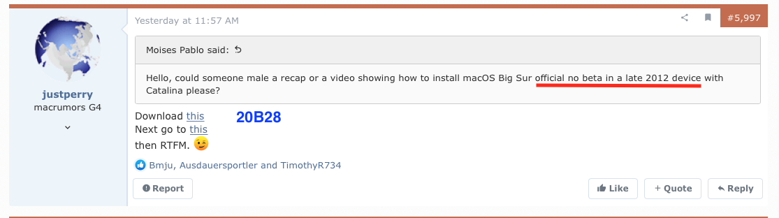

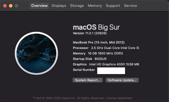

Hi all, iMac late 2012 here.
before I try to make it work on a half dead HDD (only SSD 128GB is alive)... I need to double check:
I downloaded wrong one haven't I? 20B28 (it should be 20B29 ?).
I guess the link shared was not final release but a beta? I am out of touch with everything, so if anyone able to share a working apple link of the latest pckg, it would be awesome.
