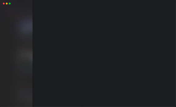

Status says it's A-OK now, does anyone have a good link to use for 11.0.1 InstallAssistant to download?
Well, i suppose it's not ok. This is like Mac App Store looks for me now.
Reactions: TimothyR734
