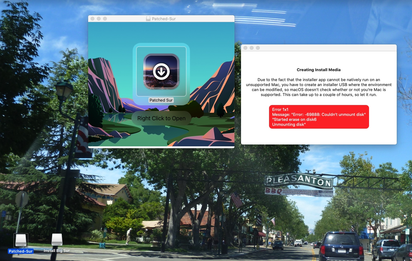

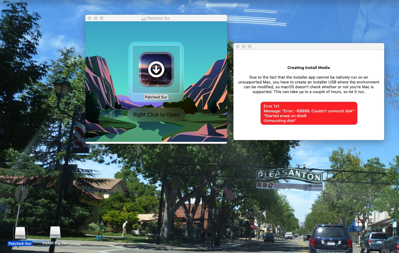

I can confirm same error message as above.......using the patcher> Im comfortable in terminal its not a biggie I just wanted to try to reproduce the issue. Its a no go for me. I even tried creating a patched installer on a used and brand new 32GB card on both a MacBook that support Catalina natively and my Mac Pro which is a 5,1. Same formatting error one both system with two different drives. Recommendation would be go open core if your not comfortable using terminal or barrykns micro patcher until this one is fixed.
Reactions: TimothyR734

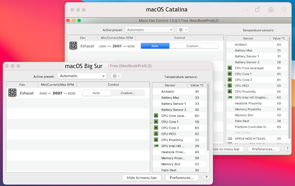

Open BigSur terminal, type sudo -s , then drag and drop "smc.command" in terminal window, and it should work, for your MBP use "CPU temp for Ivy Bridge".
For MBP mid-2012, they have found temperature changes between Catalina and Big Sur?
(it has been mentioned in the thread, problems since BS b1)
I have applied the jackluke instruction, the keyboard does not heat up quickly anymore.
wi-fi... and smc??

ok I don't know what fixed it those of you who are getting that error message with unable to mount drives. If you boot into safe mode it works perfectly fine. I was also getting this same message with dosdudes patcher in the early days of Catalina when it came to making the install. Im not an expert by any means but I think it has something to do with the patched legacy usb kexts.

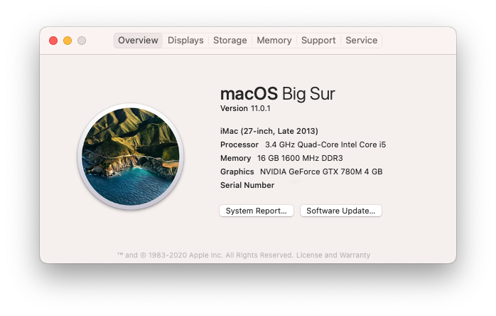

Late 2013 - 27 iMac
installation went smoothly and with out issues:
1. there was a warning when i first logged in about optimizing (how long does it take, how can i track it, or see what is happening?
anyone experienced this issue or alert ??
thx

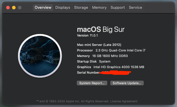

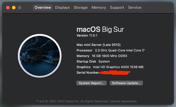

Thanks to all who made this possible! Performed an in-place upgrade to Big Sur on my 2012 Mac Mini. Even the wifi patching was incredibly painless. Computer is running extremely smoothly on an 512GB Intel SSD and the other specs listed above.
Yes it does, it still amazes me why the heck it's unsupported, especially since the internals are comparable to the 2012 MBP which was sold until November 2012 which should be supported by Apple but didn't either.
Big Sur runs like a charm on these macs.
