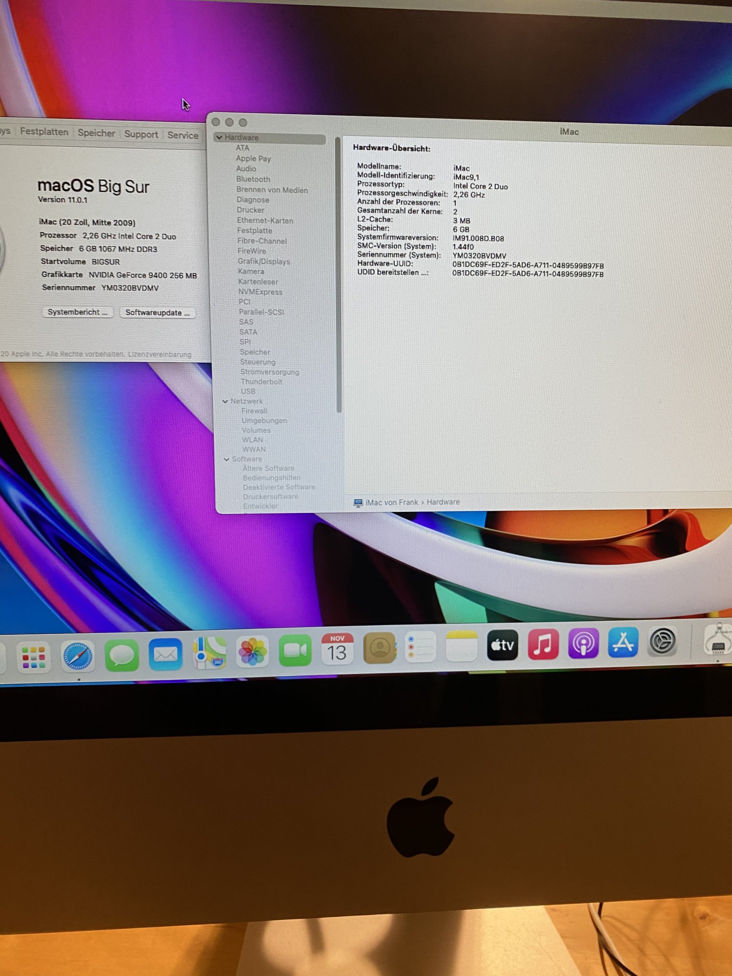

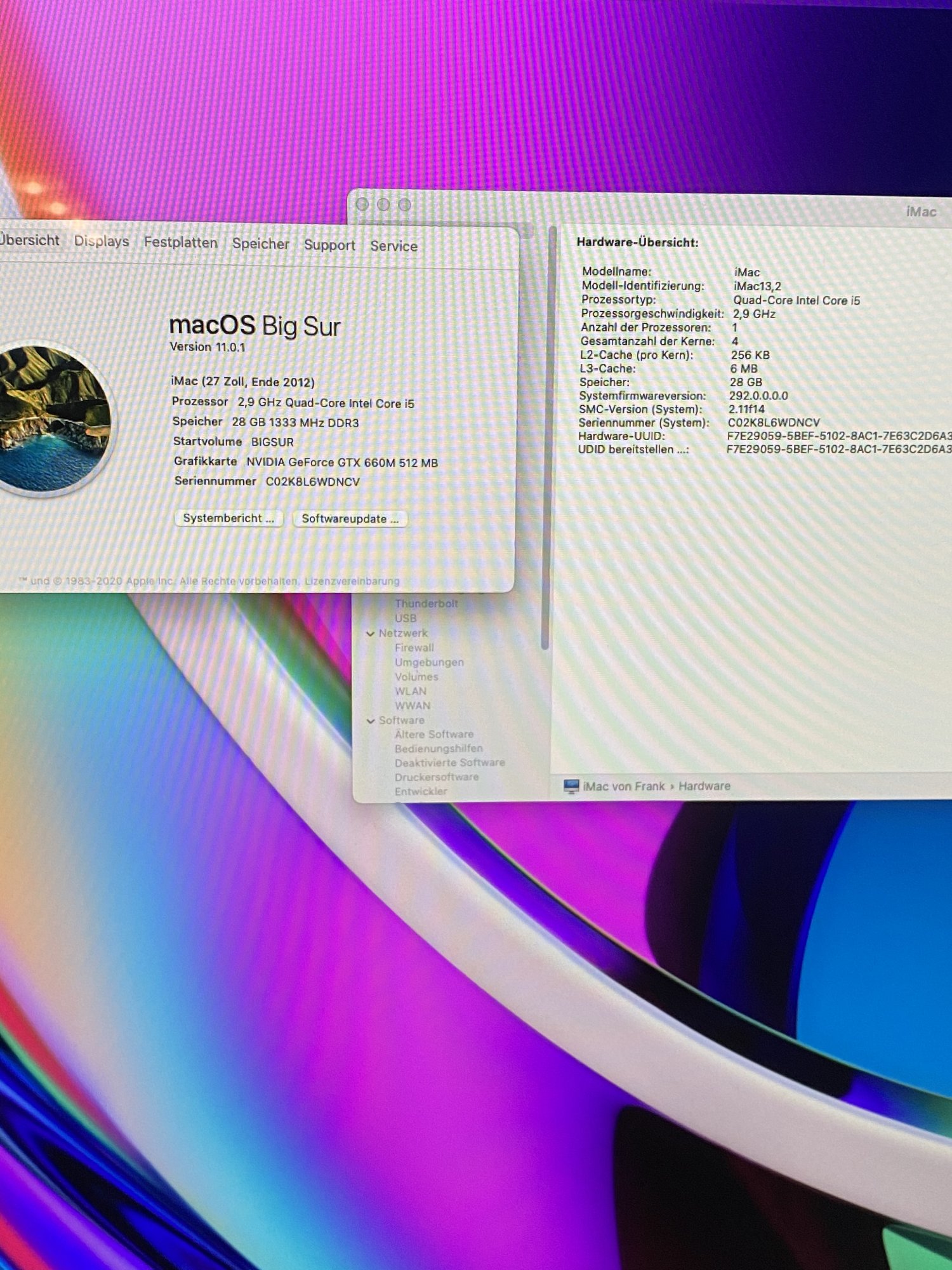

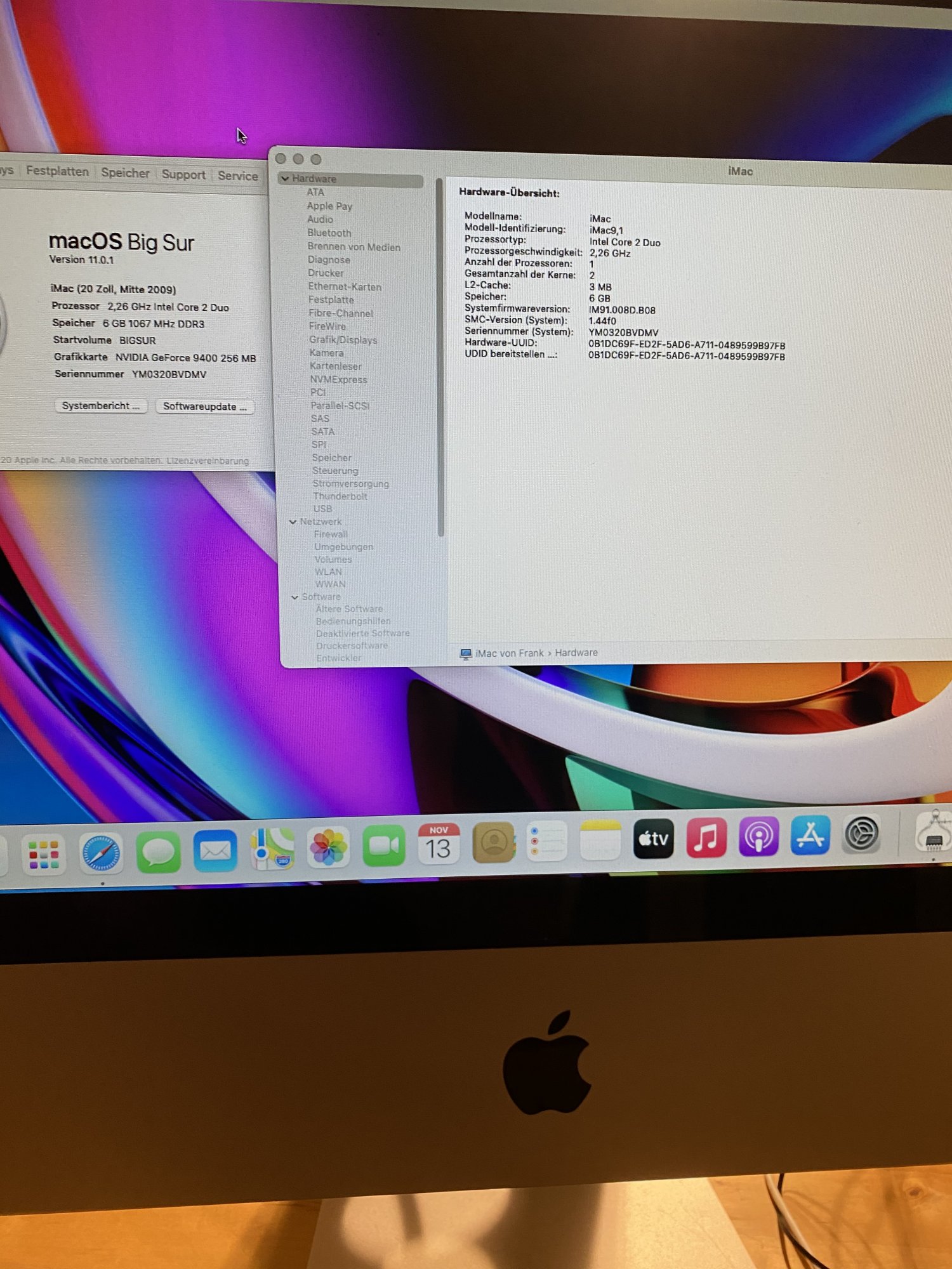

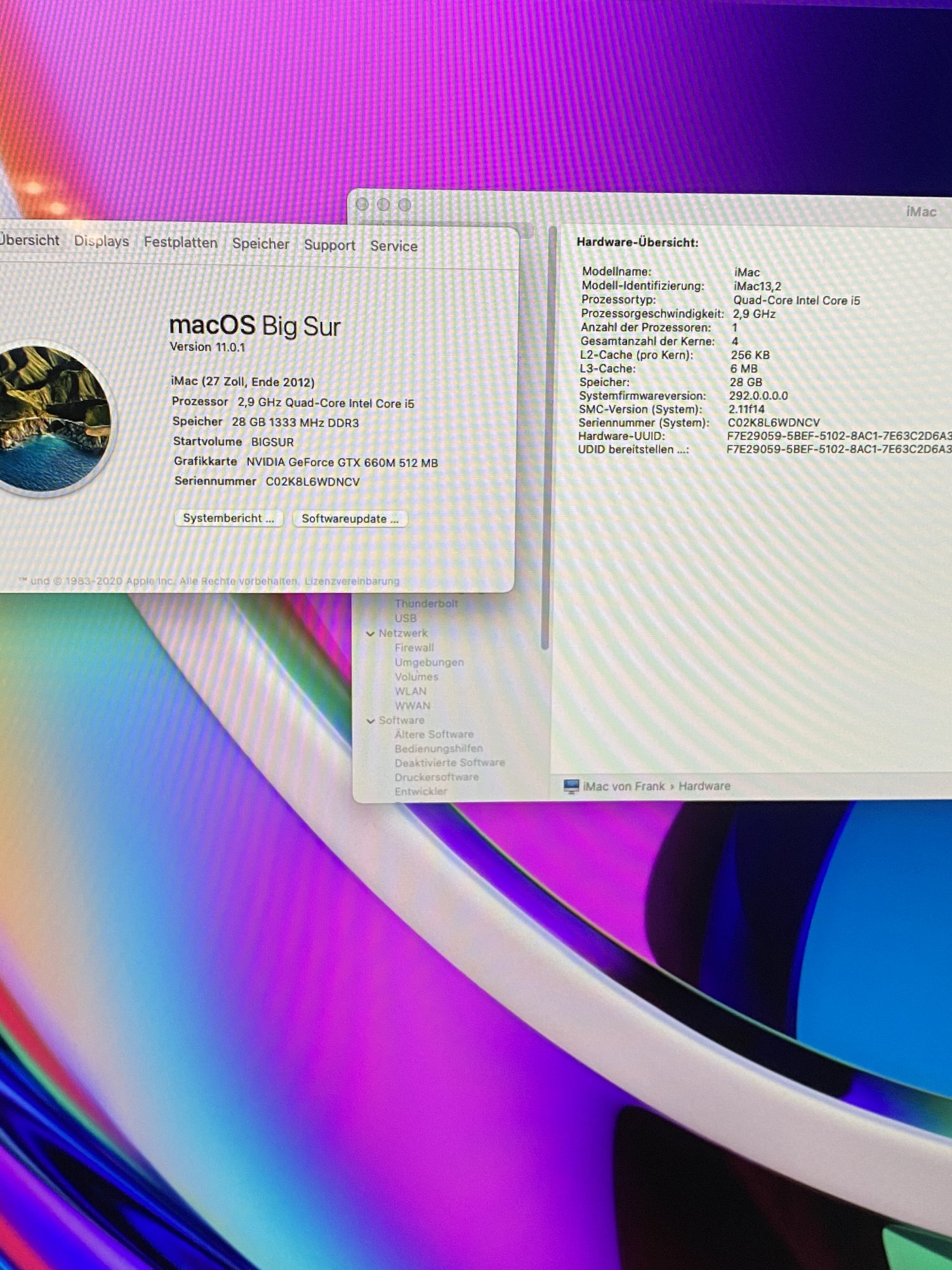

Okey. Everything's going great. Great thanks to Barry, Ausdauersportler, and the whole crew. Good job.

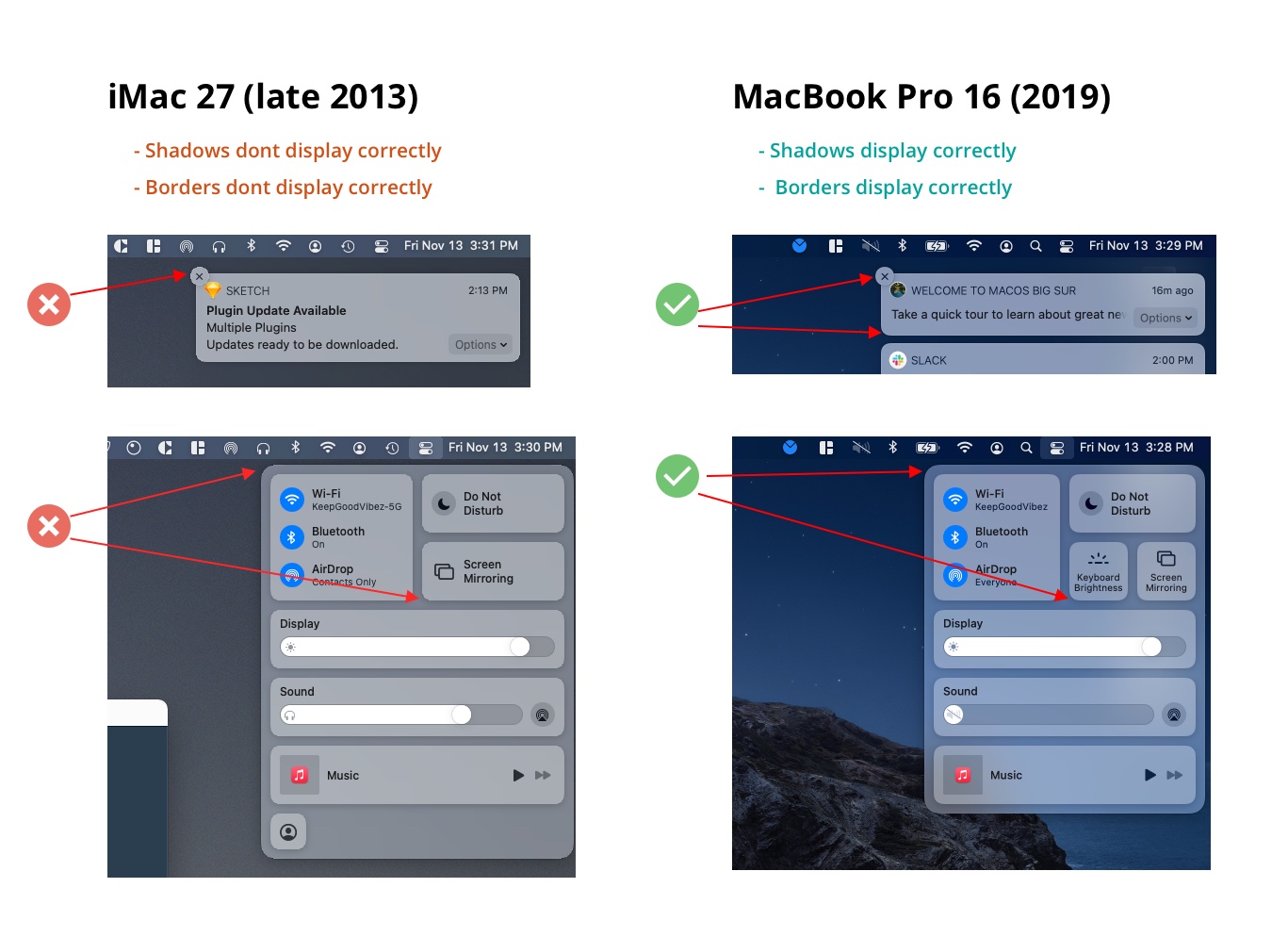

It works all well on Imac late 2013 and installation time was very similar to my MBP 2019, maybe because Imac runs from SSD through usb and it has 32Gb of memory. But my issue is there any way to fix graphics ? I see menus and toolbar it's not transparent and menu has white lines around this is something I don't have on my MBP. I know there was same issue with older unsupported macs who upgraded to Catalina but there was fix . I attach few screenshots Graphics looks definitely broken . Even someone who post before me screenshot it looks like graphs are broken .
Reactions: TimothyR734
