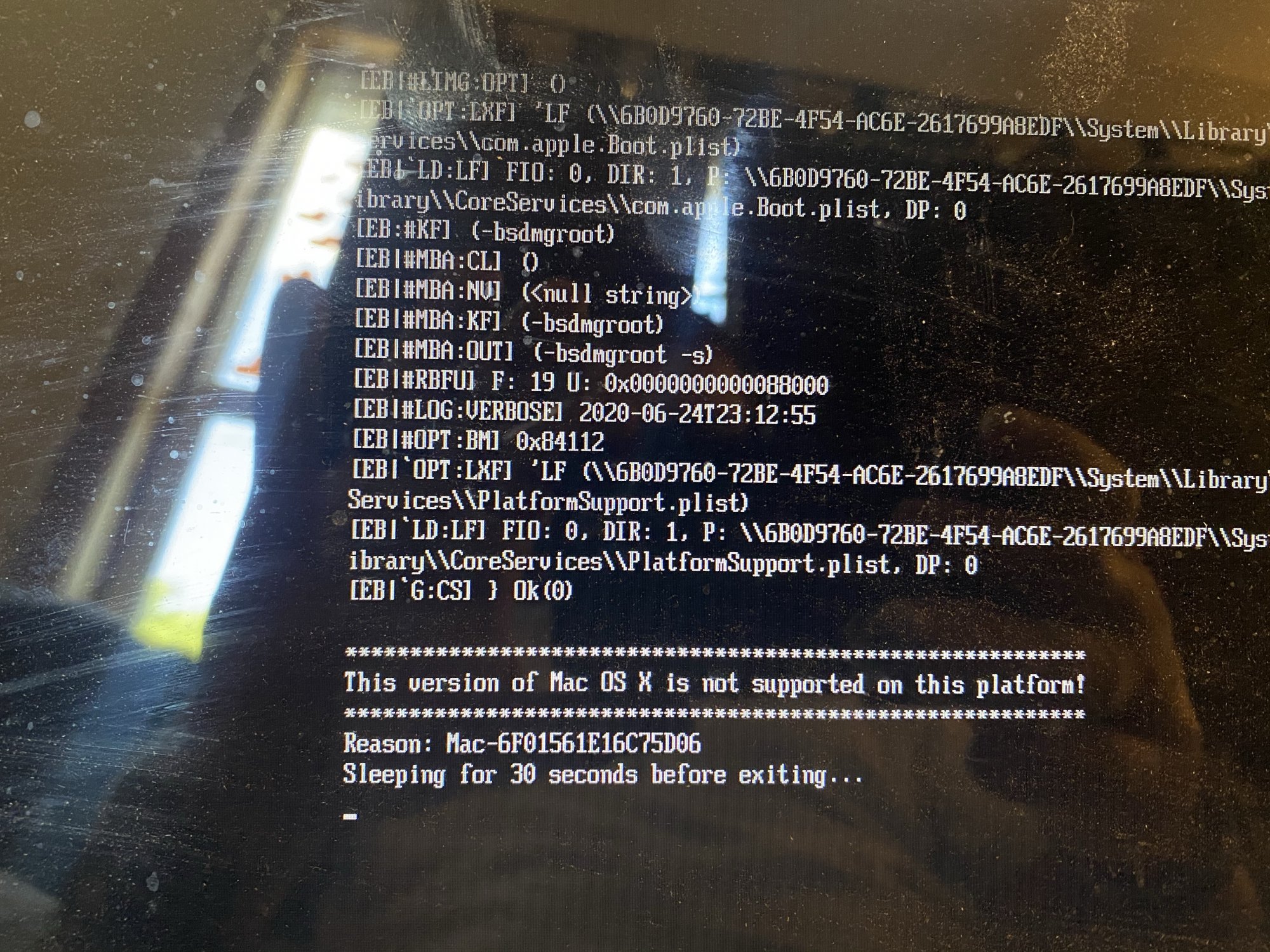

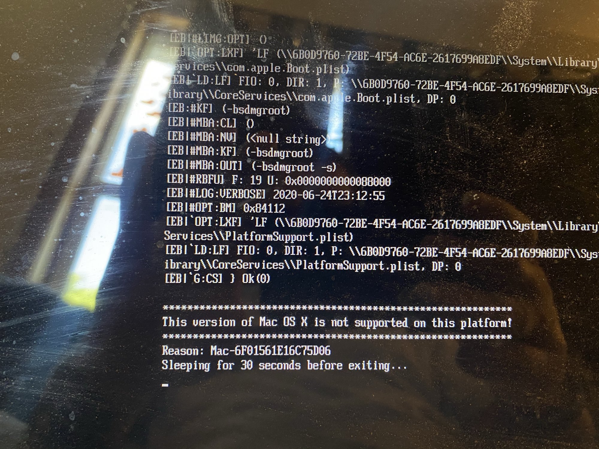

I followed the steps on my late 2012 iMac and installed to a separate volume. When trying to boot I get the do not enter sign. I can boot back to Catalina but can’t delete the Big Sur volume not the update volume it created. What do I do now?

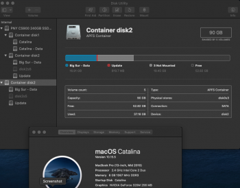

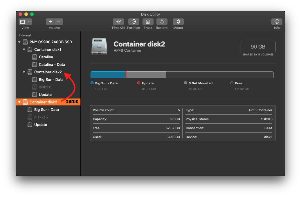

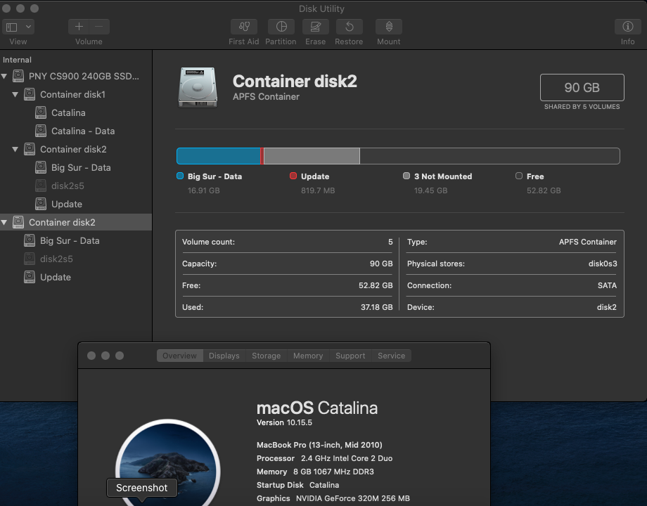

I made a separate 90 GB Catalina partition to my main one.
I downloaded the InstallAssistant.pkg (http://swcdn.apple.com/content/down...kxzj3zjshu1srsh4n74a41n4/InstallAssistant.pkg)
Then downloaded the really simple installer hack containing Hax.dylib & InstallHax.m
But then, I seen this https://lynx.pink/big-sur-unsupported-macs-tldr/ and I cloned this Big Sur Please script from GitHub.
I ran this convenient script instead: https://github.com/4ndv/big-sur-plz; opened InstallAssistant.pkg; installed it to /Applications; opened the macOS Beta app; then let the computer complete the upgrade.
After about 10 minutes waiting in Catalina, the usual loading bar shows. The grey apple logo strangely changes to pure white and shows 30 minutes remaining. After about 40 minutes (& 2 restarts) – it goes in a reboot loop saying
"Your computer shutdown because of problem press any key blah…". I proceeded to boot my main Catalina partition to check what was wrong.
I called the original 10.15 APFS partition, "Big Sur".
In Container disk2, I now have:
  1. Big Sur – Data,
  2. disk2s5,
  3. Update

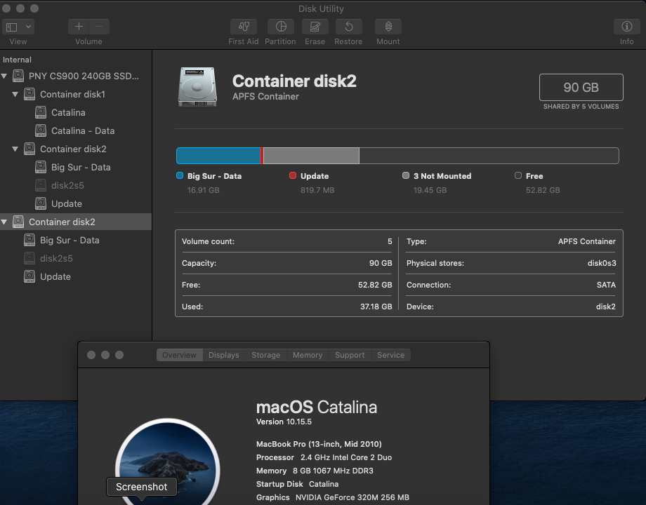

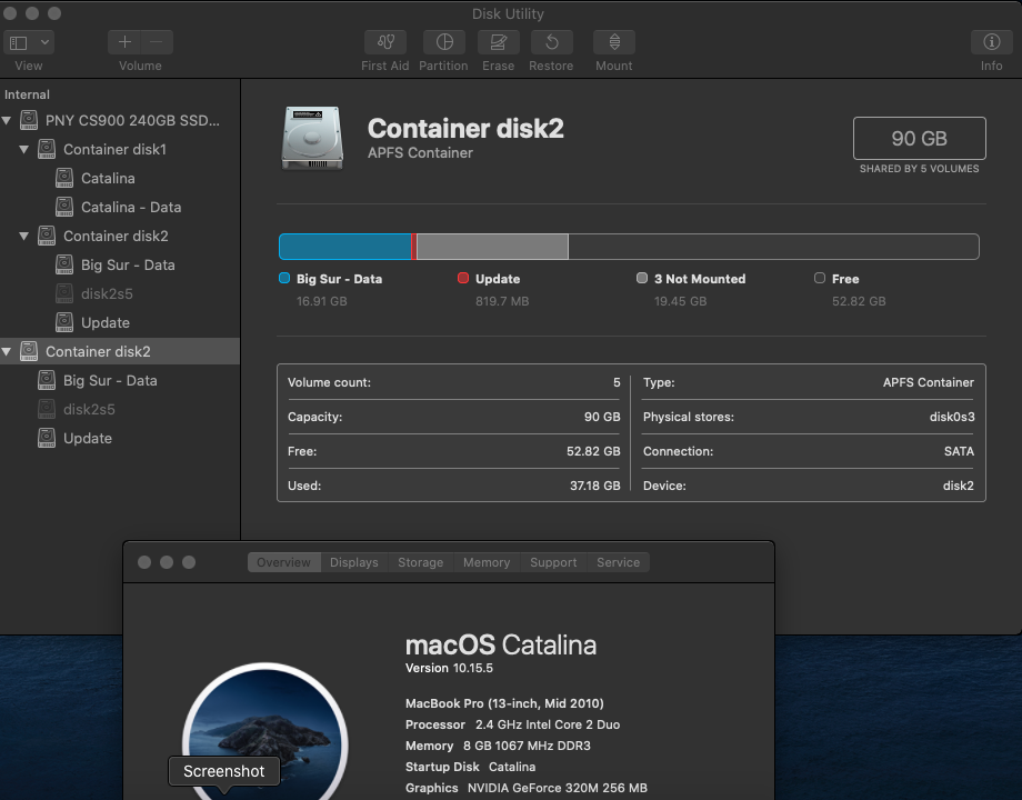

  1. Big Sur – Data,
  2. disk2s5,
  3. Update
Anyone else's machine stuck in a boot loop after BS installation? Data & Update partitions are showing in Disk Utility on the main Cat partition. I made a 2nd Cat partition just for Big Sur testing, but booting seems bleak…

Hmm I tried it but get an unbootable system. In your long version, you use the -s option. Did you mean -r? I presume you do per tldr. Executing with -r “” on my live volume, I’m unable to boot. Anyway, these snapshots make it rather easy to return back to a bootable system.
ASentientBot
macrumors 6502a
Jun 27, 2018
863
3,421
SkyLight.framework
Yes, I meant -r. Yikes, sorry about that. Will correct my post.

Hey everyone! After wasting half the day on this, I finally figured out one piece of the snapshots/error 66 puzzle.
The TL;DR is that you can just call apfs_systemsnapshot -v /Volumes/... -r "" to boot from the live volume. I haven't seen this published anywhere yet, and the accepted wisdom seems to be that you can't boot the live volume in BS. Hopefully this method will continue to work. It will make patching much easier.
Long version:
- disable SIP, including ARV (funnily enough, my very early boot.efi patch with all the 0xffffffffs actually works for this, even though @dosdude1's 0x67 one does not... anyways, I'll find the correct flags shortly and make a new patch)
- boot into Big Sur or a BS recovery/install disk
- diskutil mount diskXsY the real system volume (not the root snapshot, which will already be mounted at diskXsYsZ)
- find the path to the mounted volume (if you're booted into the same system, it will be volume_name 1 because of the previously mounted snapshot)
- /S*/L*/F*/apfs.fs/C*/R*/apfs_systemsnapshot -v "/Volumes/volume_name" -r ""
- reboot
- mount -uw / should now work, changes will apply immediately to the live volume, and you can remove all the snapshots with diskutil apfs deletesnapshot if desired
(I spent ages reverse engineering apfs_systemsnapshot and learning about the fs_snapshot_* functions before realizing you could just call the tool with an empty string. But if anyone is interested in the code for programmatically managing snapshots, I am happy to share it.)
Thanks to @mac_4eva/this post for the starting point.
One remaining mystery is figuring out how to mount the BS root from Cat. With the sealing/snapshots disabled, I don't see any reason why it shouldn't be possible.
I hope this works for others!
