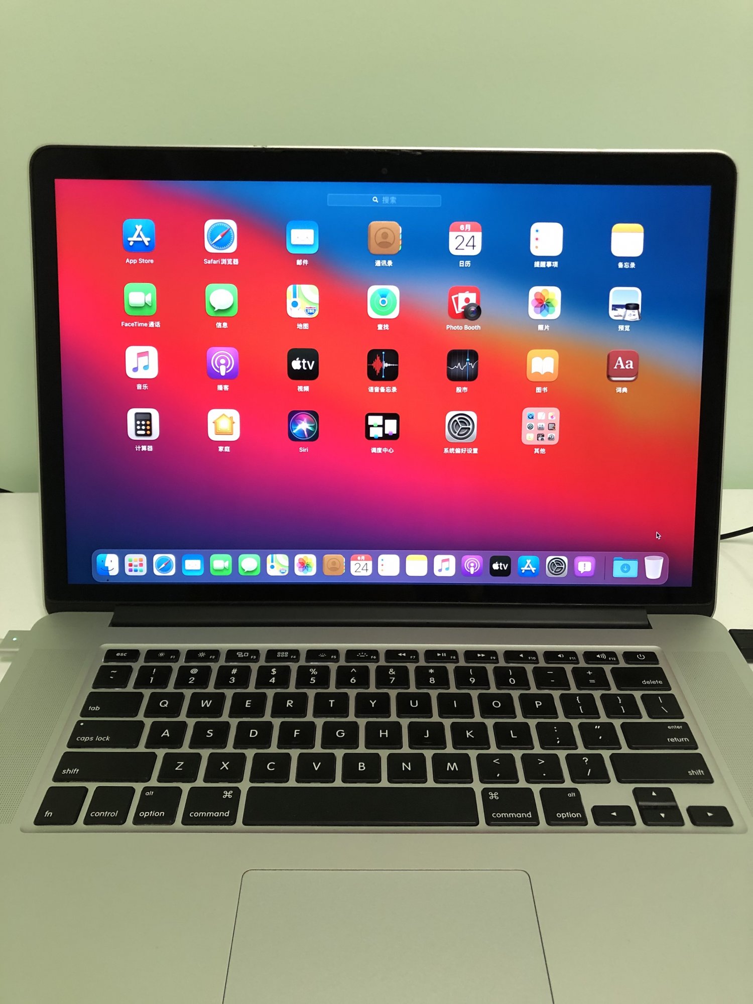

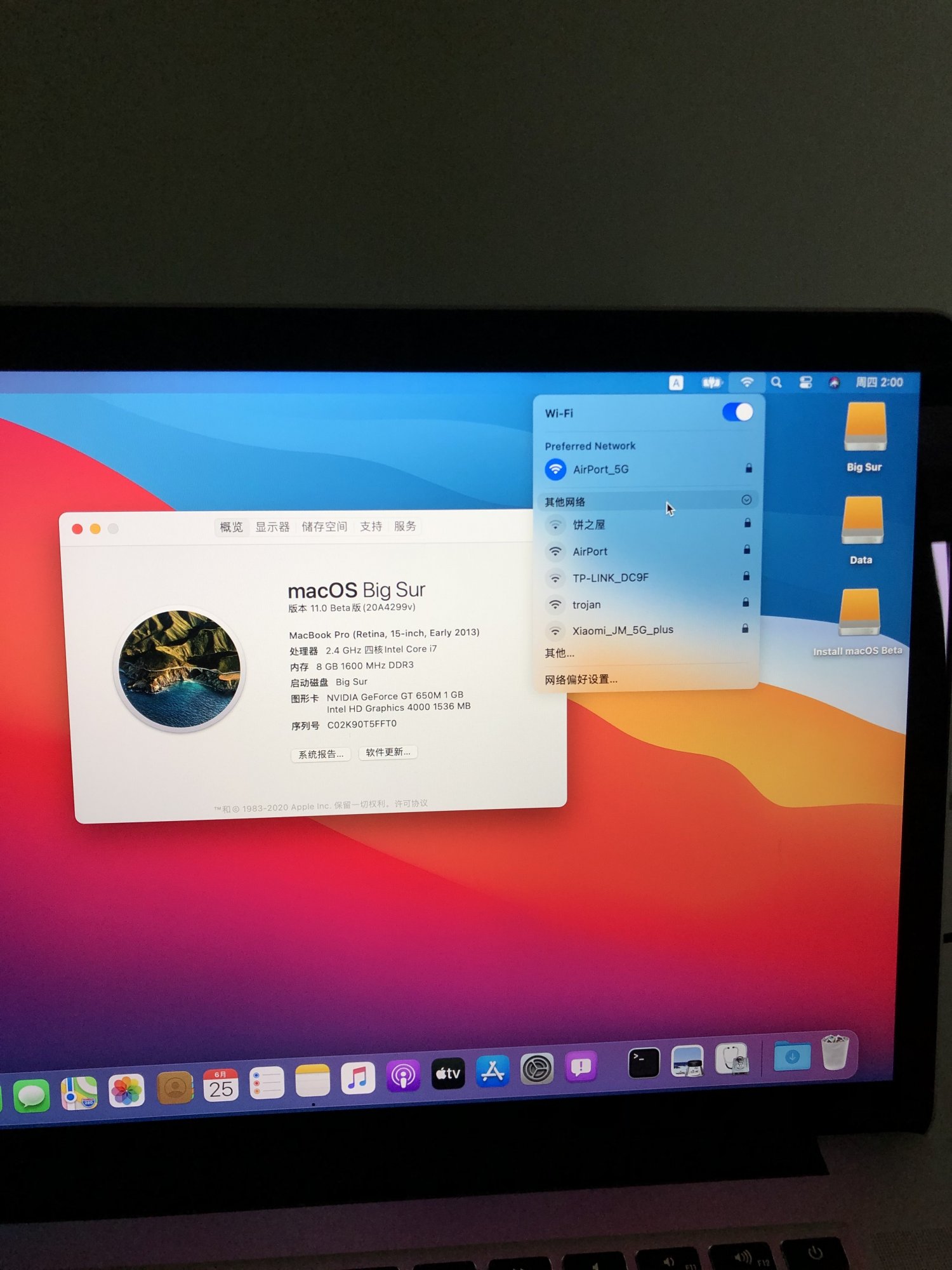

MacBook Pro (Retina, 15-inch, Early 2013) successfully installed macOS Big Sur with Wi-Fi working.
Thanks to Andrey Viktorov(https://medium.com/@andv/making-wif...d-macs-with-failed-with-66-error-36c98e3f7965). According to your step, I get the Wi-Fi working properly.

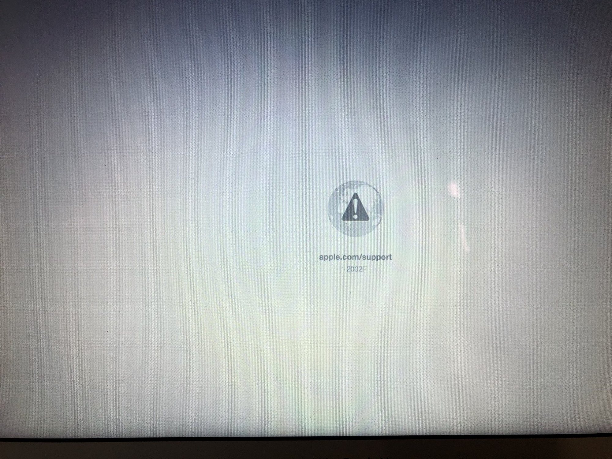

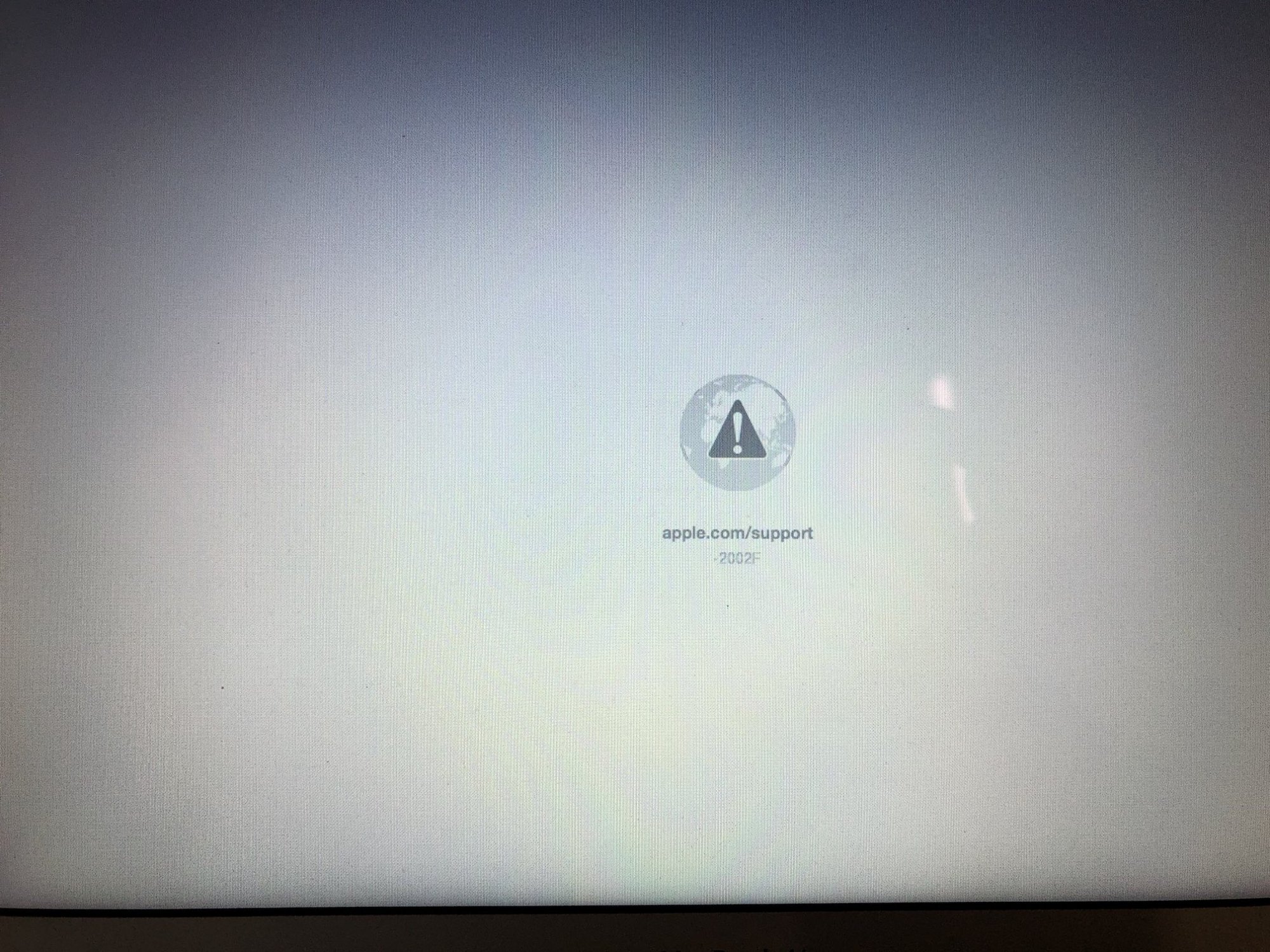

Thank you for the tip. I'm currently not able to boot, even in recovery mode, it ends up with this -2002F error, I might need to re-install via a USB stick.
Sorry, i can't help here. Google says it's dns failure. I have 1005F error, but it's because i've changed wifi card.

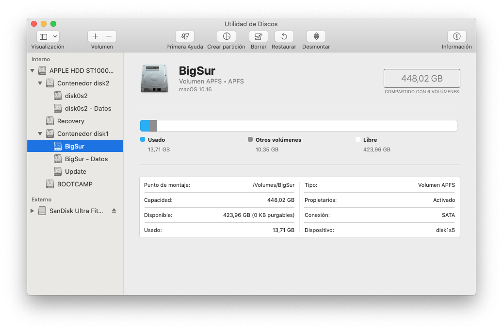

I tried to install on my iMac 27" late 2012 but the error 66 cotinue appearing :(
My disk: (disk0s2 = macOS catalina / BigSur = macos Big Sur Beta).

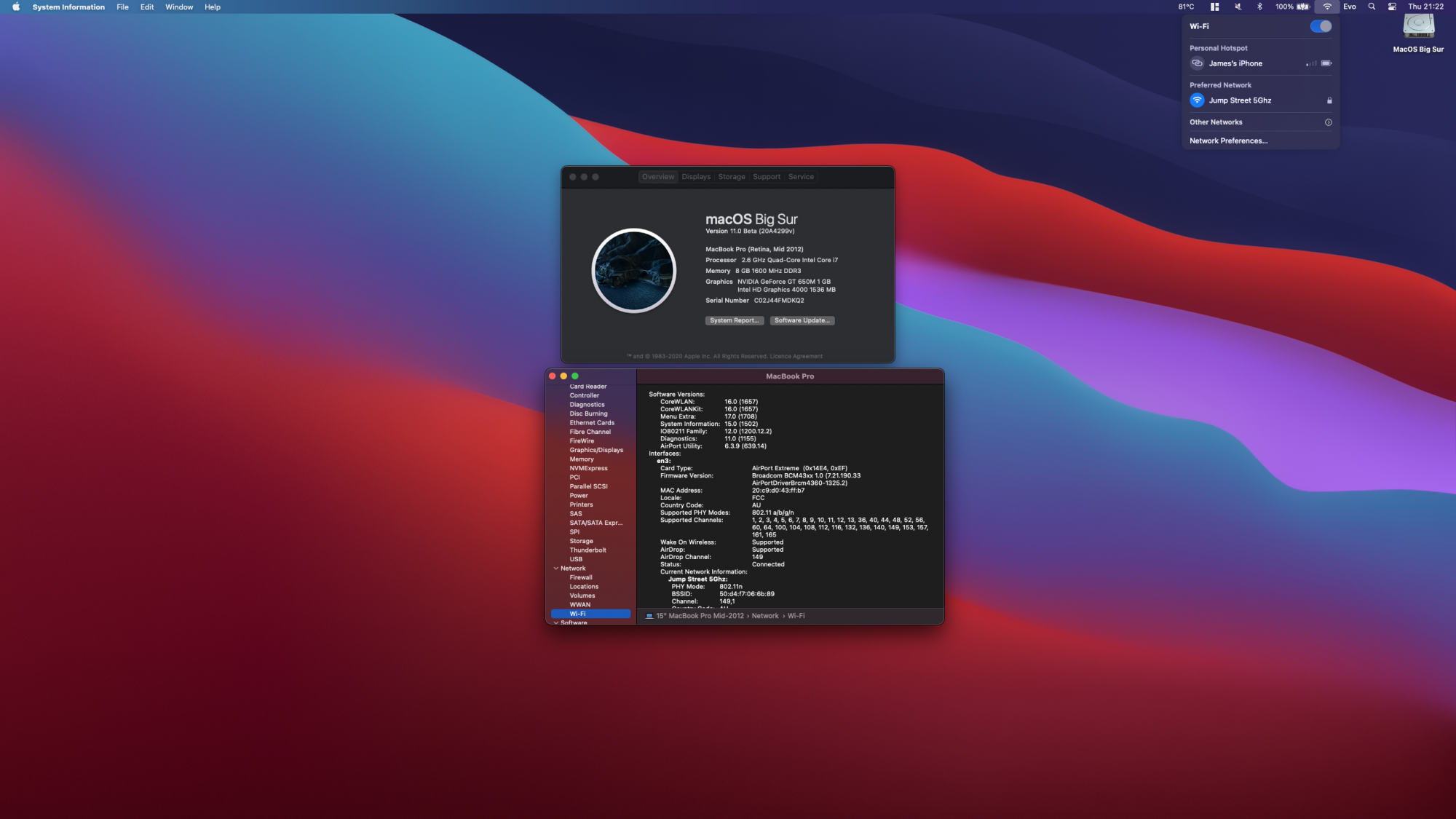

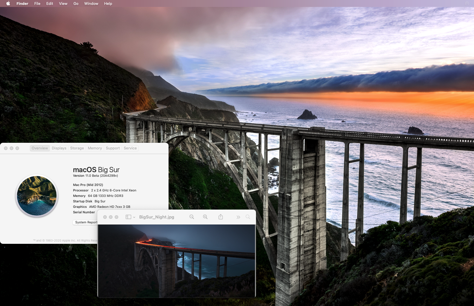

So I have my Macbook Pro Retina Mid-2012 15" All setup and working with Wifi. thank you for everyone's help and knowledge in this forum.
I have re enabled SIP as well as Authenticated-root and have had no problems with my Install.
the only 2 bugs I can see is on this machine and my new 16" 5600m is that my password works for everything apart from unlocking users & groups and also unlocking the Date & Time menu bar clock settings
