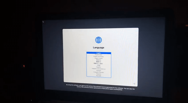

12 • Reboot into macOS Big Sur with caution.
Unfortunately, it will likely crash at the Choose your Language screen as soon as it boots up. It's possible that the Telemetry plugin is still copied/reused from a Big Sur snapshot booting (complicated sh*t), so get a small USB drive and download this USBOpenCoreAPFSloader3.app.zip. The boot loader will dynamically blocks the Telemetry plugin by loading the telemetrap.kext. All credits to @jackluke.
Go back to these three com.apple.Boot.plist files:
1 /Volumes/Preboot/UUID-BigSurData/Library/SystemConfiguration/com.apple.Boot.plist
2 /Volumes/Preboot/UUID-BigSurData/Library/Preferences/SystemConfiguration/com.apple.Boot.plist
3 /Volumes/Preboot/UUID-BigSurData/System/Library/CoreServices/
Change this <string>boot\System\Library\KernelCollections\BootKernelExtensions.kc</string>

Edit: Welcome to Big Sur!
