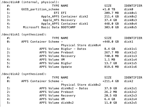

I attach my disk partitions with the info.
the "disk2" (disk0s2) is the macOS Catalina.
THANKS

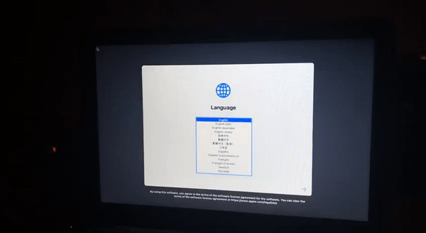

I removed (renamed) the Telemetry plugin, and I can boot to the Choose your Language screen — but then it panics!
Any ideas on how to stop BS panicking?

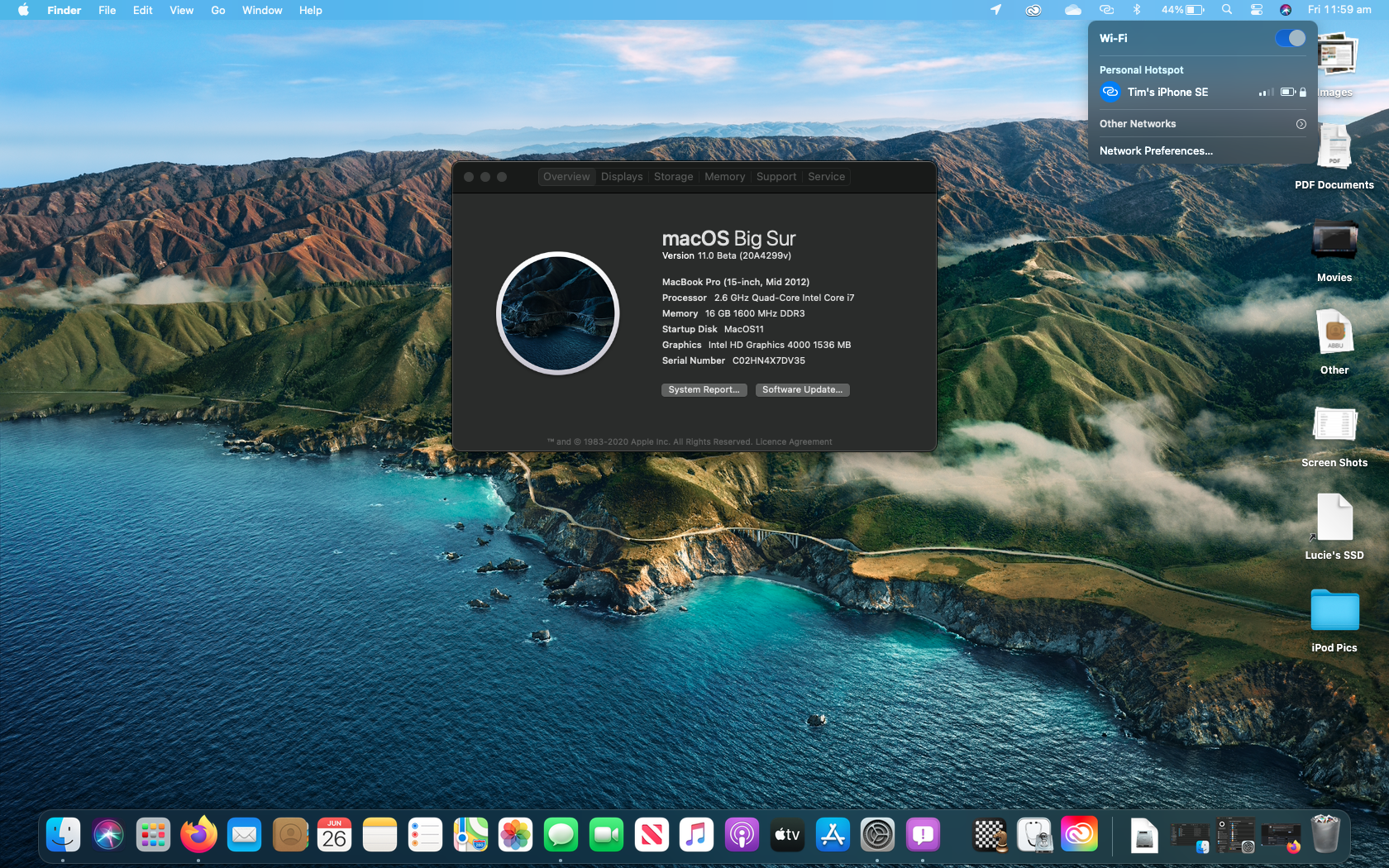

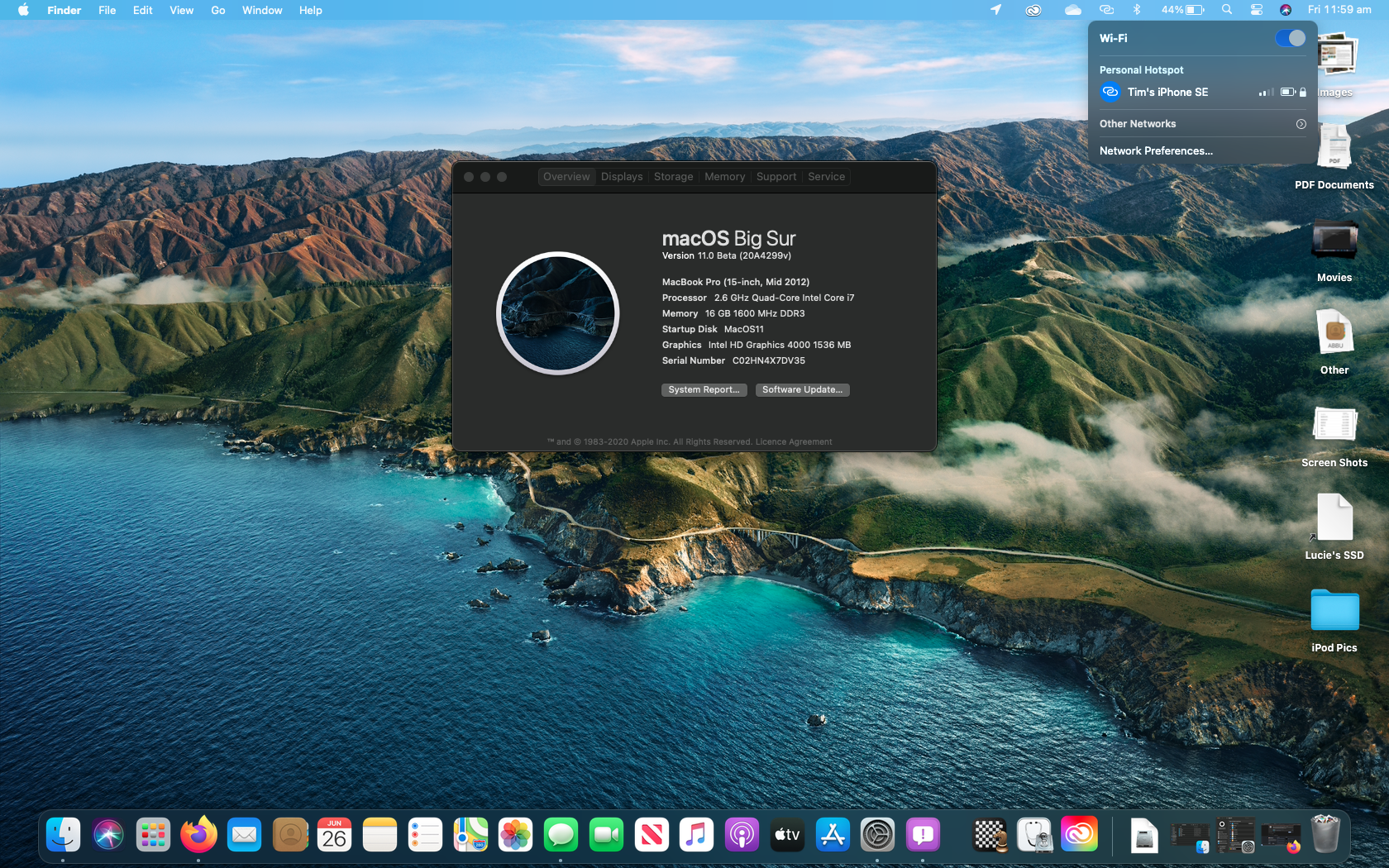

Thought you all would want to see this, my 2012 15" Unibody MacBook pro has had it's WiFi card replaced with a more modern one and it runs Big Sur flawlessly, no Kext edits required. better than Catalina IMOView attachment 927808
If you're curious about the WiFi card you can find it here: https://subtle.design/
Do you know if this card will this work with the 13 inch 2012 MacBook Pro unibody? (MacBook Pro 9,2)
*Nevermind according to the website it does, however they're out of stock right now*.

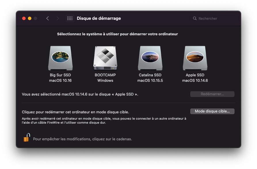

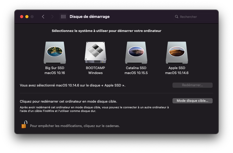

As-tu créé ces icônes? Ils semblent bien adaptés à mes partitions SSD. Malheureusement, les icônes personnalisées n'apparaissent jamais dans le sélecteur de démarrage…c'est toujours l'icône du disque jaune qui doit être la valeur par défaut dans l'ancien firmware.
Salut @quaccOS
Yes I created them,
I made them first with black SSD
but I prefer the news in gray...
I also made them with the old HDD icon
then with the new HDD icons from Big Sur
Indeed the personalized icons of the discs will not appear on the bootscreen

My Cat volume & recovery fail to recognise the Big Sur system volume:
Container disk1 = {Big Sur - Data, Preboot, Recovery, VM, disk1s5, Update}.
I'd have to boot the USB Big Sur Installer for the disks to be visible as normal. Maybe this is because the Update may not have actually finished – or Catalina doesn't understand Big Sur's unique APFS arrangement.
I think this line is for renaming the volume, right? I can do this in BS recovery – just not anywhere else
sudo bless --folder /Volumes/YourBigSurLabel/System/Library/CoreServices --label "YourBigSurLabel"
I will try diskutil apfs updatePreboot /Volumes/YourBigSurLabel/ if all else fails.

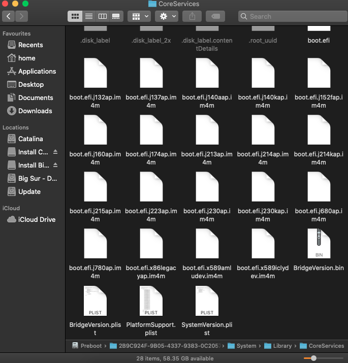

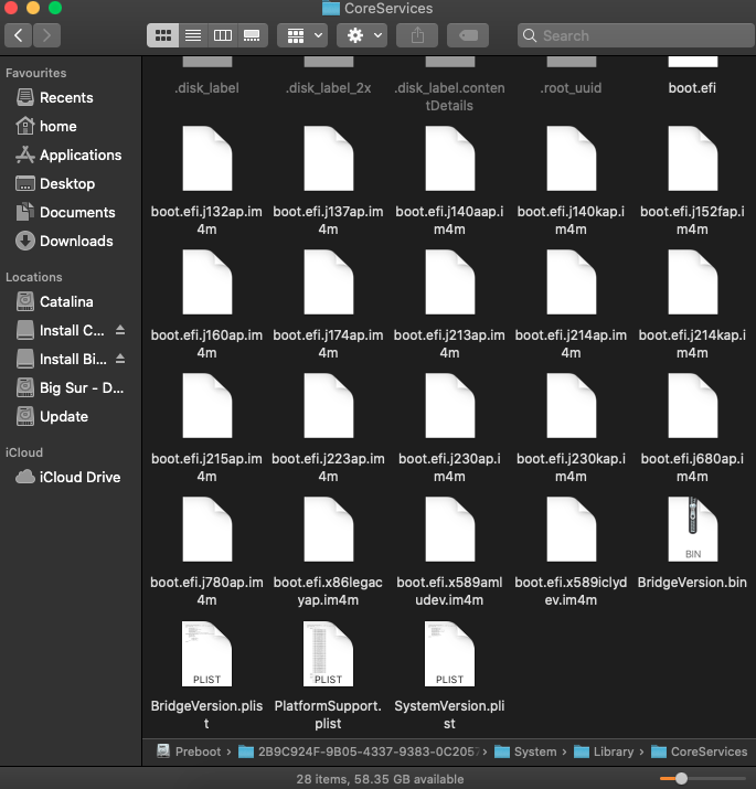

The BigSur com.apple.Boot.plist used by Preboot is located here:
/Volumes/Preboot/UUID-BigSur/System/Library/CoreServices/
while till Catalina the Preboot UUID from diskutil apfs list matched with the Catalina "APFS System role" UUID, from BigSur seems that now it matches with the BigSur "APFS Data role" UUID.
Just try this from an USB BigSur Installer: diskutil apfs updatePreboot /Volumes/YourBigSurLabel/
If still can't boot, then probably the BigSur "APFS Data Volume update" doesn't completed properly (this occurs often with patched macOS installer), then you should re-install BigSur.
CoreServices in Preboot Vol.pngI can't find any com.apple.Boot.plist in the CoreServices directory. I will try that command you said if all else fails
