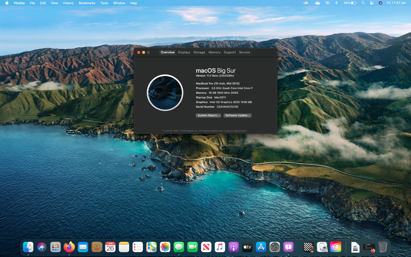

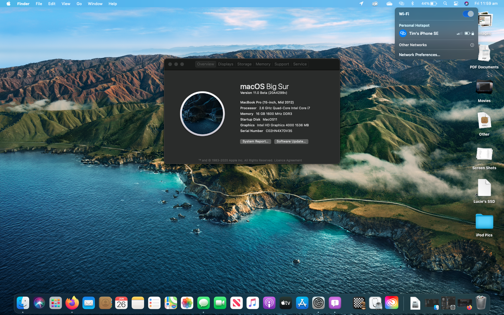

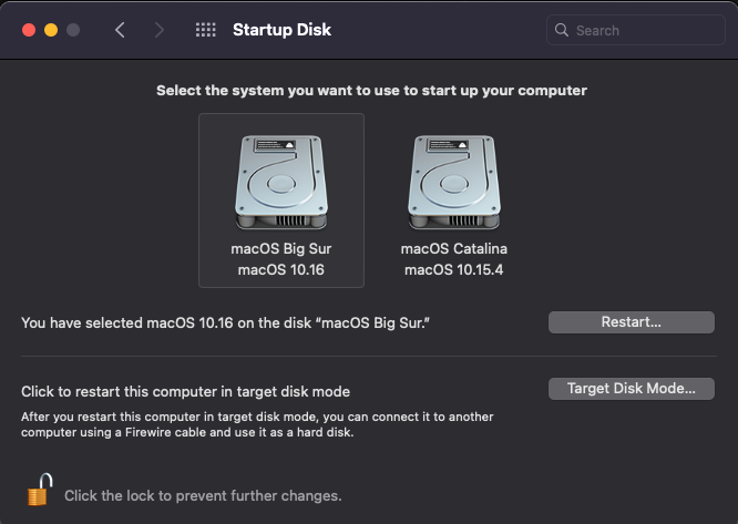

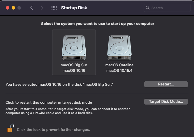

Thought you all would want to see this, my 2012 15" Unibody MacBook pro has had it's WiFi card replaced with a more modern one and it runs Big Sur flawlessly, no Kext edits required. better than Catalina IMO
If you're curious about the WiFi card you can find it here: https://subtle.design/

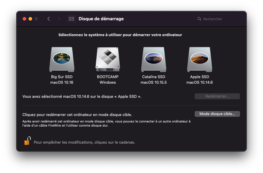

[automerge]1593143755[/automerge]
something kind of stupid. But I kinda hope that have a ssd pic for ssd drive :p

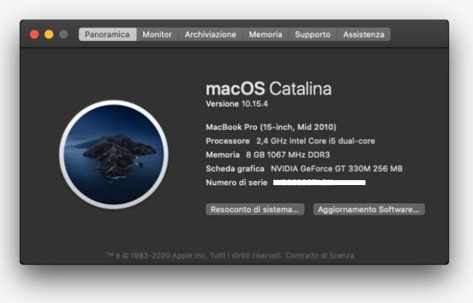

Hello everyone, I've just
1. Disabled SIP from Recovery Mode
2. Downloaded the InstallAssistant.pkg file and installed the package
3. Downloaded the ASentientBot "really simple installer hack" file
4. ran sudo defaults write /Library/Preferences/com.apple.security.libraryvalidation.plist DisableLibraryValidation -bool true command (for disabling Library Validation)
5. ran launchctl setenv DYLD_INSERT_LIBRARIES $PWD/Hax.dylib command
6. Opened Install macOS Beta.app file
7. Selected Macintosh HD as installation disk
The installer automatically rebooted my mac (Macbook Pro 15, Mid 2010) and booted the installer partition, but when Apple logo shows up the system crashes and reboots, crashing again.
What can I do?
(I'm running macOs Catalina now)
What can I do?
If you're getting "crossed circle", then:
sudo nvram boot-args="-no_compat_check"
Reactions: ASentientBot
