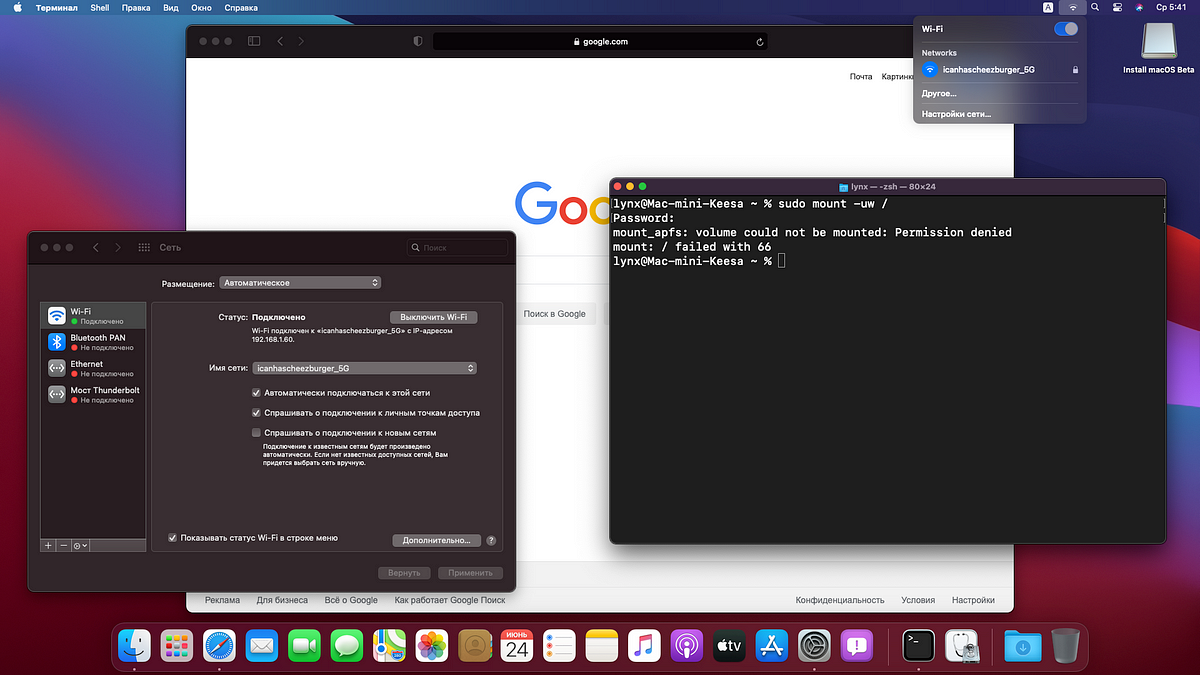

What method you used for wifi? I have failed 66 on one method and not acces too root :(

Hey everyone! After wasting half the day on this, I finally figured out one piece of the snapshots/error 66 puzzle.
The TL;DR is that you can just call apfs_systemsnapshot -v /Volumes/... -r "" to boot from the live volume. I haven't seen this published anywhere yet, and the accepted wisdom seems to be that you can't boot the live volume in BS. Hopefully this method will continue to work. It will make patching much easier.
Long version:
- disable SIP, including ARV (funnily enough, my very early boot.efi patch with all the 0xffffffffs actually works for this, even though @dosdude1's 0x67 one does not... anyways, I'll find the correct flags shortly and make a new patch)
- boot into Big Sur or a BS recovery/install disk
- diskutil mount diskXsY the real system volume (not the root snapshot, which will already be mounted at diskXsYsZ)
- find the path to the mounted volume (if you're booted into the same system, it will be volume_name 1 because of the previously mounted snapshot)
- /S*/L*/F*/apfs.fs/C*/R*/apfs_systemsnapshot -v "/Volumes/volume_name" -r ""
- reboot
- mount -uw / should now work, changes will apply immediately to the live volume, and you can remove all the snapshots with diskutil apfs deletesnapshot if desired
(I spent ages reverse engineering apfs_systemsnapshot and learning about the fs_snapshot_* functions before realizing you could just call the tool with an empty string. But if anyone is interested in the code for programmatically managing snapshots, I am happy to share it.)
Thanks to @mac_4eva/this post for the starting point.
One remaining mystery is figuring out how to mount the BS root from Cat. With the sealing/snapshots disabled, I don't see any reason why it shouldn't be possible.
I hope this works for others!

Looks like, at least for me, deleting all the snapshots is also required.
You can do it from BS recovery or Installer usb, after mounting your disk, and doing this:
mount -uw /Volumes/Big\ Sur\ Volume\ Name
diskutil apfs listSnapshots disk2s7 (replace with your disk), here will be uuids
Then for each of the uuids:
diskutil apfs deleteSnapshot disk2s7 -uuid UUIDHERE (replace disk2s7 and UUIDHERE with corresponding values)
I sse something similar here
Absolutely, very good article and quite similar. The difference is I just passed an empty string for the root snapshot name, which seems to cause it to use the live volume. But other people are reporting various results... use at your own risk.
