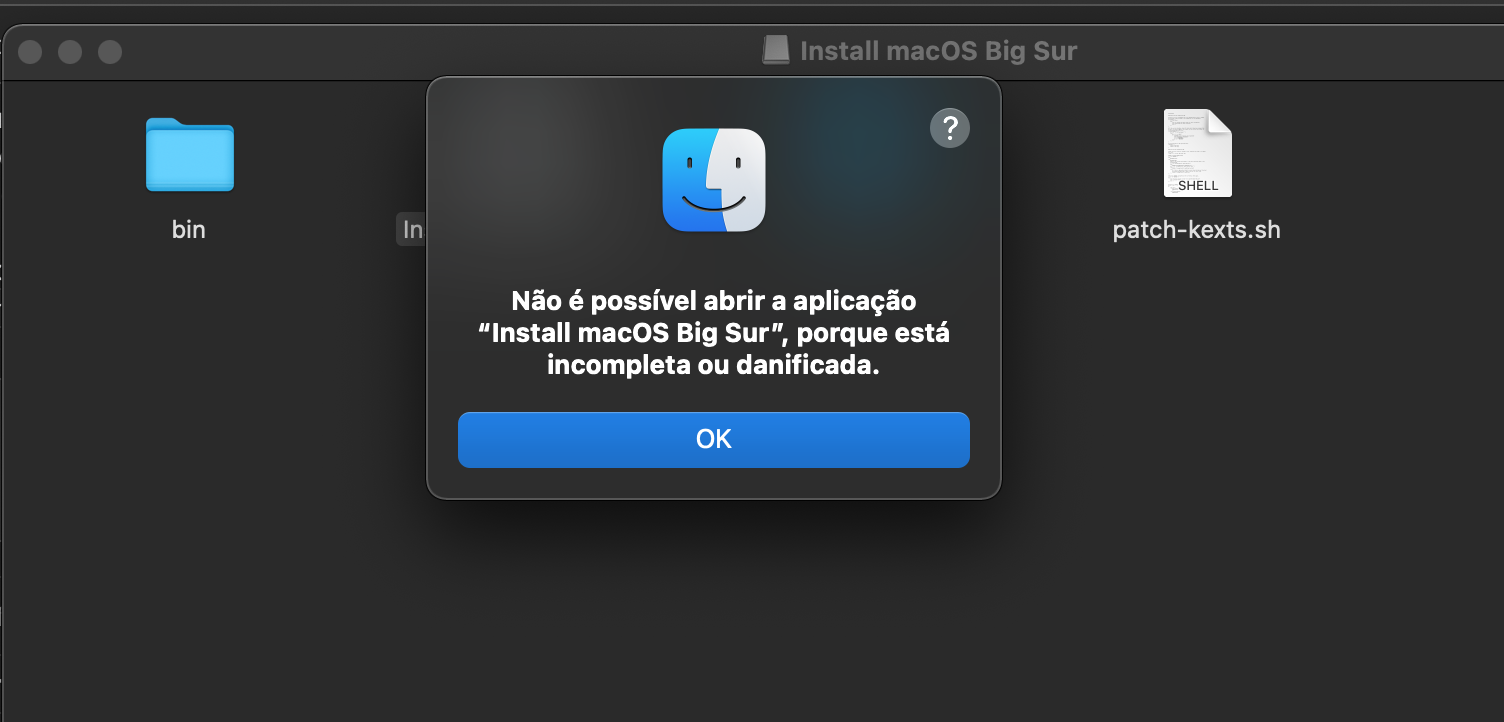

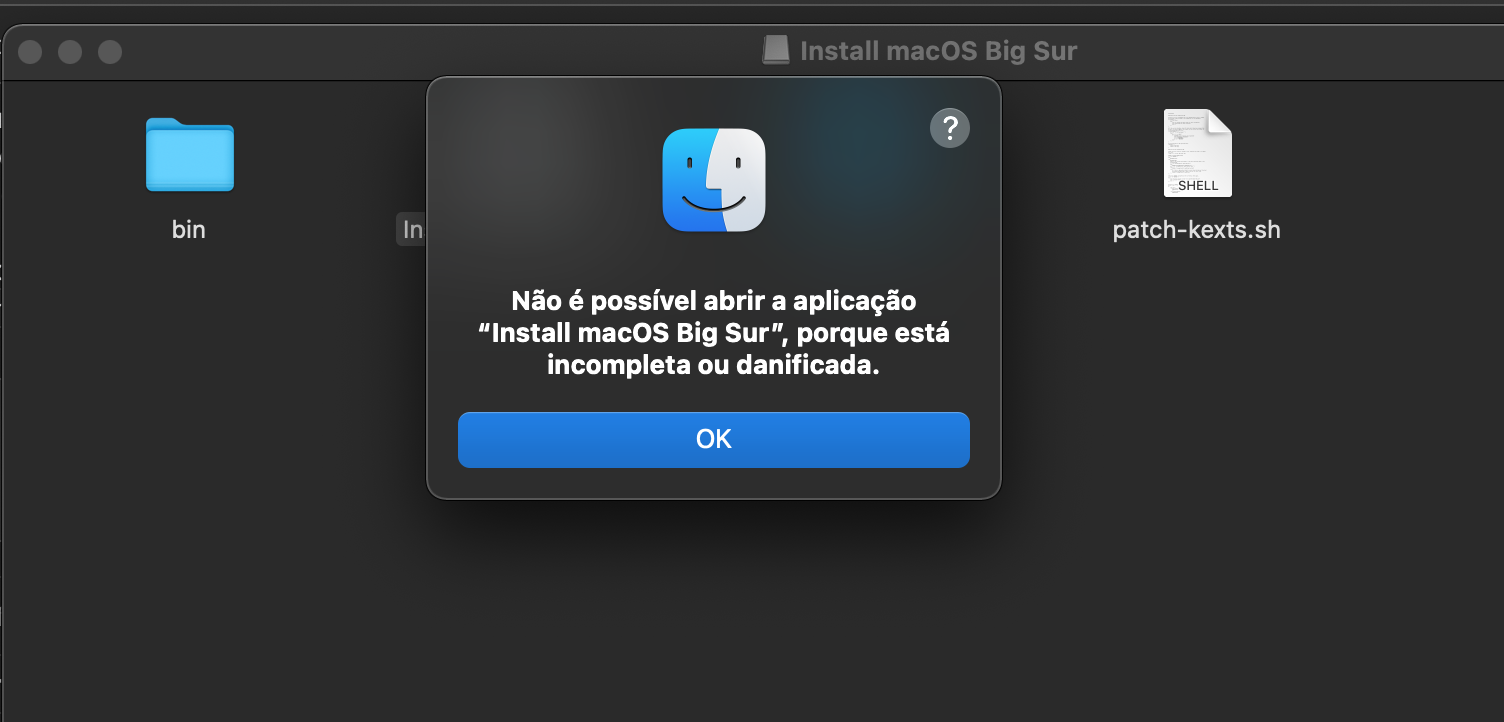

Oh thanks a lot! So i can just mount this .dmg directly and install without not burning it as usb bootable, right?
Hmmm i downloaded and mounted it but it appears this:
(translating it: it wasn't possible to open the application "install macOS big sur" because it's incompleted or damaged)
And weirdly the .dmg have just 70MB, that's right?

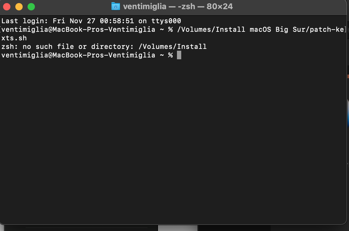

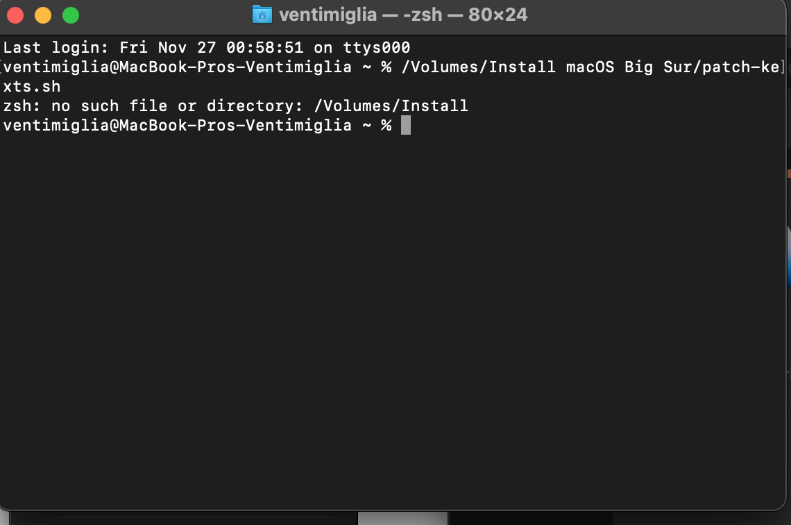

Yeah, that's just a placeholder so patch-kexts.sh works. Just run /Volumes/Install macOS Big Sur/patch-kexts.sh and restart and everything should work.

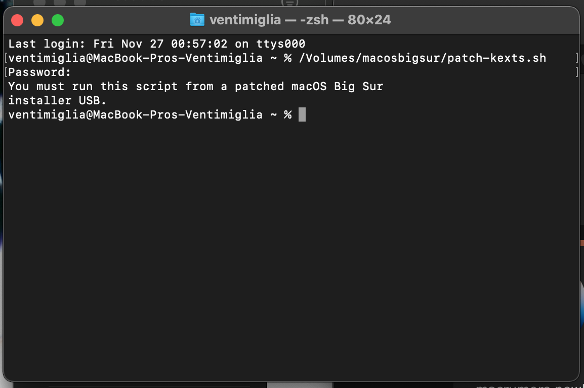

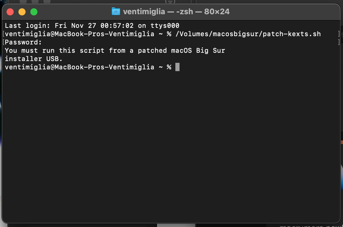

I tried it ( i just changed the name of .dmg to 'macosbigsur' to be easier to find it). What should i do? :( Sorry for asking a lot.

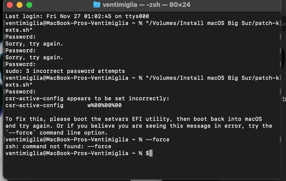

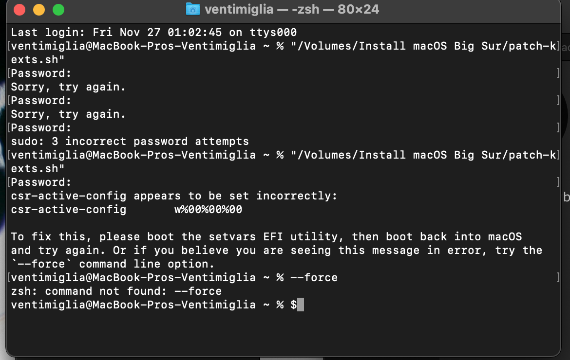

Okay, I'm stepping out on a limb here, but boot into whatever Mojave recovery mode. Open Terminal under the Utilities menu and run nvram csr-active-config=%7f%08%00%00 then boot back into Big Sur and try patch-kexts.sh command again
Ok, i'll do it now.
Goddamit, it worked! Thanks a lot!
