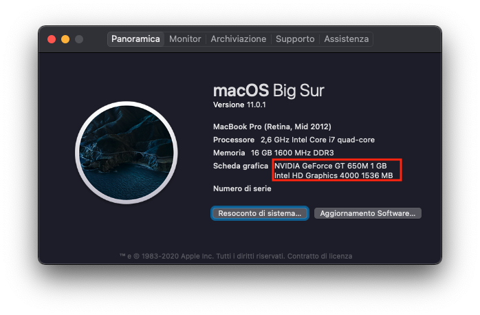

Hello everyone,
is any of you experiencing a graphic anomaly consisting in having green rectangles on random images on Safari? Sometimes if I open the image, the rectangles disappear. Following examples from Google Images and my Mac specs (I used Barry's micropatcher to install BS). The issue seems not happening in Photos app or Finder.
BTW, is normal that the info window shows both graphic cards? Always thought that it would show just the one in use.
PS: thanks to @Barry K. Nathan and all the other guys for their amazing and priceless work!

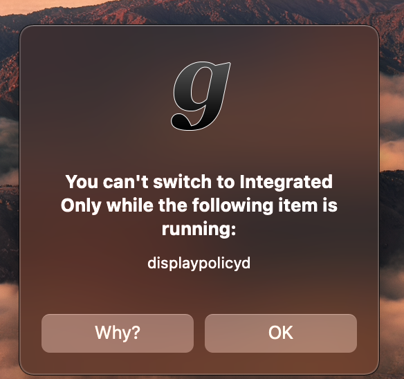

I can't get no 3 to work like yours.
If I run gfx and try to switch to Integrated only I get this
And even though Dynamic switching is selected by default it won't actually switch at all. It just leaves the Nvidia card powered up and in use.

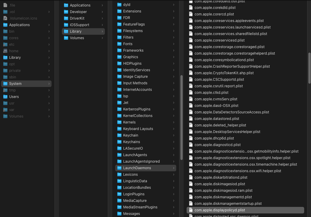

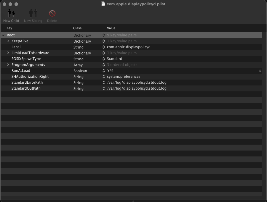

The only way I can get graphics switching to work is by stopping the displaypolicyd process in the terminal.
That then makes the system use the Intel graphics until I run something more demanding when the Nvidia card will fire up.
I can confirm that displaypolicyd running seems to prevent from gpu dynamic switching on BS on this machine. Anyway stopping this process won't made any changes in my case scenario, since i'm using the computer in clamshell mode mostly: connecting an external display forces the sistem to use the discrete gpu, whether displaypolicyd is running or not.

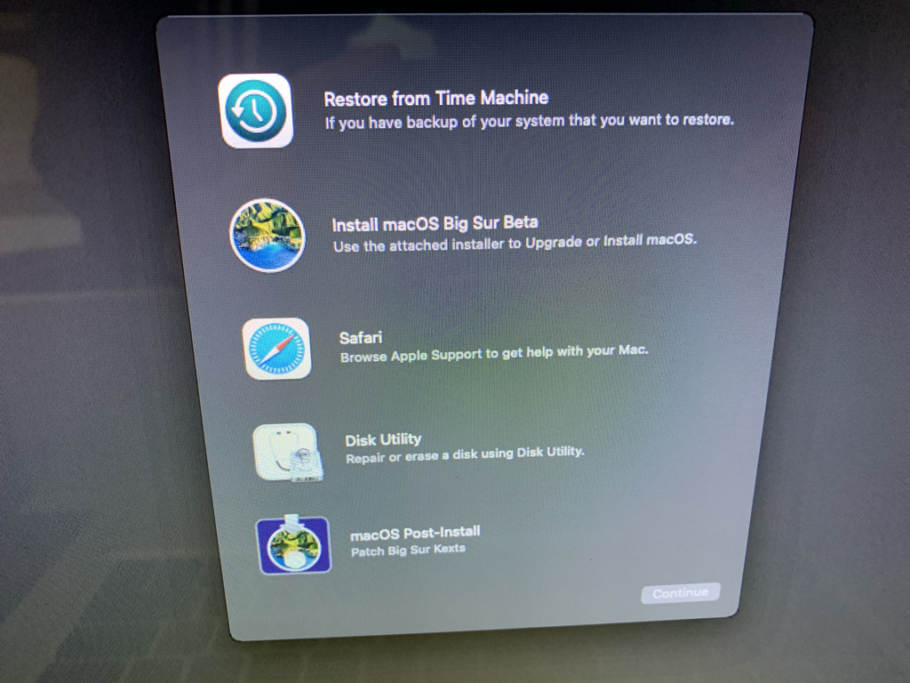

I'm trying to install Big Sur on my mid-2012 MacBook Pro (dual GPU) using OpenCore Legacy Patcher v0.0.6 from @khronokernel and I'm having the exact same issue that dennes544 reported on Github after booting from the USB stick and selecting the EFI Boot Option:
MacBookPro9,1, NVIDIA GeForce GT 650M boots to black screen with Big Sur 11.0.1 installer. After verbose boot it shows mouse cursor for a second, the blackscreen and backlight disables
Is it a bug with the patcher or am I missing something?

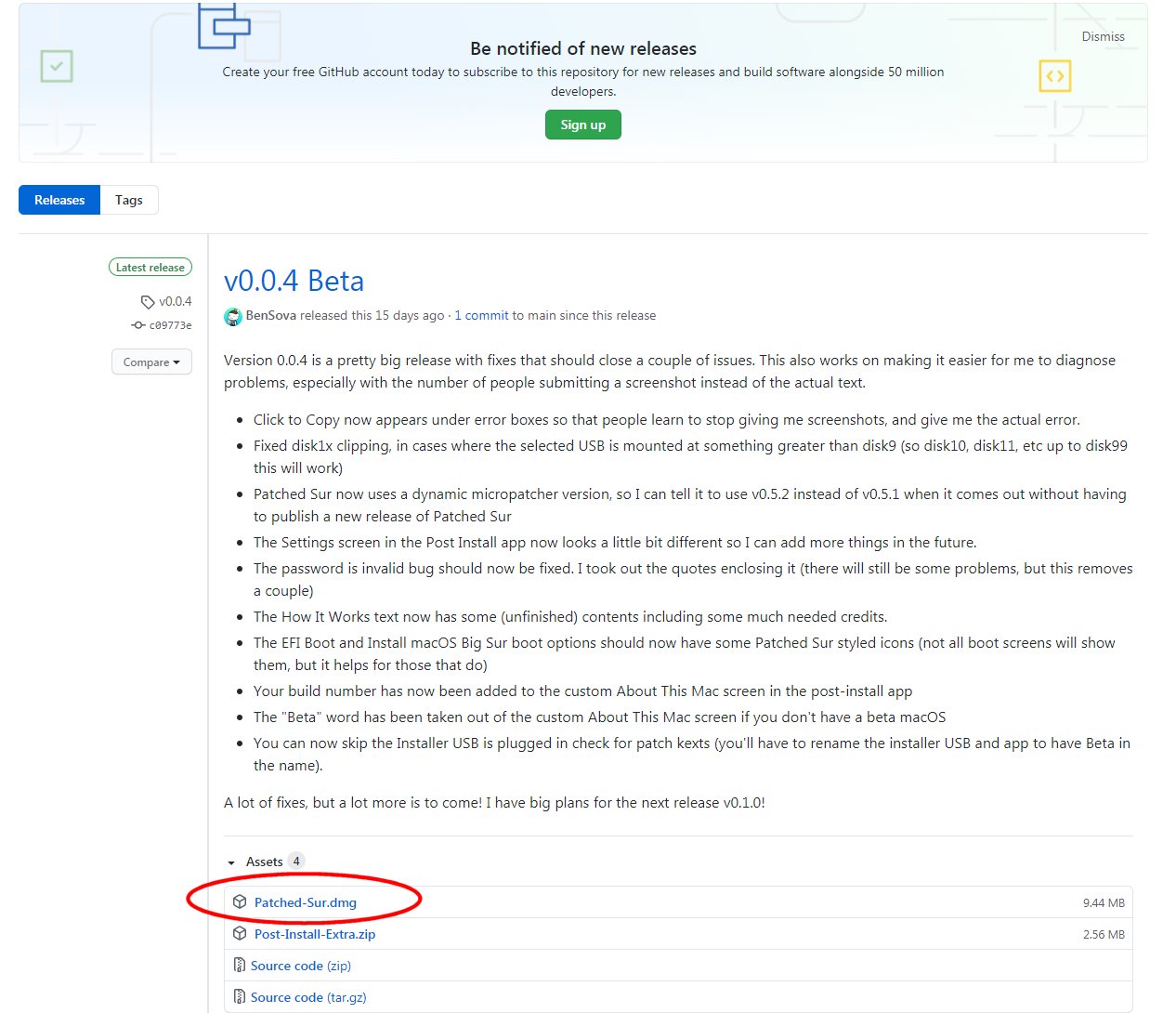

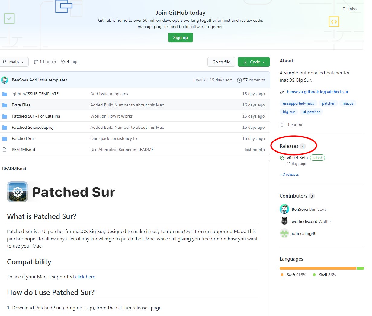

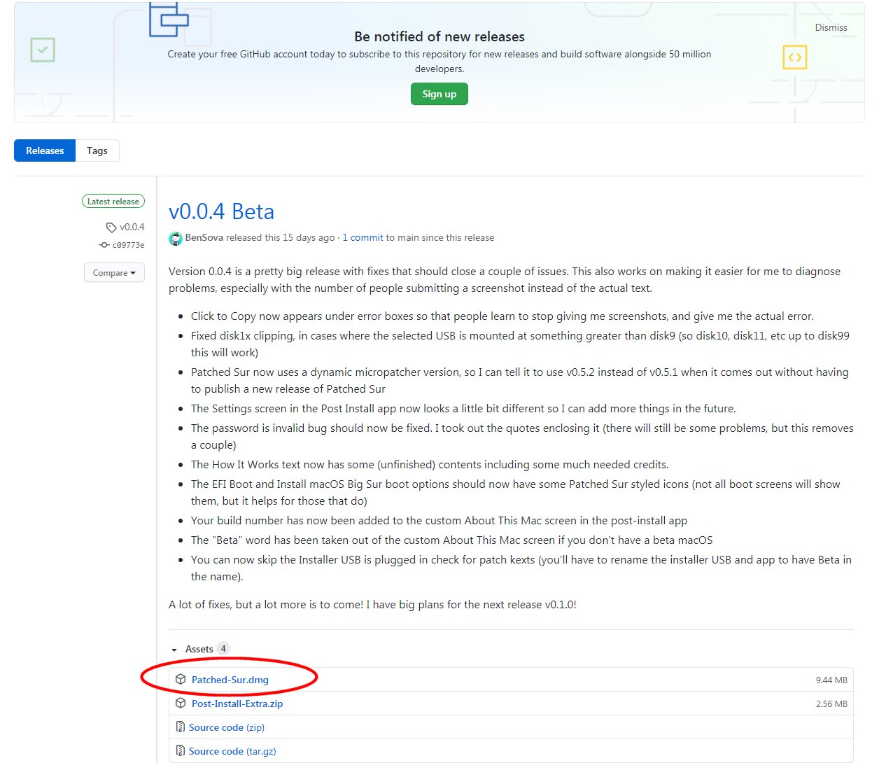

Your "ignorance" is very forgivable; github could certainly make this clearer.
On the Patched-Sur main page (https://github.com/BenSova/Patched-Sur), click on "Releases" (see red circle):
That will take you to the Releases page, where you can download the .dmg file from the latest release (see red circle):
Good luck!
Many thanks for your speedy reply. I downloaded it and installed BS 11.1 beta 1 everything went well but alas even though my wifi was on it wasn’t working. So I’m going back the general release version. However on that release the tv app won’t play any of my movies. Due to some kind of file protection. Everything works fine in Mojave with my movies just not in big sur. Any suggestions?
