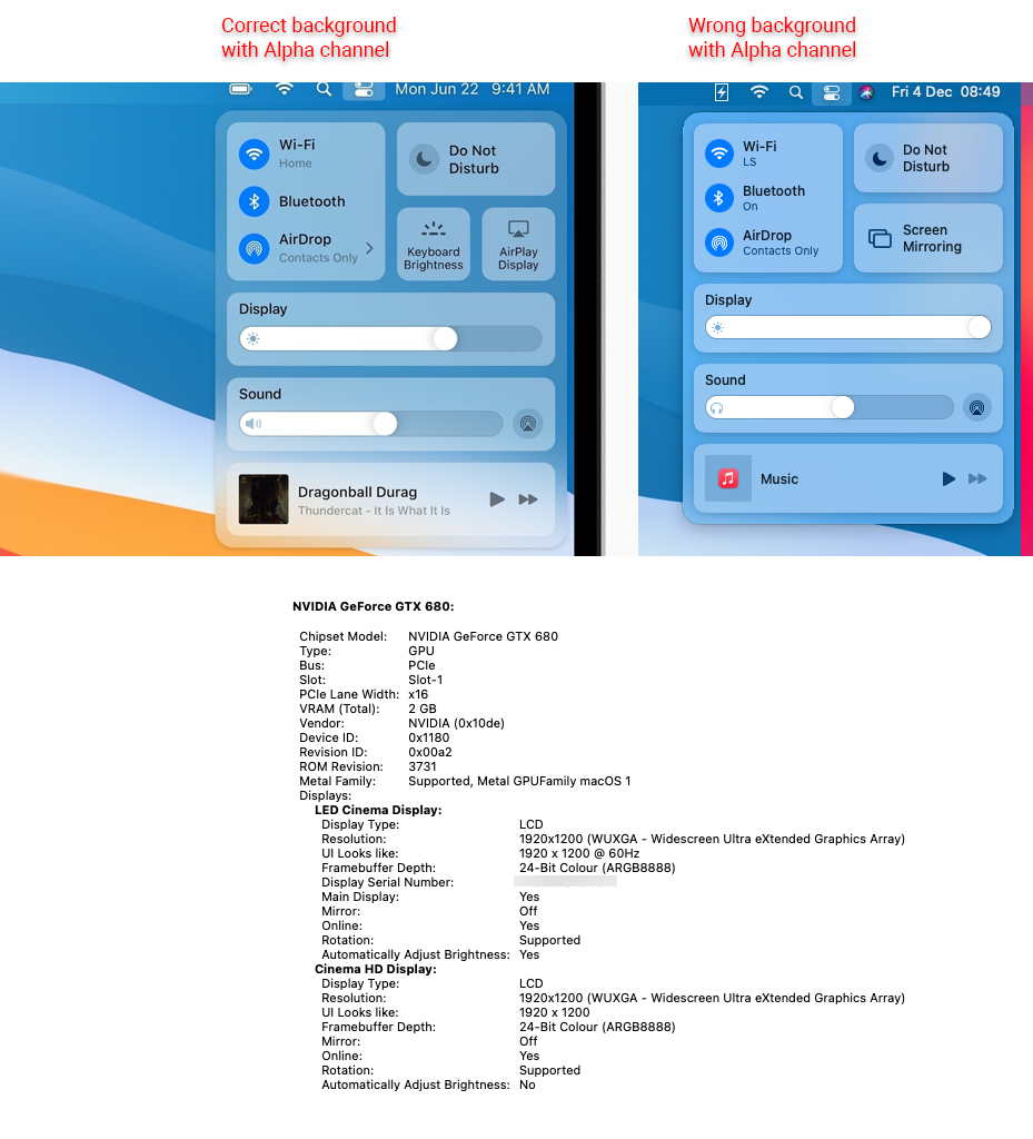

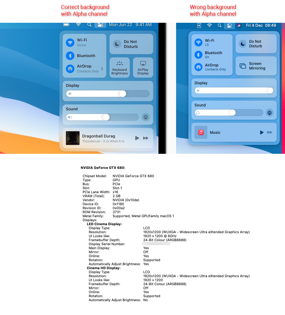

I have a similar problem on my Mac Pro 3,1 with NVIDIA GeForce GTX 680 Metal capable GPU.
On the left the correct background, on the right my wrong version.
There is a fix for this?
Thanks
as far as I can remember, there have always been some nvidia kepler driver bugs/glitches within MacOS for the last few years,
My experience is that they will slowly move away, after a few months and updates.
I also dont think Apple has a high priority of removing those bugs..

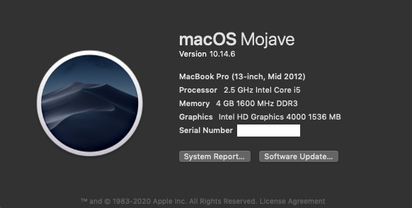

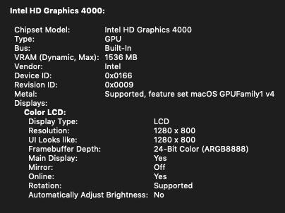

Ok, so I just recently scored a free 2012 MacBook Pro (specs below) and although I have used the @dosdude1 patcher several times on my 2009 MBP, I was wondering, what are the chances of getting a usable version of Big Sur running on this machine? How hard is the process and will it be worth it, do you think? I assume this system is Metal compatible so I was just wondering what everyone thinks. Thank you for any/all help!
Reactions: macinfo
Should be no problem at all . there are a few patchers available , depends on what you like I used BenSova version of Barrys patcher , it has a very easy GUI , very simple to do , , you can use the search function to find it or maybe the first page ,
I have a similar Mac but mine is a retina MBP of the mid 2012 vintage.
I used BKN's patcher and had no real problems.
I ran the patch-kexts on the first couple of installs to get the wifi working but then I upgraded the wifi to ac and don't have to run that now.

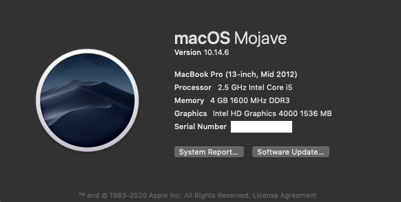

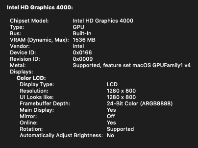

Does yours have the Nvidia graphics card as well as the Intel HD 4000?
No, it's just the Intel HD 4000
