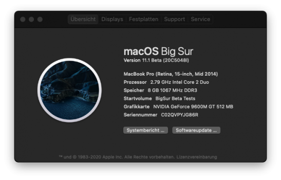

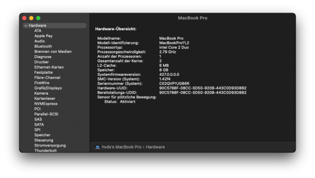

A further test with your OpenCore Legacy Patcher 0.0.3 (OC-L-P) on a MBP5,2:
- made a USB OC-L-P using the 1st link above, and also looked at the nicely written Python .command
- using a pre-existing USB installer made with createinstallmedia from 11.1 beta and jackluke's BS BaseSystem fix
- booted it with Apple boot selector and used it for a clean install on an erased partition on a USB SSD
- after stage1 booted into OC-L-P and from there into macOS installer to start stage2
- had to leave during the day, when back: country selection screen is up - no manual intervention since start of stage2
- finished setup, no further boot done, now writing from the freshly installed system.
As expected the MBP5,2 now shows as a MBP11,2. No internal audio yet also as expected, no night shift as expected, no WIFI yet but Ethernet is fine, rest all fine including USB mouse/keyboard.
Will now connect the USB disk to a supported MBP11,1 to see if it boots fine without OC. Will then apply patch-kexts.sh to get again my usual patches on disk, to be able to boot also without OC.
Installing BS on those old machines gets ever simpler. Thanks jackluke, khronokernel, BarryKN!

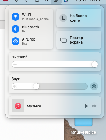

I have metal 1 support. And on Light theme looks fine. How I can't disable Nvidia graphic card?

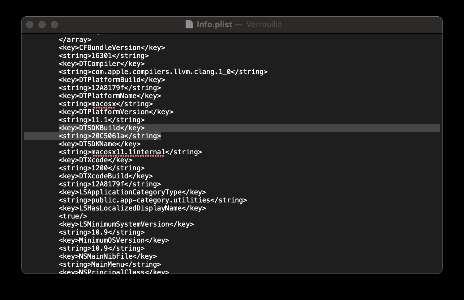

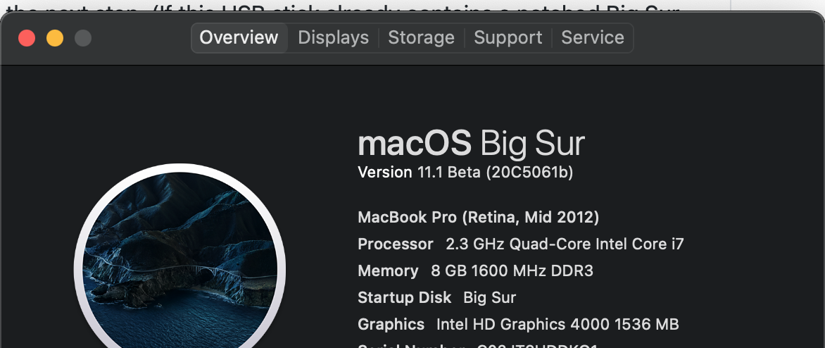

Thank you for the link! It's indeed version 16301, but, in the info.plist, I see that it is the DTSDKBuild 20C5061a version. The beta 2 is the 20C5061b. So there are not exactly the same. Maybe an internal pre-version?
EDIT : This is actually the beta 2 20C5061b version. Verified after installation.

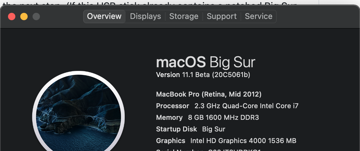

I downloaded and installed and unlike @vendini I got 20C5061b
Success also here on MBP5,2.
After download applied jackluke's BigSurSharedSupportfix.command to update the existing beta1 USB installer. Used the updated USB installer to install beta2 over beta1 on an external SSD, without using OC this time.

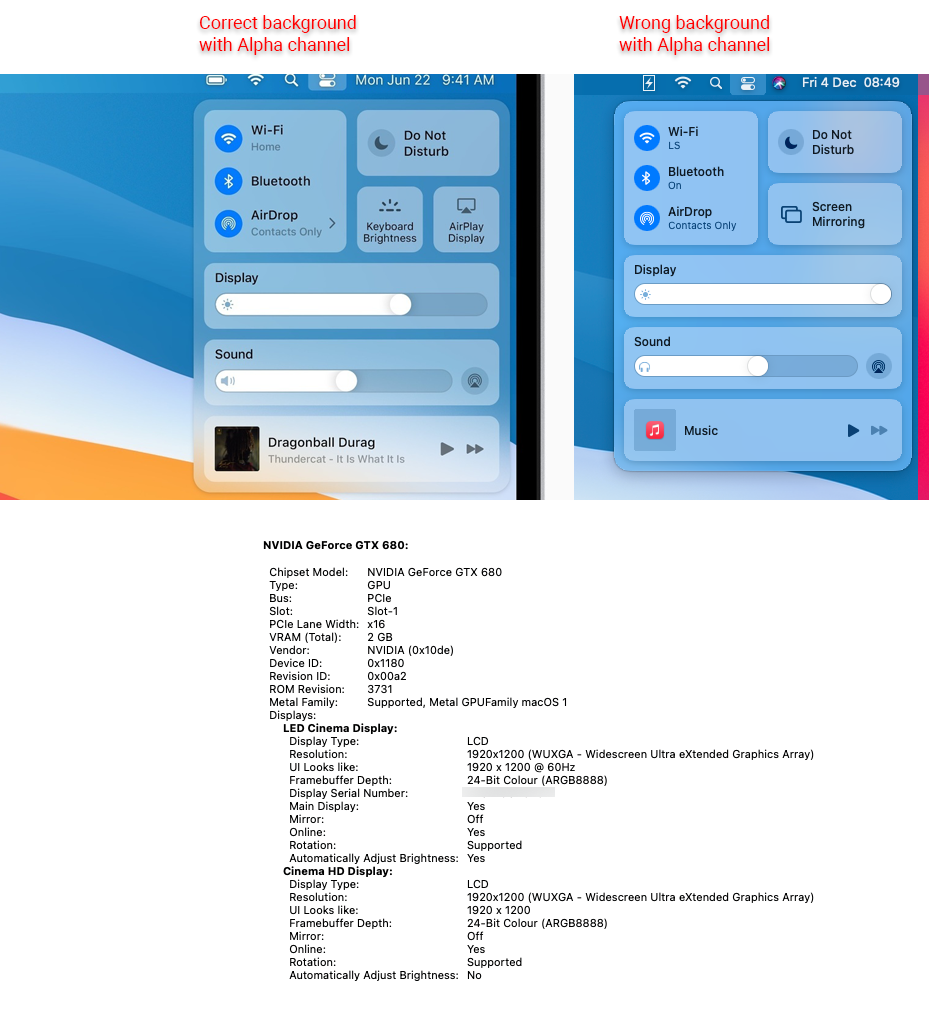

Hej, how to fix this ui problem?
I have a similar problem on my Mac Pro 3,1 with NVIDIA GeForce GTX 680 Metal capable GPU.
On the left the correct background, on the right my wrong version.
There is a fix for this?
Thanks

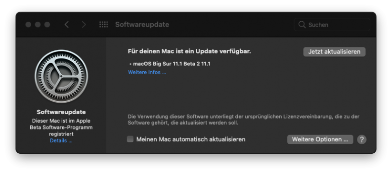

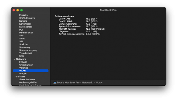

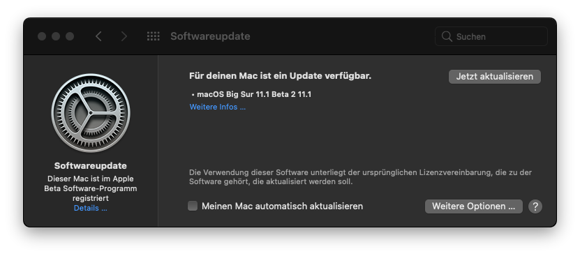

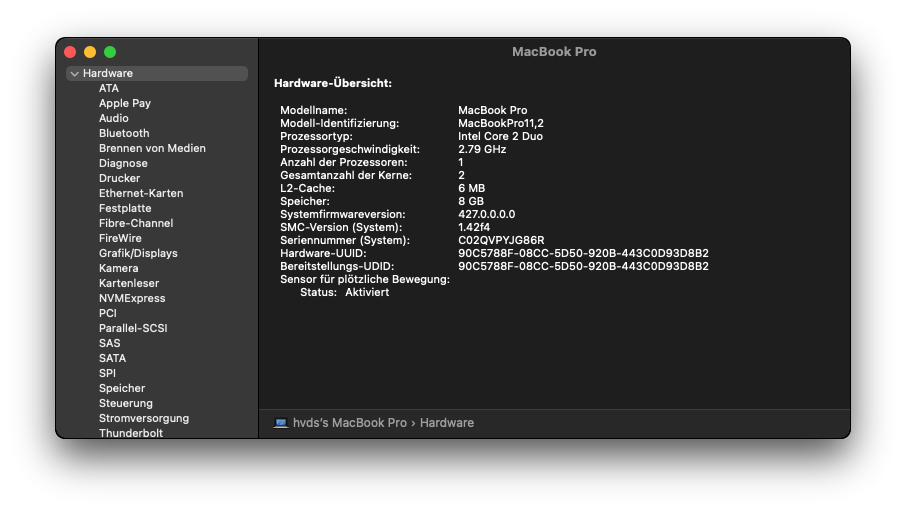

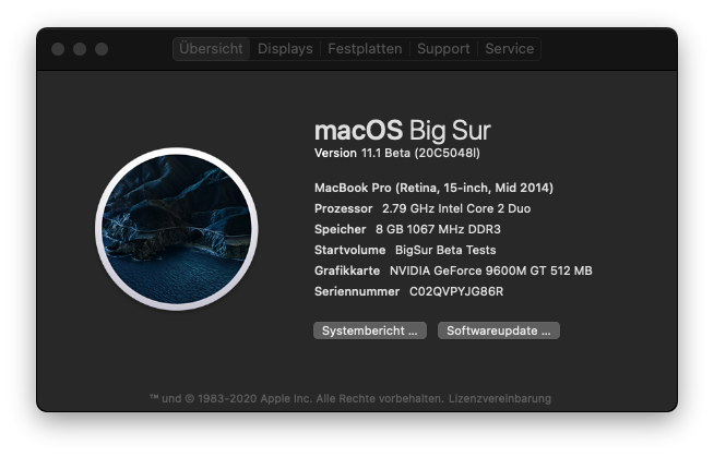

Just to add to this installation exercise on MBP5,2 using OC-L-P version 0.0.3:
- on a supported MBP11,1 the USB disk with 11.1 beta1 (prepared on my MBP5,2) boots and runs fine from the Apple boot selector
- booted the same disk again with OC-L-P on MBP5,2. It does recognise the beta2 in system settings > software update. I didn't proceed to install it yet (still a little fear of firmware updates).
No post-install kext patching has been done to this disk.

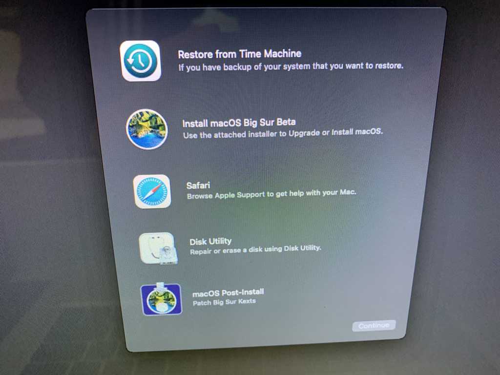

Guys, I have awesome news regarding @moosethegoose2213 and I's patcher. I have been obsessing about "patching basesystem" for months now. Well, it's finally been done. I can officially say that you can run the entire post-install process in macOS recovery, just like in dosdude1's patchers. This proved to be a very challenging endeavor, as macOS Big Sur has been very finicky about pretty much everything. Thanks to the help of @moosethegoose2213 , @Minh_Ton , and @jackluke , I have been able to do it. This patching method is kind of like a "DIY recovery" I like to call it where you take a created install media and you pretty much replace all the files in it. Thanks to @ASentientBot 's boot.efi and @jackluke 's prelinkedkernel, I am able to boot with our post-install application attached. Our application is a shell application, so no extra framework patching was necessary. If anyone would like to know how I patched the basesystem, feel free to DM me. Thanks again to @jackluke for all the help!
If you still don't believe that I have done it, here's a picture of my patched macOS recovery:
Current version: 11.1 Beta

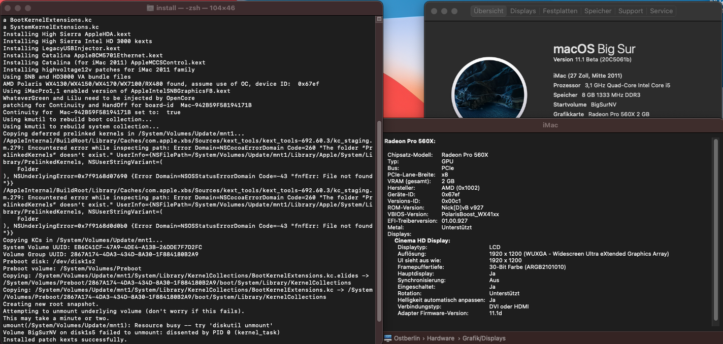

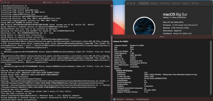

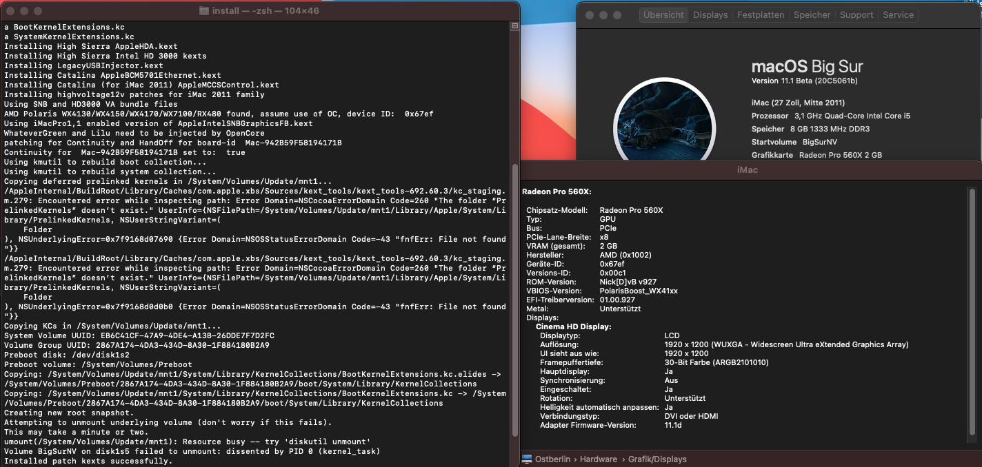

Short update:
iMac 12,2
AMD Metal GPU (EG BIOS offering EFI Boot screen)
Big Sur Beta 1,1 20C5061b
Reset PRAM in advance to avoid grey screen on language selection.
Boot the EFI partition of the prepared USB installer to avoid prohibited sign.
Installing and patching using this micro patcher edition successful.
Reactions: iMac-iPad and Dilli
