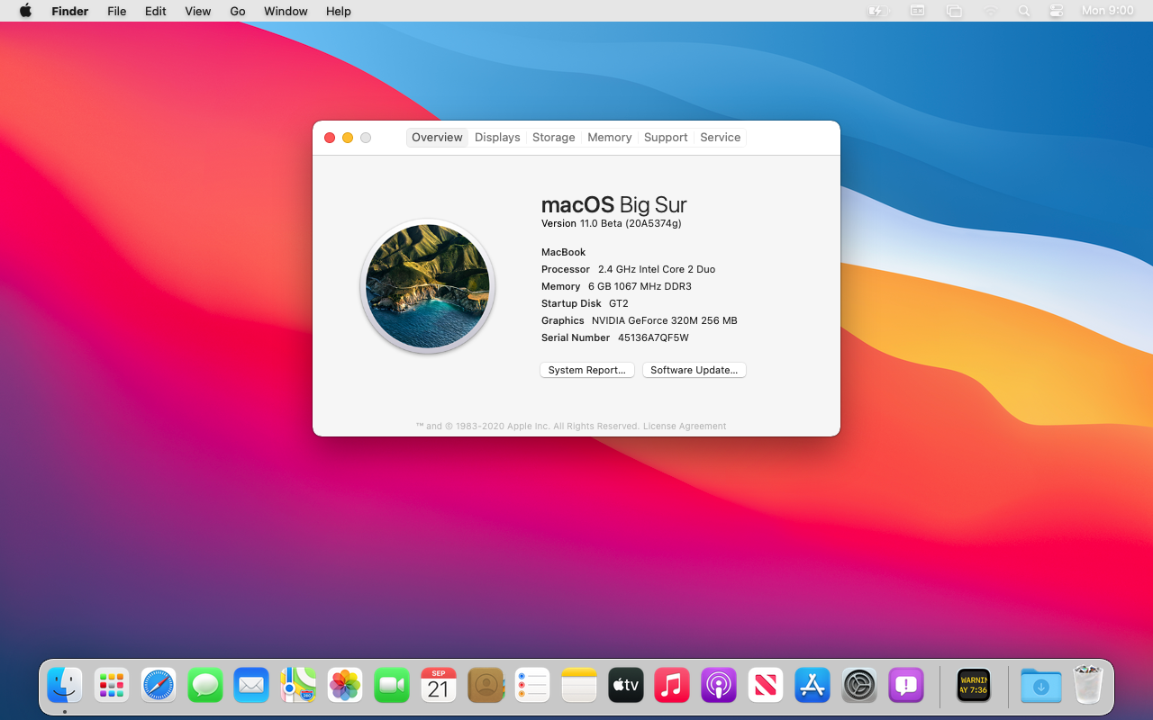

So, the good news is that I convinced DP7 to boot on a Core 2 Duo.
The bad news is that I did it by swapping in the DP6 kernel, and it wouldn't even reach single-user mode without that.
  • Every DP7 kext + the DP6 kernel = boots
  • Every DP6 kext + the DP7 kernel = hangs
I did multiple swaps and KC rebuilds to confirm this. So it's clear that the kernel is the culprit.
Whatever Apple's changed in the kernel completely breaks it on (presumably) Penryn systems. This is... not good.
