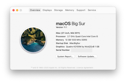

Hi,
A big thank you to @Barry K. Nathan, @jackluke, @ASentientBot, @highvoltage12v , @testheit, @parrotgeek1 and @Ausdauersportler. My iMac 2011 with nVidia K2100M patched with Barry's micropatcher to run Big Sur 11.1 with OpenCore 0.6.3 (I have not upgraded yet to 0.6.4). Clean installed Big Sur 11.1 on new APFS volume. Migrated from 11.0.1 - macOS Setup Assistant copied all my files across to my new install of Big Sur 11.1 in about 15 mins.
Worked on the second try. Messed up on the first try, when I ran the patch-kexts.sh script too early, before macOS Setup Assistant started. Thought I had to patch-kexts before macOS Setup Assistant starts. Patched-kexts was successful (with the --useOC option) but when rebooted it went into an endless boot-loop with black screen.
On the second try, I waited until I got into macOS Setup Assistant. At the point it completed the migration (copying my files across from Big Sur 11.0.1 install), it rebooted. That's when I held down the Option key to boot back into "Install macOS Big Sur" and ran patch-kexts.sh script (with --useOC). When completed, I shutdown and restarted by booting into OpenCore 0.6.3 then my Big Sur 11.1 volume. Worked like a charm!
On my desktop, there is a "Relocated Items.nosync" folder. https://www.macrumors.com/guide/relocated-items/

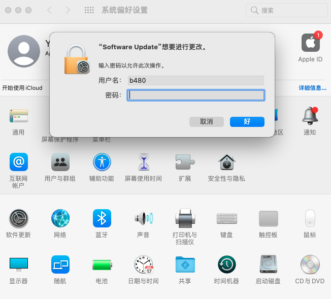

help ,this version seem has security issue;
after install Big Sur on a early 2011 mbp;
it always prompt this screen, click cancel won't work:
