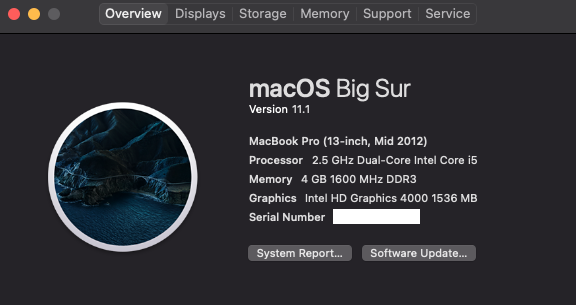

I am very very happy ... second update successful

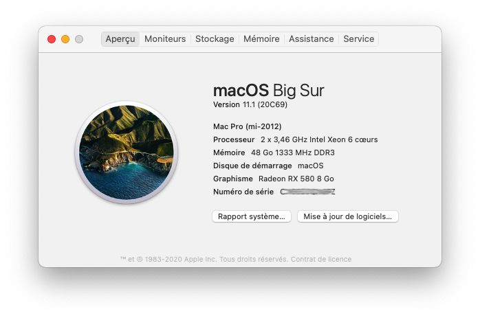

Hi all Update from BS 11.0.1 (20B50) to 11.1 (20C69) successfully performed on cMP5.1 since last night.
Full installer downloaded with MDS.
USB installer patched with Barry's Patcher 0.5.1 The installation went without any problems.
All of them work fine as with (20B50), Airport, Handoff, Sleep ...
Not yet had time to test everything but it looks promising ...

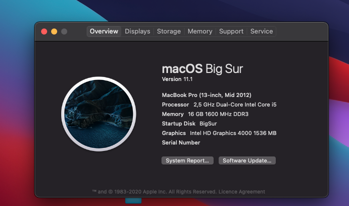

Yes yes I know perfectly it is already the third installation I do on my Macbook Pro.
I have always found myself very very well ...
I have already done the backup with Carbon Copy Cloner as well.
I would like to try tonight with the hope of not doing any damage.
