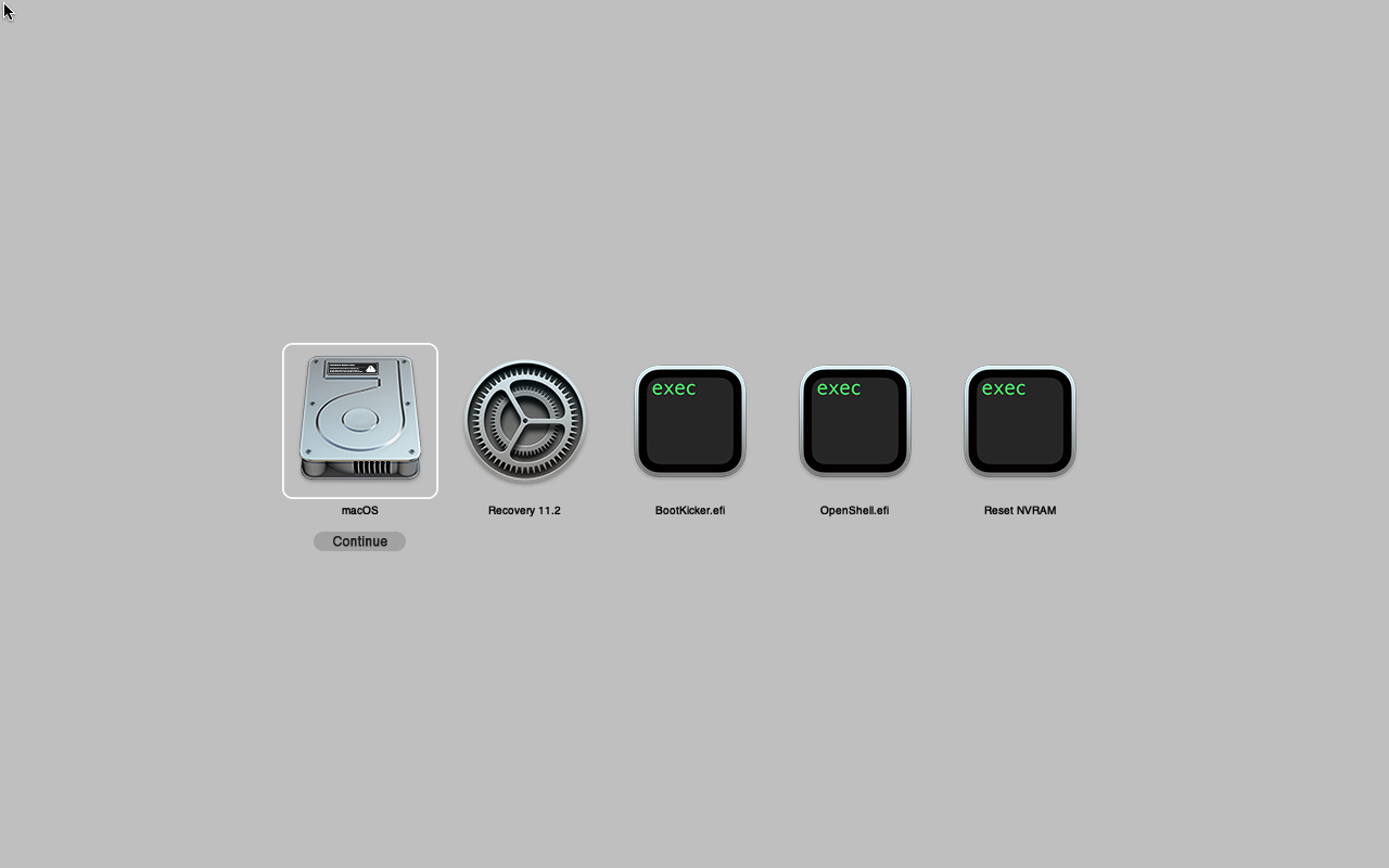

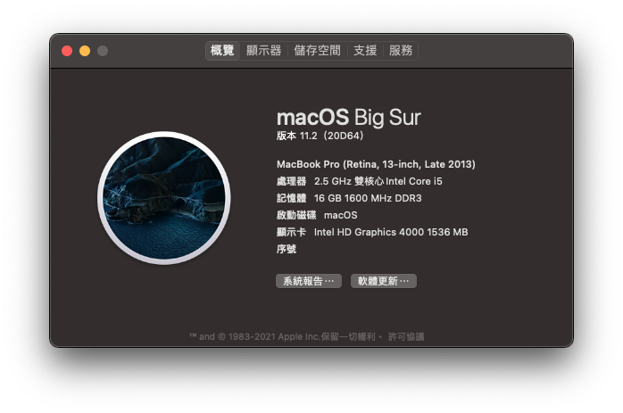

OpenCore is great when setup and the OTA updates work. The only problem is, the OTA updates were causing a bunch of problems for some users (macs not booting requiring battery removal or iMac efi flash). I'm not sure where this is currently.
Yeah bricking my MBP9,2 it's one of the concerns that I see OPL like a dark forest yet. Maybe in a few updates...
I'm so overwhelmedhow this machine runs through BS compared to Catalina, that I'm afraid of messed up.
I will stick with micro once more time.
As far I can see, the update goes smooth from 11.1 to 11.2.
Thanks to all.
@ClassicII - the black screen problem is (I believe!) fixed now, by a patch to OC specially for this which the OCLP developers provided. Multiple people (including me, when I'm not fiddling around with the settings!) are reporting that the fix works.
Disadvantage: One which I don't like, OCLP fakes all your system ids. While this is required for non-Apple hardware (which, obviously, OC can support!), it is not required on Apple hardware: it is possible to configure OC to detect and use all your original system ids and serials. (This is relevant to just continuing as the same machine, as far as Apple products (iCloud, iMessage, FaceTime) are concerned, and similarly for Windows registration, if you have e.g. Bootcamp on your hardware.) I don't know the status of this in the micropatcher (I haven't used it), but I would guess it does not fake your system id or machine serials? (Anyone?)
micropatcher not fake system id or machine serials.
OCLP only one config.plist line needed to work with OpenCore 0.6.6
the black screen still exists, but it does not lock anymore, it is now turned off only, so you can turn on the device and continue with the update.
at least that was it for me.

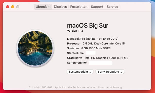

Used Patched Sur by @BenSova again to install 11.2 and it is working fine on my MacBook Pro Retina from late 2012.
I am honestly surprised Apple did not bother to change anything in those 3 updates since BigSur was released and that a patcher last updated in November still works fine but it does :)
Only need to run patch-kexts.sh in terminal to get wifi working permanently. that's it

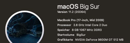

Updated MBP5,2 to 11.2 (20D64).
Using the full installer downloaded with MDT and put in /Applications. Then using @jackluke 's BigSurSharedSupportfix.command to update my existing USB installer to 11.2.
Using this USB installer to install 11.2 over 11.1 on an external USB SSD. This time used USB2/USB3 swaps to continue stage2 and stage3 while legacy USB not yet in place (could use stage2+3 fix instead). Then booted into the USB installer again and applied Legacy USB and graphics framebuffer fixes from jackluke's utilities pulldown menu.
Resulting BS booting and running fine.
No graphics acceleration of course with the non-Metal GPU.
So jackluke's BigSurBaseSystemFix (option 3 of 1st post) still works well for 11.2. THANKS!

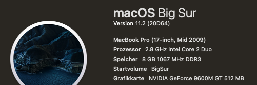

Resulting BS booting and running fine. No graphics acceleration of course with the non-Metal GPU.
