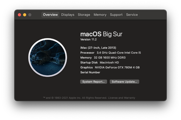

Using micro patcher on the released 11.2 did a successful upgrade from 11.1 on my late iMac 2013.. Now, if we get OTA to work, then it'd be great. OpenCore seems way over my head atm to understand

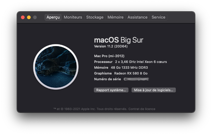

Hi all,
macOS Big Sur 11.2 (20D64) successfully installed on cMP5,1 with micropatcher 0.5.1 (clean install then data migration from 11.1)
Everything seems to work fine

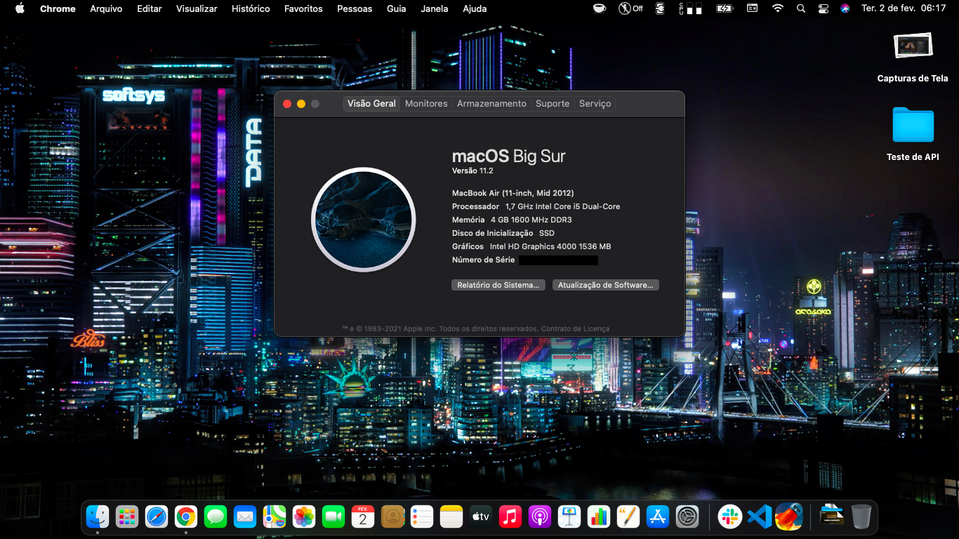

Just updated OTA to 11.2 (20D64) from OpenCore 0.6.6 on my MacBook Air (11-inch, Mid 2012)
Wi-Fi 802.11ac (new Air 2013-2017)
No bugs, no freeze, working perflect.
