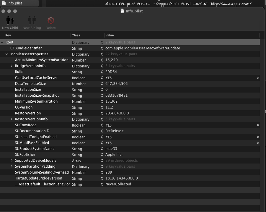

I didn't install it yet, I ran the .pkg, nest I navigated to shared support in the installer, unzipped the 12 GB zip file, then opened info.plist, it says 12.2 as I showed in my earlier post.
I don't know what the other linked file from his site is, it is an pkg installer, 12.2 GB.
I just did a google search of the other link (the one listed on mrmacintosh.com) and turns out that one is actually 11.1, not 11.2
http://swcdn.apple.com/content/down...66rj040ekzry97wx2hggfuse/InstallAssistant.pkg

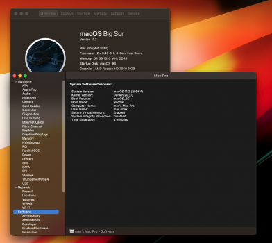

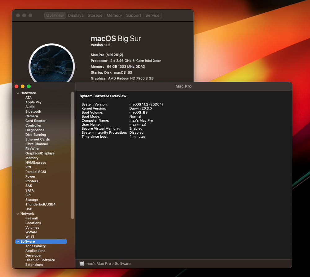

cMP mid 2012 successfully installed BS 11.2 (20D64) 12.21 GB with Barry 0.5.1.
If your cMP GPU and BT/WiFi card updated. After boot from USB installer, open Terminal (in the Utilities menu) then run without quote "/Volumes/Image\ Volume/set-vars.sh" and install the BS as normal.
Just be aware that the object for this install-setvars.sh Terminal command is simply to run it in Terminal (duh!). The stuff before /install-setvars.sh will vary depending upon where you stored the micropatcher folder.
Also, some of us use BarryKN's various options at this step. I use -e to set SIP, etc. Others shouldn't.
