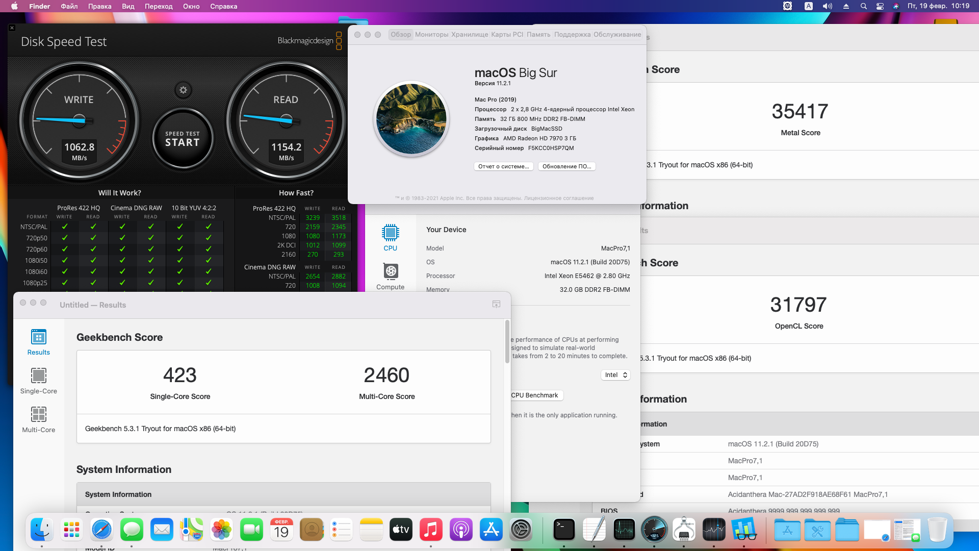

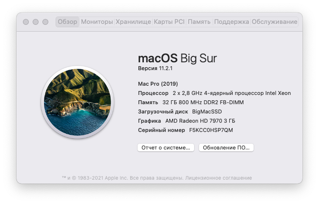

Hi guys! I installed macOS Big Sur 11.2.1 on both my Mac Pro-2008 and 2009. On Mac Pro 4.1 (Flashed 5.1) installed 11.2 via micropatcher, and then via OCLP installed 11.2.1 via OTA Updates. I also did a clean install of 11.2.1 via OCLP when migrating to another SSD. On Mac Pro 3.1, I installed 11.2.1 via OCLP, and then via BigMac-Master on a PCI-AHCI SSD. I also did a clean install of 11.3 Beta via BigMac-Master on a SATA SSD
View attachment 1733370View attachment 1733368

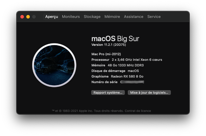

Hi all
I can confirm that I have successfully installed 11.2.1 with Barry's micropatcher 0.5.1 since 5 days and all is working well.

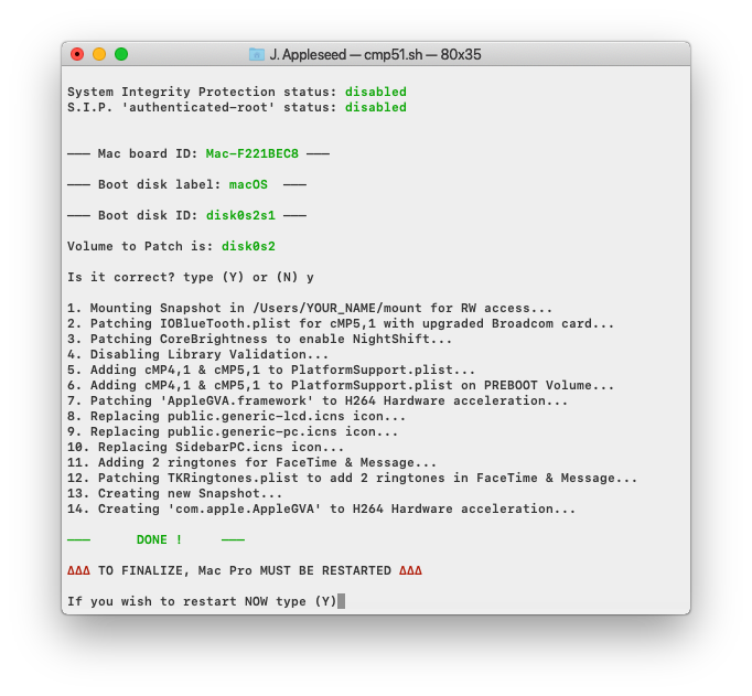

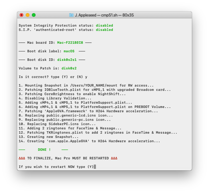

I also wrote a script to automate some tasks:
To check if SIP is disabled
To mount snapshot to RW access
To replace "CoreBrightness.framework" (thanks @jackluke) to get functional NightShift,
To disable Library Validation
To add cMP5,1 board ID with PlistBuddy in "SystemParameters.plist" into "IOBluetooth.framework" to get Continuity
To add cMP5,1 board ID with PlistBuddy in "Info.plist" into "AppleGVA.framework" to enable H264 Hardware acceleration
To create "com.apple.AppleGVA" to enable H264 Hardware acceleration
To add cMP5,1 board ID with PlistBuddy in "/S/L/CoreService/PlatformSupport.plist"
To add cMP5,1 board ID with PlistBuddy in "PlatformSupport.plist" on PREBOOT Volume
To copy 2 ringtones for Message & FaceTime in "/S/L/PrivateFrameworks/ToneLibrary.framework/Versions/A/Resources/Ringtones/"
To add 2 ringtones for Message & FaceTime with PlistBuddy in "TKRingtones.plist" into "ToneKit.framework"
To create a new snapshot
To restart automatically after executing all these tasks

Hi @Ausdauersportler
I didn't add my script to my last message because it was still just a draft and in this script I replace 3 custom icons in CoreTypes.bundle (public.generic-lcd.icns, public.generic-pc.icns and SidebarPC.icns) and I add 2 custom ringtones for FaceTime.app and Message, which I think nobody is interested by this.
But here are the 2 parts of my script about H.264 acceleration
$BOARD_ID and $MOUNT were set at the beginning of the script like this:
Code:
MOUNT="$HOME/mount_dir"
BOARD_ID=`/usr/sbin/ioreg -l | grep board-id | awk -F\" '{ print $4 }' | grep Mac`
Part#1
Code:
echo "7. Patching 'AppleGVA.framework' to H.264 Hardware acceleration..."
sudo /usr/libexec/PlistBuddy -c "Add :System\ Support:$BOARD_ID:allowFrameReordering bool false" "$MOUNT/System/Library/PrivateFrameworks/AppleGVA.framework/Versions/A/Resources/Info.plist"
sudo /usr/libexec/PlistBuddy -c "Add :System\ Support:$BOARD_ID:hwe bool true" "$MOUNT/System/Library/PrivateFrameworks/AppleGVA.framework/Versions/A/Resources/Info.plist"
sudo /usr/libexec/PlistBuddy -c "Add :System\ Support:$BOARD_ID:hwe420 bool true" "$MOUNT/System/Library/PrivateFrameworks/AppleGVA.framework/Versions/A/Resources/Info.plist"
sudo /usr/libexec/PlistBuddy -c "Add :System\ Support:$BOARD_ID:interlacedOff bool true" "$MOUNT/System/Library/PrivateFrameworks/AppleGVA.framework/Versions/A/Resources/Info.plist"
sudo /usr/libexec/PlistBuddy -c "Add :System\ Support:$BOARD_ID:ke1 bool true" "$MOUNT/System/Library/PrivateFrameworks/AppleGVA.framework/Versions/A/Resources/Info.plist"
sudo /usr/libexec/PlistBuddy -c "Add :System\ Support:$BOARD_ID:pp integer 1" "$MOUNT/System/Library/PrivateFrameworks/AppleGVA.framework/Versions/A/Resources/Info.plist"
Part#2
Code:
echo "14. Creating 'com.apple.AppleGVA' to H.264 Hardware acceleration..."
defaults write com.apple.AppleGVA gvaForceAMDKE -bool YES
defaults write com.apple.AppleGVA gvaForceAMDAVCEncode -bool YES
defaults write com.apple.AppleGVA gvaForceAMDAVCDecode -bool YES
defaults write com.apple.AppleGVA gvaForceAMDHEVCDecode -bool YES
If you want the full script to add it to the micropatcher, I'd be happy to share it, just tell me and I'll remove the parts adding ringtones and replacing icons.

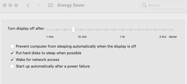

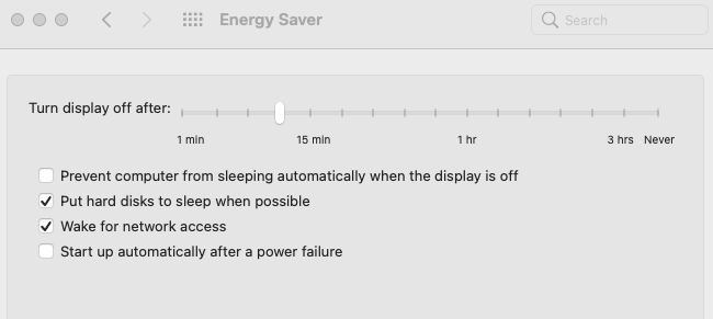

I'm running 11.2.1 on my cMP5,1 via OC v0.6.6 and was wondering if there's no more separate slider for computer sleep in Energy Saver preferences?
I'm on 11.3 Beta 2 and OC 0.6.3 and I am seeing the same selections you are seeing under Energy Saver on my cMP.
Thanks. I guess it's fine. Just wanted to make sure nothing was incorrectly set within OC. Everything else works fine. Computer sleeps and adjusting that one slider does change timeout as reported with pmset -g.
