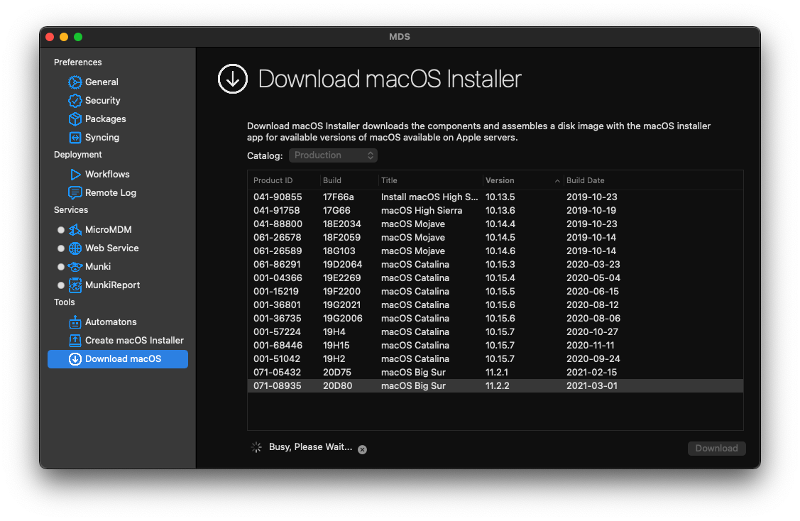

[Hint: Google search for "gibMacOS.command", exactly, including the quotes ""
So! Download the file "Download ZIP" from the green "CODE" button.
Extract the archive and run gibMacOS.command with Terminal]
You will have a pleasant surprise and I think you will thank me; indeed, I think you will thank me in many... 😉
Apple does not immediately integrate the App Store version with patches, but it always does some time after an "Additional Update" or "Security Update".

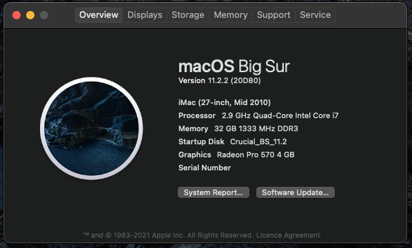

I preferred to install Big Sur from a clean installation, on an external 2TB SSD which I then inserted in place of the Fusion Drive Hard Disk. Big Sur practically makes my iMac fly like never before and thinks that even while spinning from the external drive it worked much better than Catalina...
I ve solved my Problem:
Rebooted my iMac in SafeMode and then Started the Update from there.
Everything worked fine

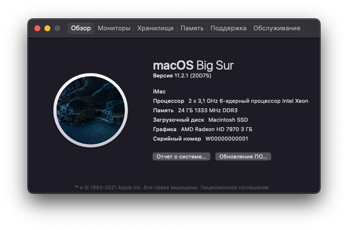

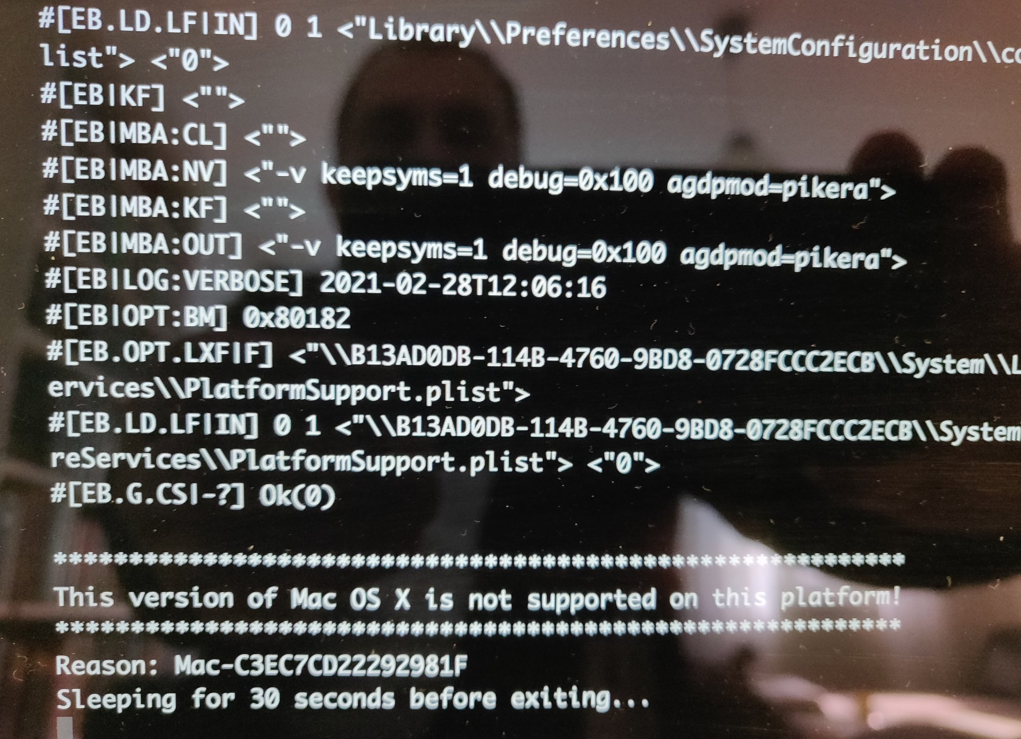

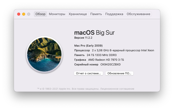

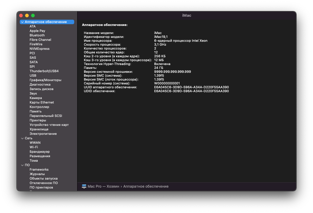

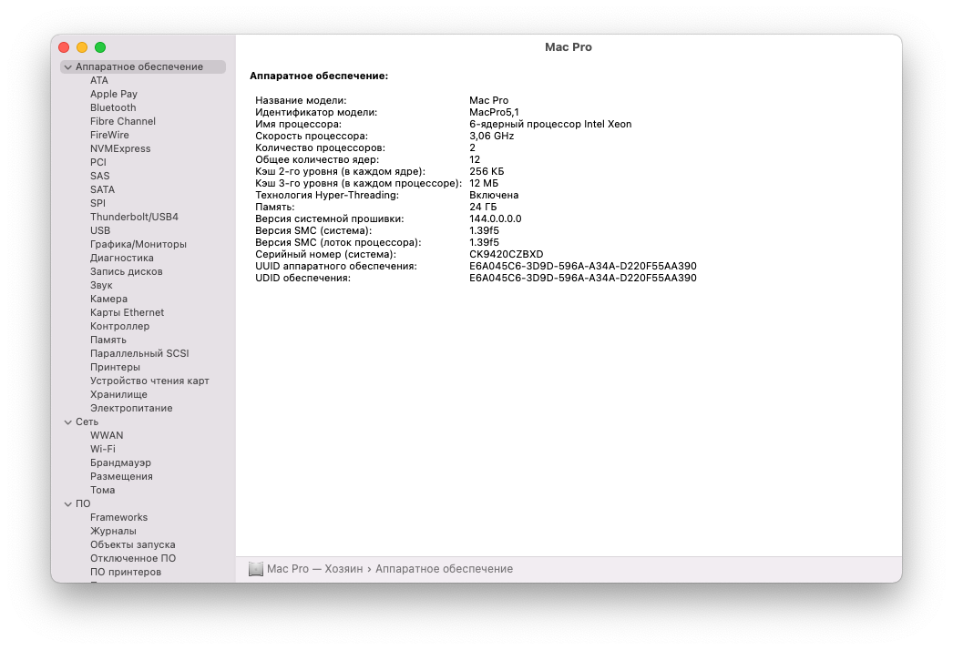

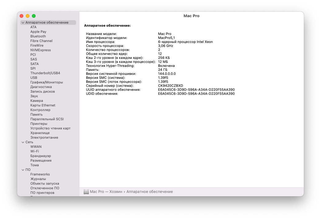

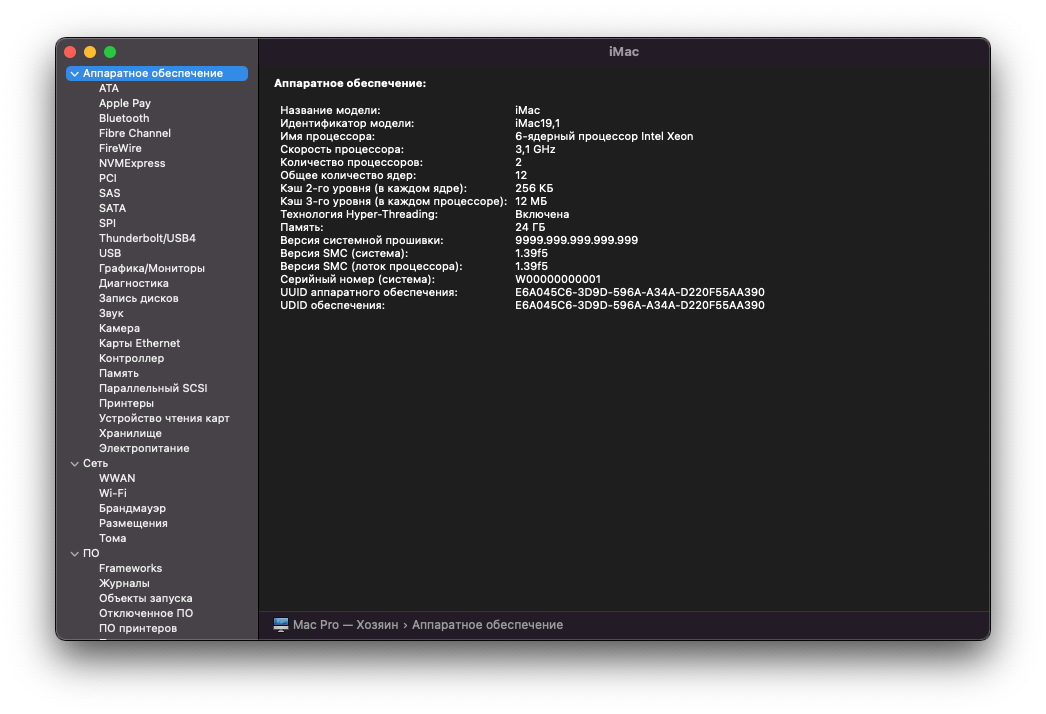

Since Christmas 2020 I am experimenting with OpenCore to (OTA) update Big Sur - while the discussion about the danger of getting unwanted firmware upgrades reached it's peak.
After Apple released the installers (11.2.1 and 11.3 Beta 2) which cannot be installed with the current micropatcher (so the first part is broken) I came to a personal conclusion that we should move away from the HAX libs on to using OpenCore as a technology base to install and boot Big Sur using @jackluke type of spoofing:
Code:
PlatformInfo->Generic->SystemProductName (i.e. iMacPro1,1)
PlatformInfo->Generic->MaxBIOSVersion (true)
PlatformInfo->Automatic (true)
OCLP is similar approach using currently a more complex spoofing well known form the Hackintosh world. This will likely change. While OCLP does not give us right now full functionality as reached with the micropatcher part 2 (the patch-kext.sh script) we could move on to use a hybrid approach:
  1. use OpenCore to install, boot and OTA upgrade
  2. use micropatcher patch-kext.sh to patch Big Sur to achieve maximum compability unless OLCP overtakes
This hybrid approach has several advantages but also a downside.
Advantages:
  1. OpenCore allows cross macOS installation of Big Sur. I was able to start the Apple macOS Big Sur installer from High Sierra, Mojave, Catalina and Big Sur to do a full installation. There will be no need to have a patch app.
  2. OpenCore allows OTA full (in every case) and OTA delta upgrades unless you modify the system through patching with patch-kext.sh. This allows at any time to install an arbitrary full Big Sur installer, apply all available OTA upgrades and patch then the system finally. This process can be repeated. (APFS snapshots can help here, too).
  3. OpenCore allows in some cases (nearly) full functionality without patching. Last week I created an iMac 12,2 Catalina configuration which offers everything except sound - you can us a BT sound cube to get around this.
  4. OpenCore can be used to install and maintain Mojave and Catalina, too. It is not limited to Big Sur.
Downside:
  1. Using the patch-kext.sh (aka patching Big Sur) breaks the OTA delta upgrades - these are the smaller upgrades Apple delivers now from time to time instead publishing a full installer, the latest 11.2.2 is an example.
To get forward I changed the iMac micropatcher dev-v0.5.5 to include this @jackluke type of spoofing and OpenCore 0.6.6. The development and testing has not been completed. In the next step I would like separate the script patch-kext.sh and all it's resources from the USB to have a simple patch command available at any time after an (OTA) upgrade in the Applications folder.

Done, but I will not update the list any longer, please use this tool to get macOS updates in future. Has been posted here several times, the latest download link, too. There is a search button where you can search the thread ....
Reactions: olad
Are you sure is updated?
i'm trying to click over the url's and doesn't work.
One more think, about the tool, there is a readme or guide how to use it?
(what parameter send, how, etc )
Best regards
Another smooth sailing from 11.2.1 to 11.2.2 through Software Update.
Everything works well, including Apple TV+ DRM.

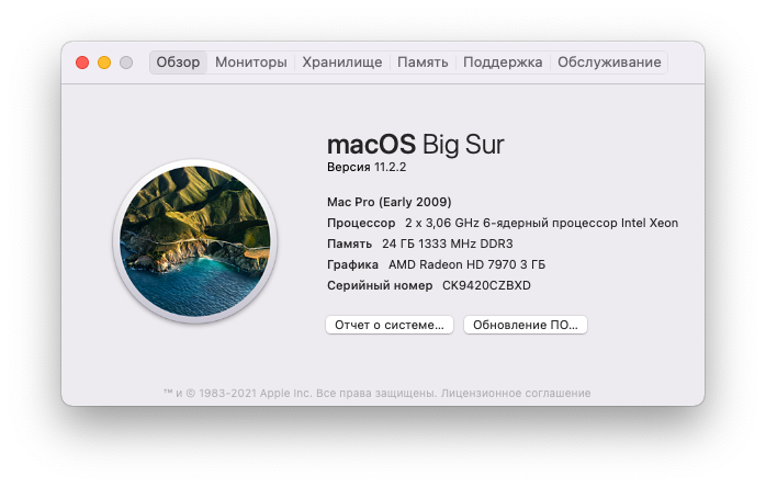

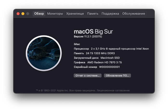

Update my system on Mac Pro 4.1 (flashed to 5.1) from 11.2.1 to 11.2.2 via OCLP test release.
View attachment 1735442View attachment 1735443
All work fine, but i move back to native EFI loader after update.
Without changes in system.
View attachment 1735444View attachment 1735445
