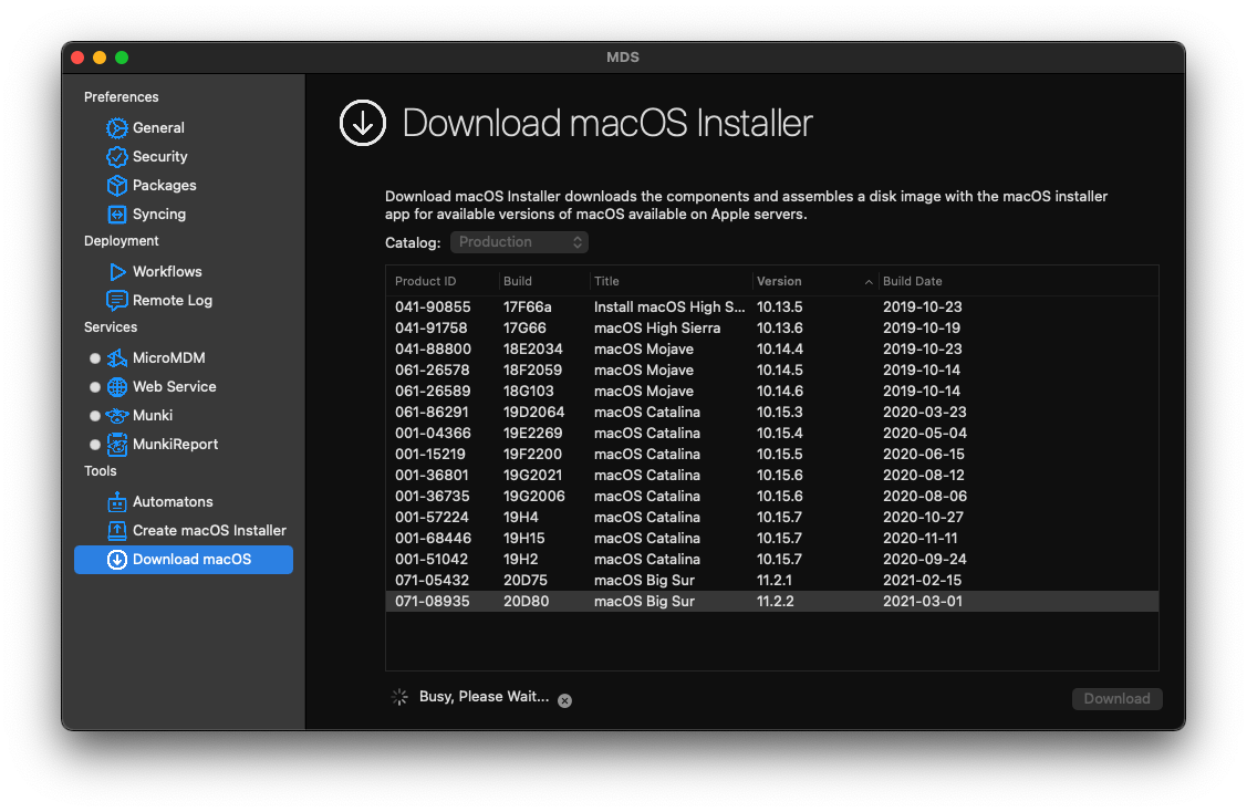

Hi may i know how to use this MDS ? Thanks
Hi @David dongfox
It's very simple to use, you will find MDS at this link: https://twocanoes.com/products/mac/mac-deploy-stick/
Launch MDS, select "Download macOS" at the bottom of the left column. Wait a few seconds for MDS to search for all OS versions to download. Select the one you want from the list that appears. Click on the "Download" button at the very bottom right of the MDS window. Then select the location to save the download to (on the desktop for example).
Waiting for long minutes...
When the download is finished, just mount the obtained .dmg and go to the "Application" folder (contained in this .dmg ), at this location you will find "Install macOS Big Sur.app".
Personally I move "Install macOS Big Sur.app" to the "Application" folder of my system and I run the following command in Terminal to create my USB stick:
Code:
sudo /Applications/Install macOS\ Big\ Sur.app/Content/Resources/createinstallmedia --volume
I type a space and I Drag and drop USB stick volume from Desktop at the end of this previous command line

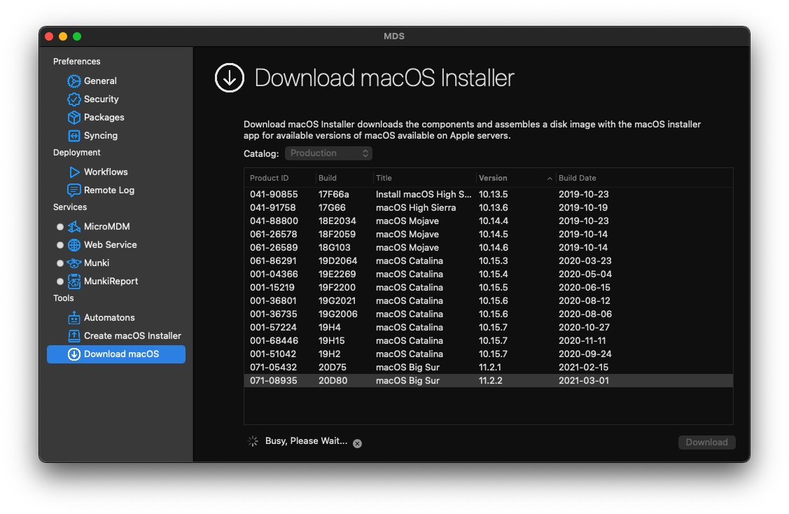

Hi @David dongfox
Code:

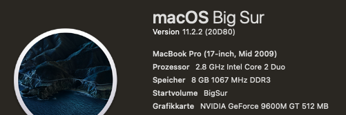

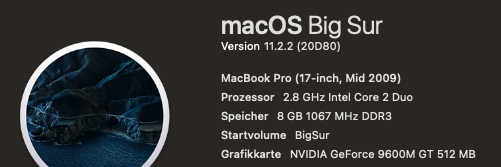

MBP5,2 now running 11.2.1 on external SSD. Installed it over 11.3 beta.
So meanwhile jackluke's BigSurBasesystem Fix method (post 1, option 3) was successful for
- 11.1 betas and release
- 11.2 release
- 11.3 beta
- 11.2.1 release
i.e. whenever a full installer was available.
I always used the same USB BS Installer prepared as in post #7069 (or also see #8686). Just updated it to the next BS version by replacing SharedSupport.dmg, using BigSurSharedSupportfix.command.
Excellent work, jackluke.
(as always a word of caution: no graphics acceleration available on such hardware under BS.)
Tried the same procedure now with 11.2.2.
No success yet, reboots rather early in phase2 of installation. Will test further.
Edit: installed again from same BS USB installer, worked this time. MBP5,2 now on 11.2.2.
(The only change was replacement of HaxLib.dylib on the USB installer as per ASentientBot's post #8950; but this was unnecessary and not the problem.)
