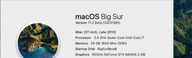

Reporting successful installation of Big Sur 11.3-beta-3 on 2012 iMac 13,2 with 27" screen, i7 at 3.4 GHz CPU and
1 TB fusion drive. Previous system was 11.2.2.
Method used: @Barry K. Nathan micro patcher 0.5.1 - see page 351 post# 8767 for installation details and cross-references. All functionality is present (including internal speakers), and there is no discernible performance penalty for using fusion drive, when comparing with other OS X variants (installed on same drive).

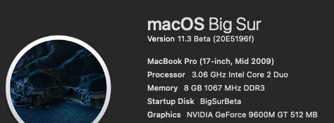

Another successful installation of 11.3-beta-3 on 2009 MacBook Pro 5,2 with 17", C2D at 3.06 GHz, 1TB Samsung SSD. Previous system was 11.2.2
Method used: BigSurFixes by @jackluke and @ASentientBot's Hax3lib - see page 351 post# 8767 for installation details.
All functionality expected for that model is present. There is, however, no GPU acceleration (a known issue).
