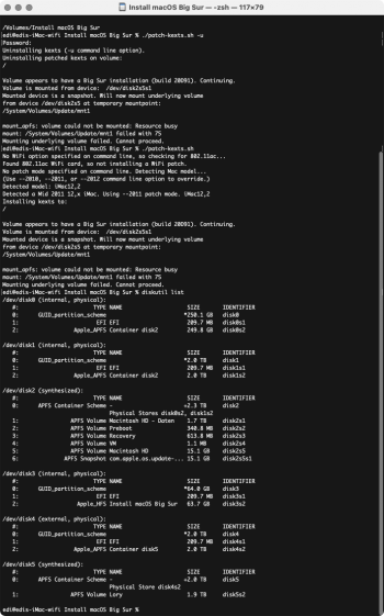

since 11.2.2 OTA on my iMac12,2 (see sig) I have problems with sleep: its going to sleep but never wakes up. black screen and slowly running fans. nothing reacts to wake it up. any ideas? tried 0.5.5 from @Ausdauersportler but no luck. back to "main" branch. have to kill the machine with power button
some help would be nice, can offer a bunch of logs on EFI partition
Have you patched the iMac after OTA upgrade, again?
Sorry, but I do not need logs, I need to know what you have done exactly to achieve this situation.
Reactions: xanderon
yeah I patched after ota.
2011 iMac, sleep problem:
You messed up the installation of extension and the usage of opencore. Either use --nikey22 and stay without OC and do not use this flag and use opencore. You cannot have both.
I asked for what you did and not what you have!
don't know what you mean. I didn't use --nikey22. I used install-opencore and after installation patched + config-opencore. installed OTA update(s) and repatched with --2011 because I already had iMac Pro spoofing active
[icode--2011[/icode] was a mistake, unpatch using -u, reboot and use [icode--model=iMac12[/icode]

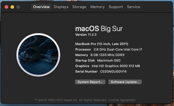

Installed macOS Big Sur on my Late 2011 13" MacBook Pro using the micropatcher. Everything works fine but I've noticed battery life with Big Sur and even Catalina on these Macs is horrendous.

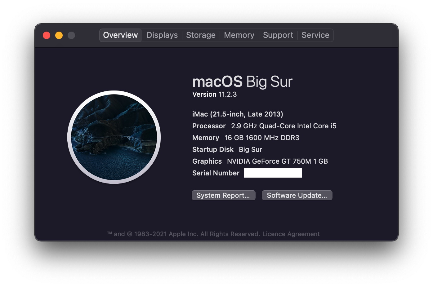

Updated my mbp9,2 OTA from 11.2.2 to 11.2.3 with no problem using OCLP 0.0.13.

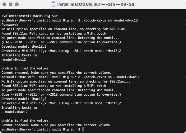

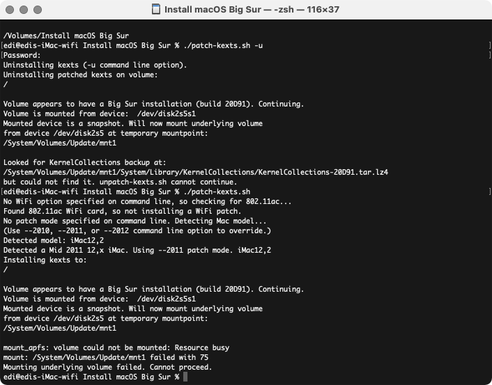

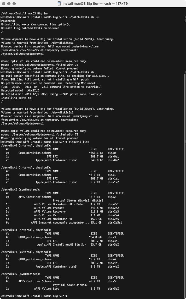

—2011 was a mistake, unpatch using -u, reboot and use —model=iMac12
See my screenshot. I took that AFTER OTA Update to 11.2.3.
- tried to unpatch, not working. ok…
- tried to "re"patch, not working. AND the patcher itself shows me to use --2011 . that's the reason why I used it in the first place. and on your github page its --2011 everywhere.
now what? how to undo every patch / OC / whatever influence to vanilla so I can redo the correct way?!
is it -- - or or is the forum software here changing the lines from -- to
